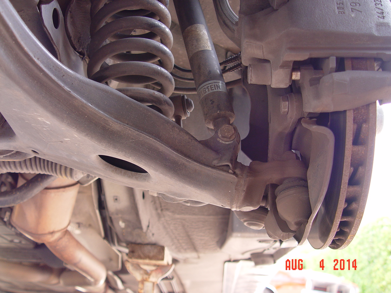

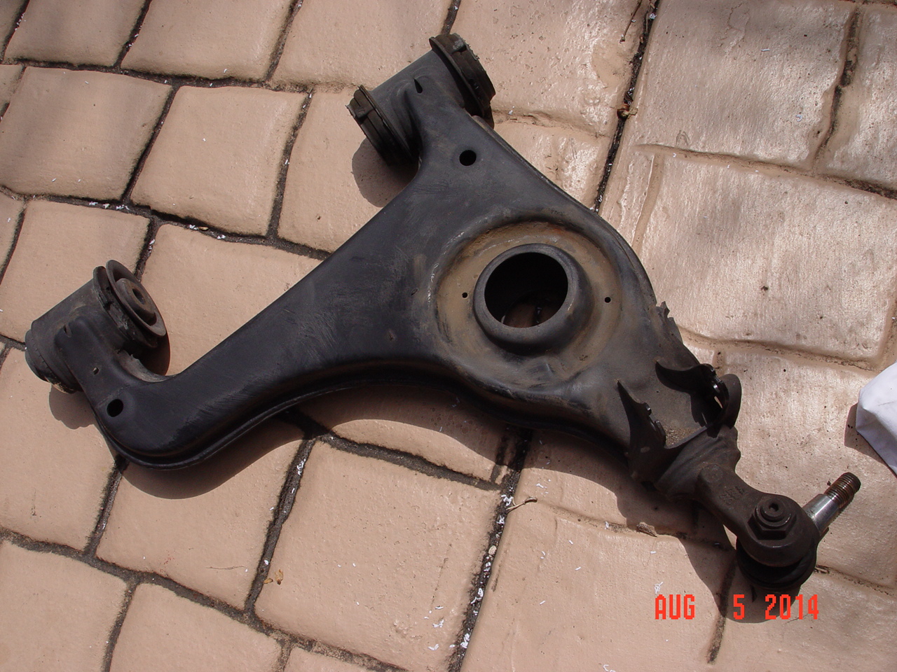

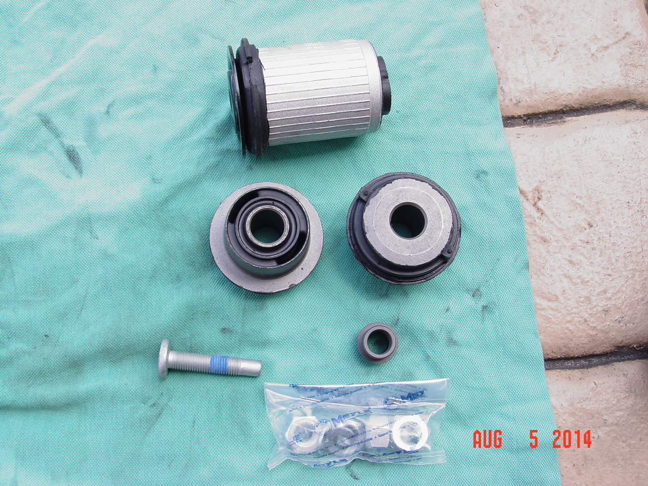

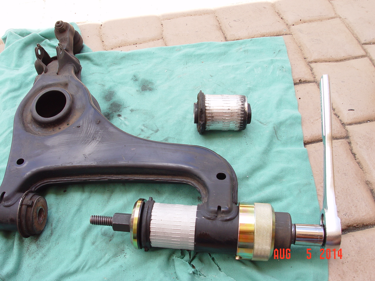

Attached Thumbnails Check your control arms!-dsc08767.jpg   Check your control arms!-dsc08849.jpg   Check your control arms!-dsc08869.jpg   Check your control arms!-dsc08861.jpg   Check your control arms!-dsc08863.jpg

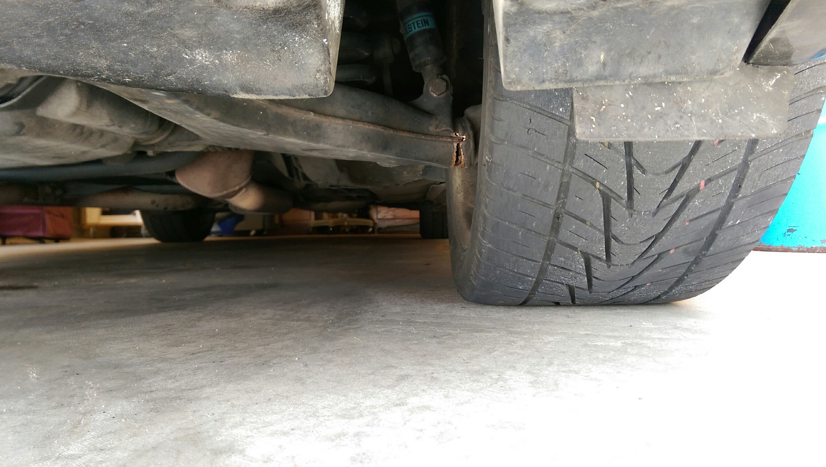

Here is mine, replacing driver's side tonight. Also what it was doing to the tire. I was hearing a thump or slap of the tire around 15-20 mph. At highway speeds didn't hear it much. The tire wear led me to look for the out-of-camber look as well. New ball and control arm online for $86 shipped. Parts look real good to this weekend mechanic.
