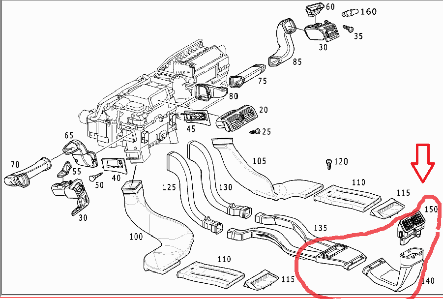

5) Does anyone face the issue where the rear A/C vents are next to useless and hardly blow any cold air, at all? Or is that by design?

Regarding the rear vents, the flaps might not be operating correctly. Or the vent channel could be disconnected. I remember reading somewhere about a Flap-test.
