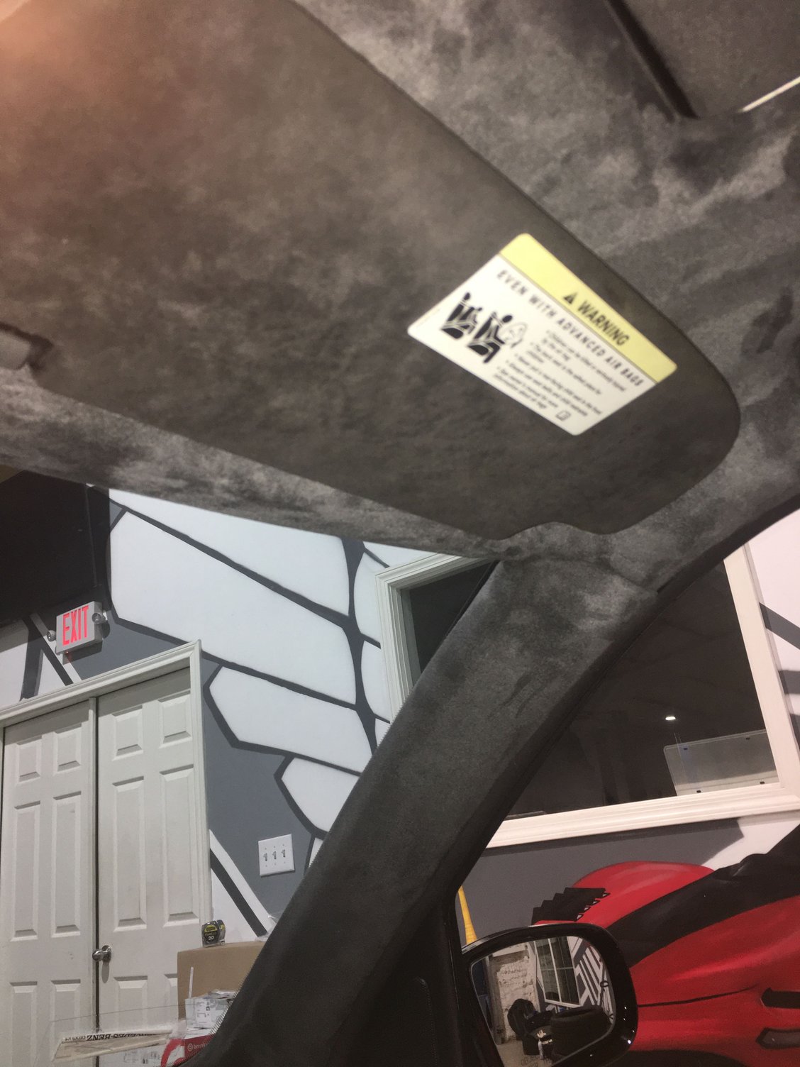

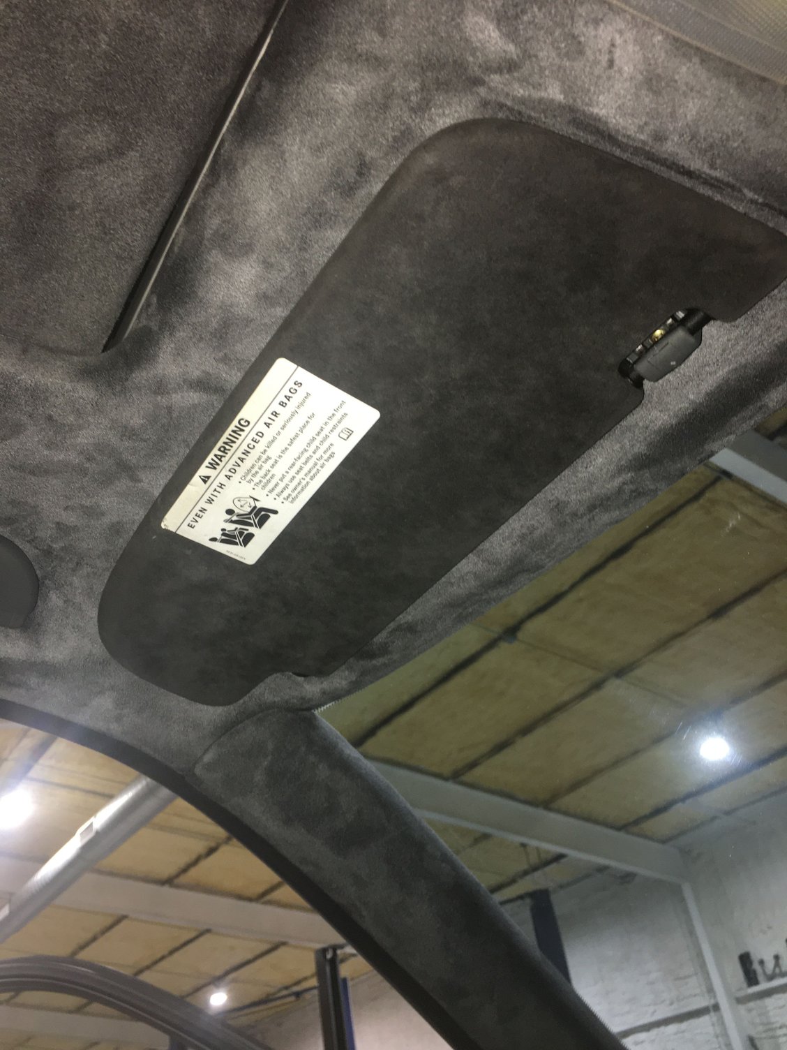

If anyone is looking for new sun visors or just want to upgrade to an Alcantara visor. W221/216 sun visors bolt right in. Requires a small amount of trimming where the two screws, screw in. I am currently just using one screw. But they fitment is perfect. They look great also.

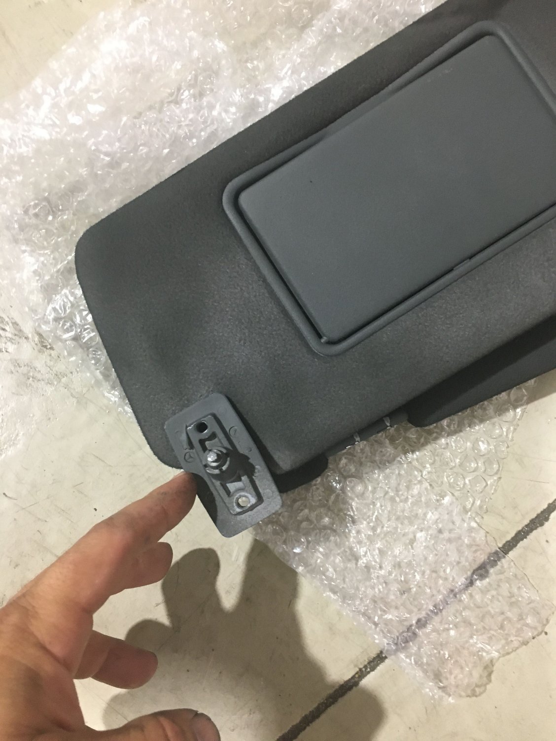

When you go to install them, you will see, the peg is just barely off set, I just used one screw to mount them. All it needs is about an 1/8in of material removed from the roof area where they mount. I still haven’t trimmed them, and one screw is holding them up just fine.
this is the 210 visor, the peg is in the center.
