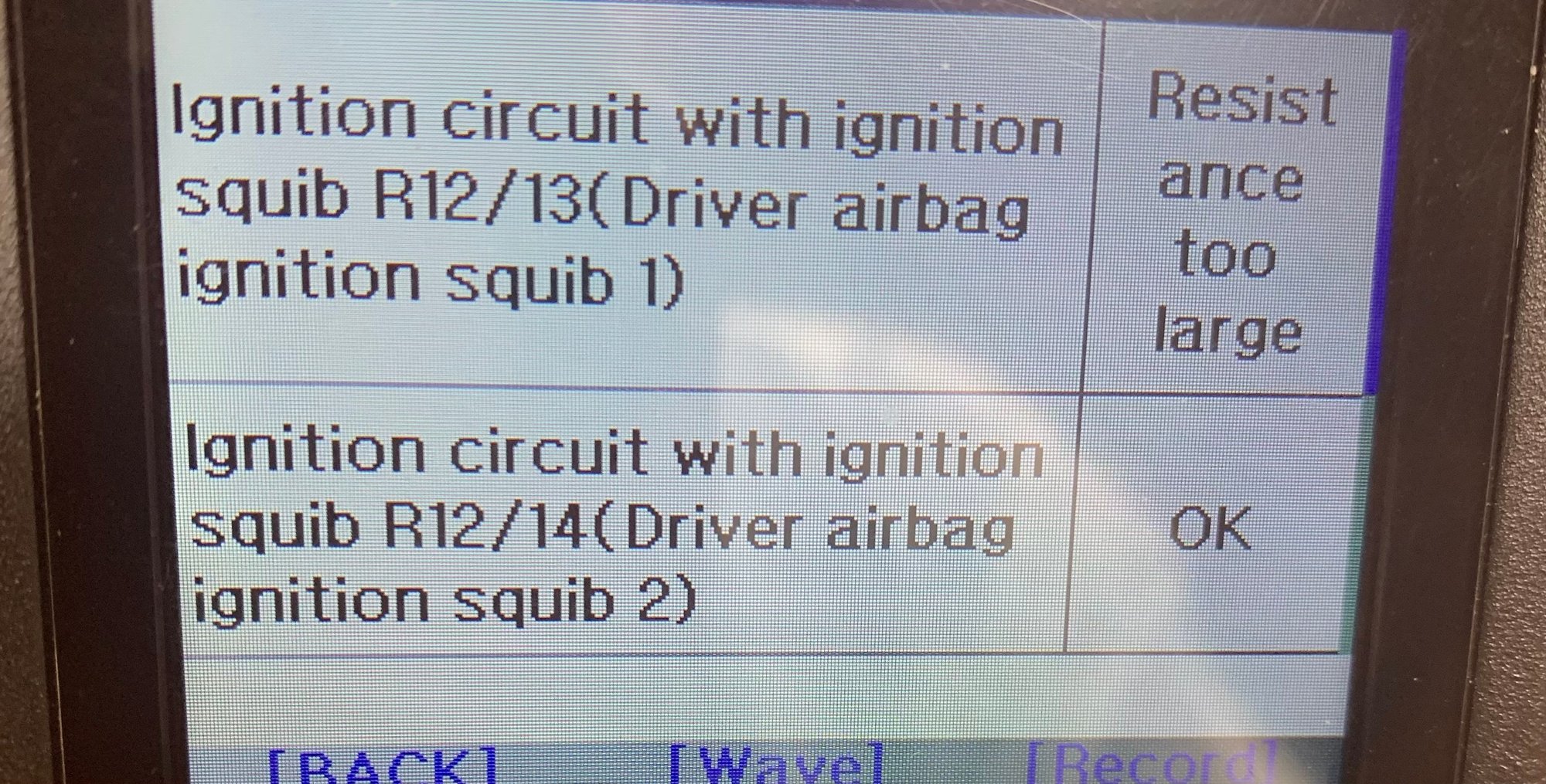

Hi…02 E55 started showing SRS light. Hooked up the scanner and got a B1859-004 and ran the individual scan on the circuits and just one returned with an issue.
Does this mean a new airbag or clock spring? I pulled the AB and checked the 2 connectors and they are fine.
Thanks for any suggestions

Possibly a corroded connector.
