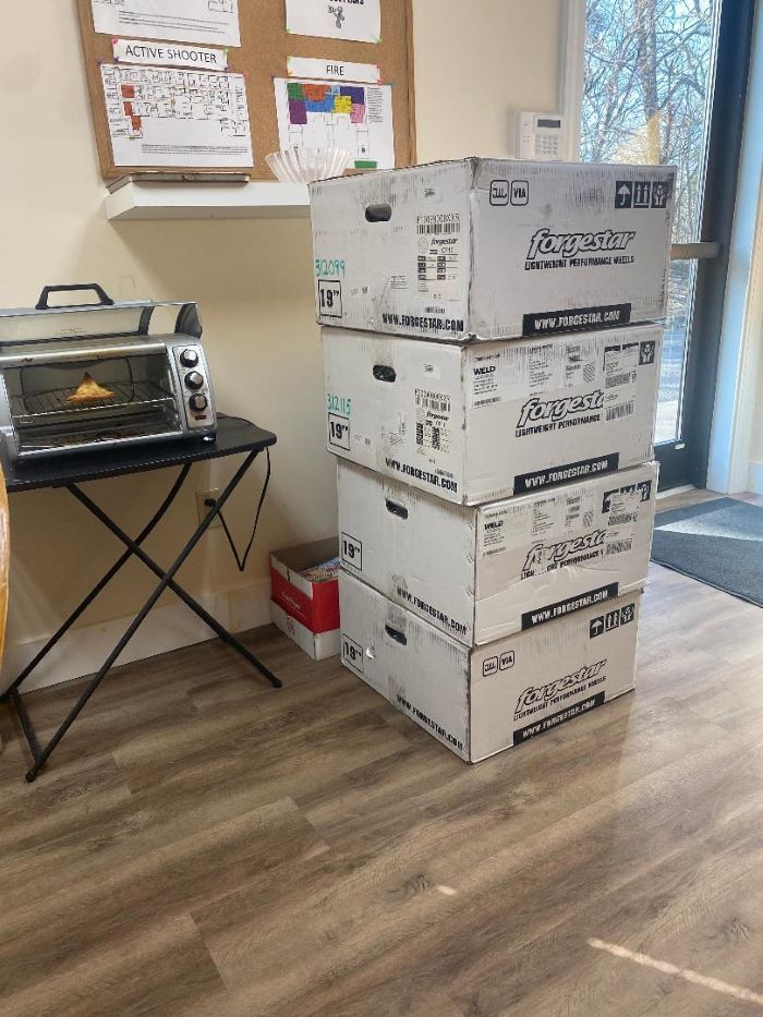

Old Feb 12, 2024 | 11:29 AM
Faast's Avatar
Joined: May 2009
Posts: 1,122
Likes: 188
'91 964 Turbo, '02 E55's & '14 E63s-w
19 x 9 and 19 x 10 with custom offsets for that black ***** I got LOL
