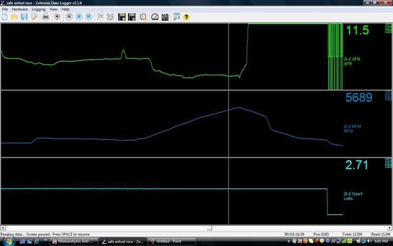

well i got the tune loaded sunday evening made a street pull tony sent me a new tune monday and we cleaned it up this am. The af drops perfect and is nice and straight not all over the place like i seen in another tune on one of these cars. The air fuel is safe and there is way more room but it just spins the tires now so im pleased. drove it to my dyno strapped it down like before and it made 447hp 466torque i will post the sheet up tomorrow i forgot my flash drive. my car made 423hp and 444 torque a few weeks ago same temps. I dynoed my race tune as well but sadly i had problems with the signal dropping on the dyno so after a back to back pull to get it to work i saw 456hp at like 5500rpms where it dropped the signal, mind you the car a little warmer too. so i feel the race tune is prob in the 460 something range. call those guys if you want a tune and if anyone is in my area i can do the data logging for you to send back and forth.
