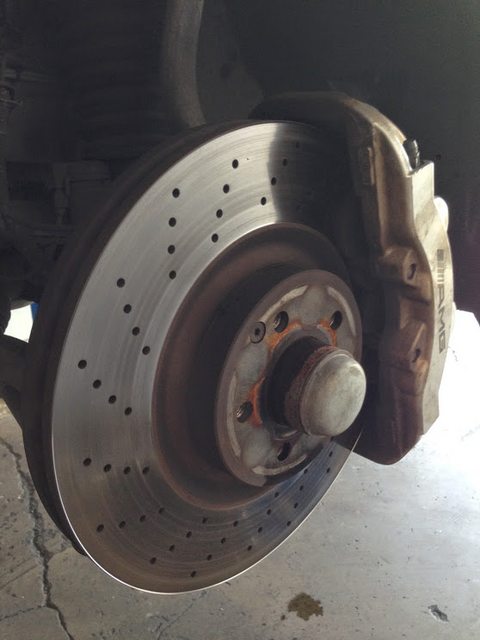

just wanted to give a quick report on the new setup
got a new set of drilled rotors from brakeperformance.com ~$130/ea (yes you can do better if you use the vendors on site! or have an account with MB)
I also got these brake pads Akebono EUR983
setup came about 5 days after ordering, customer zinc plated and painted hats black - the box was banged up pretty good...
there are not lightweight rotors ~33lbs each
here's the old setup, rotors were < 10% and pads just about the same (dusty *******s!)
new front rotors installed today :)-vu8kuavl.jpg
dissasembled
new rotors and pads installeed - nice cross-hatch on the rotors (yes the caliper is still dirty!)
final look after all buttoned up...
obviously with the brakes being as low as they were, the pedal took some pushing to get the SBS back up to par - but all done in < 1 hour
hardest part was getting the old rotors off, really stuck on there!
only put about 30 miles on them so far but initial grab is better than before - I'm sure it will only improve over time

Originally Posted by berti_00
Good Job buddy, very nice. I was hoping you'd freshen up the calipers too with some color
yep, would be nice, didn't really give it any thought... couldn't believe how big those calipers were inside!
Originally Posted by Duc1098E500
Good job man! My box too was banged up perhaps it was too heavy for the UPS staff to carefully move. Lol!
Yes, those rotors weigh the same as OEM.
yup, same weight as OEM
the nice thing is that the rotors are L & R side so the vanes actually cool the brakes which is nice - not a generic setup
