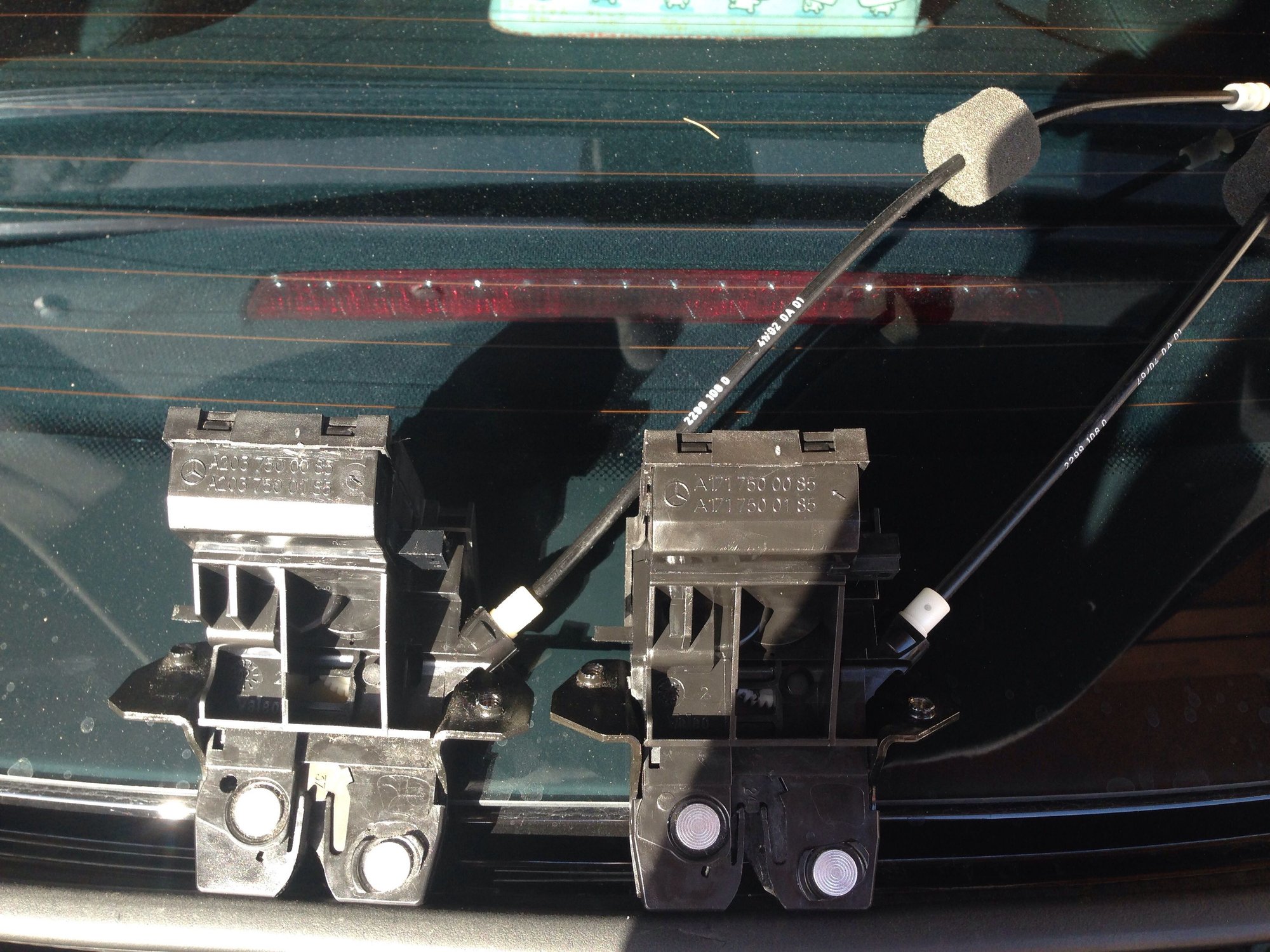

Old Jul 4, 2014 | 10:59 AM
CLKCLK's Avatar
Joined: Mar 2007
Posts: 946
From: Bay Area
03 C32 gone, 06 CLS55, 16 Tesla X
This is what I'm talking about. The one on the left is for C32 and right is for CLS/E55. If you open the plastic cover, you should be able to see the wheel mechanism. In my case, the two pins on the wheel broke. I drill a hole big enough through the cover in front of the wheel to be able to put a screw driver through, then screw in a two new small crews to the wheel where pin broke. It work just fine for me.
Pm me if you need a used one. I bought it to replace, but I was able to fix mine so it's a backup.
Originally Posted by vikingdiesel
the actuator being that one deeper in the trunk lid, NOT the handle where the motor is connected to the handle?
