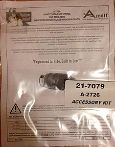

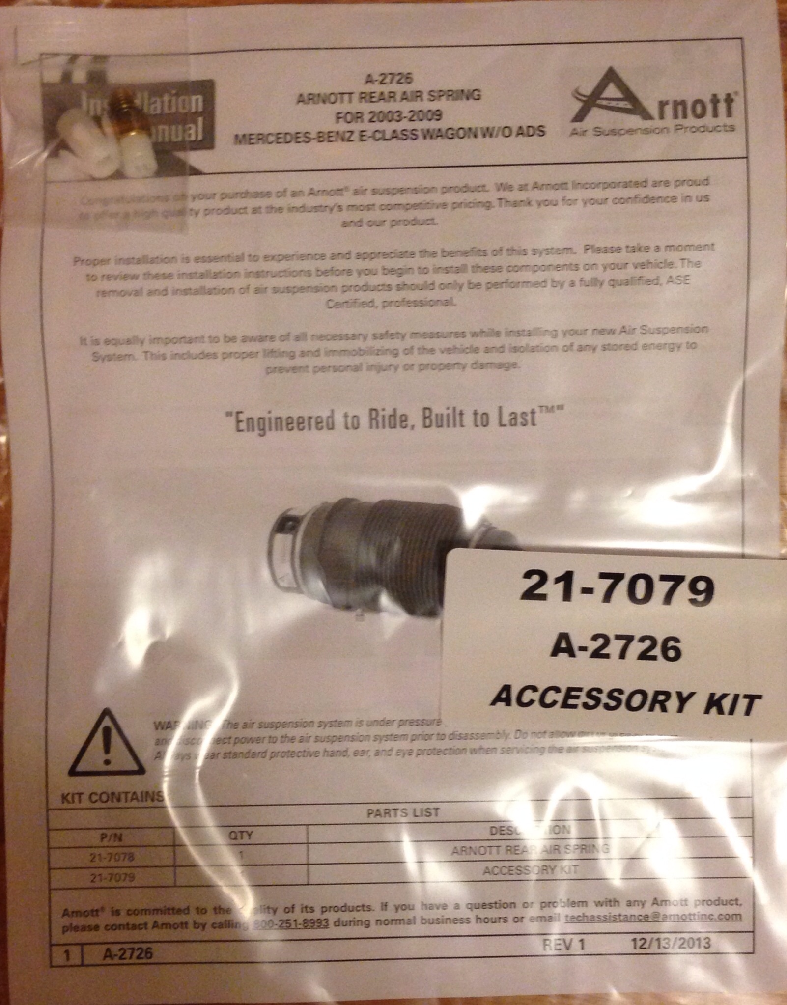

Does anyone have experience or knowledge between the two? I ordered A2725 (red), but Arnott sent me A2726 (black).
Thanks,
Old Jul 15, 2014 | 12:28 PM
CLKCLK's Avatar
Joined: Mar 2007
Posts: 946
From: Bay Area
03 C32 gone, 06 CLS55, 16 Tesla X

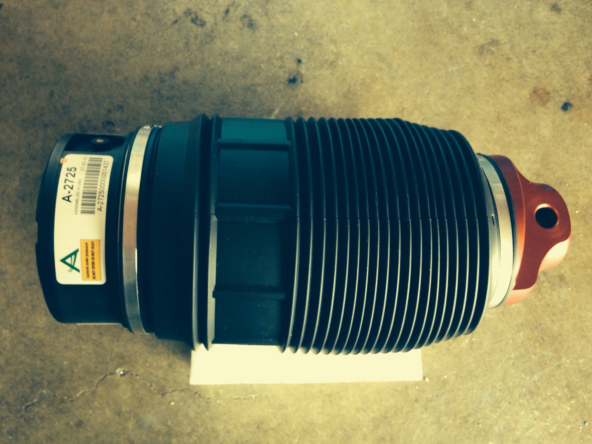

Just in case someone is also looking for the info:
A2726 is for 03-09 E class
A2725 is for 03-09 E AMG, 05-11 (CLS55 AMG & CLS63 AMG)
They are basically only different in stiffness.
Arnott overnights the right one for me

For completeness, from Arnott's website, for a 2003-2009 E-Series:
E55/E63 including Wagon - Left: AS-2301 Right: AS-2300 Rear: A-2725
W211 w/o 4MATIC inc. Wagon - Left: AS-2245 Right: AS-2246 Rear: A-2724
W211 with 4MATIC inc. Wagon - Left: AS-2295 Right: AS-2294 Rear: A-2724

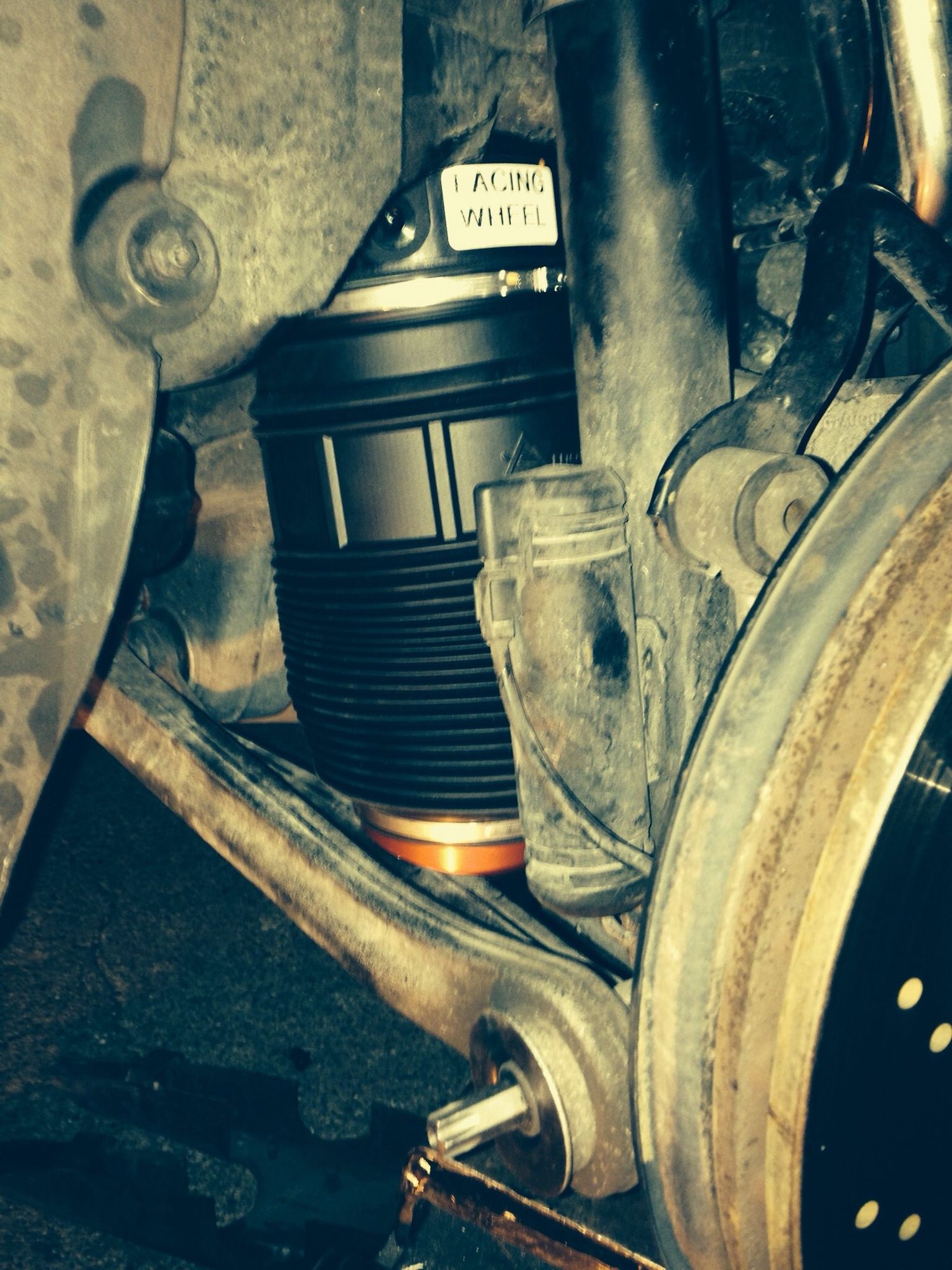

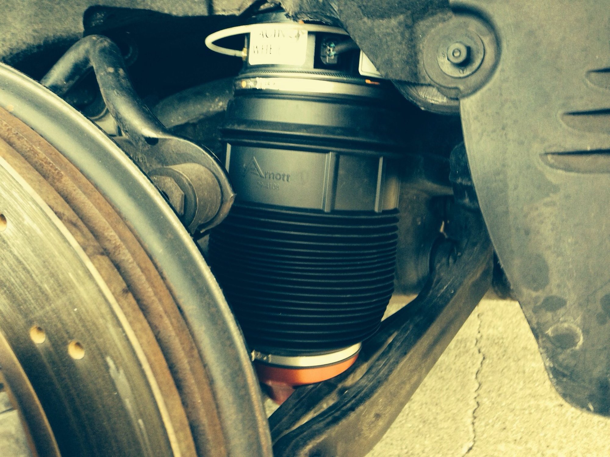

A2725s arrived yesterday. It took me 4hrs to install both sides

Originally Posted by CLKCLK
A2825s arrived yesterday. It took me 4hrs to install both sides
you say A2825 but the pic shows A2725
hows the feel?
hows the feel?
Fixed, A2725
I usually couldn't feel on most of the mods that I have done. But for sure, it doesn't drop anymore (at least since last night)
