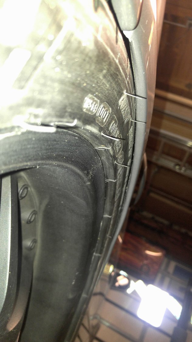

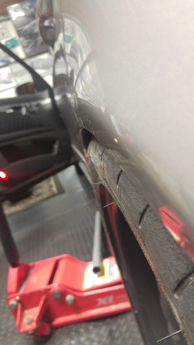

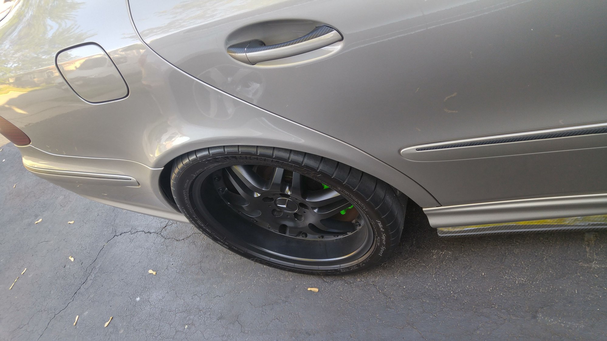

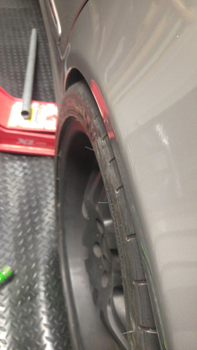

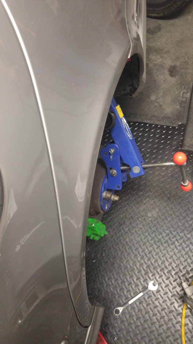

Just notice these are 295/30/19 not 35's. Sorry.
Anyway here are some pictures...
1.
Before pulling.
2.
Before, different angle.
3.
During pulling the quarters.
4.
The tool.
5.
After. Rolled and pulled.
6.
Clearance...
7.
8.
9.
10.
11.

That looks good, it tucked away nice. Thanks for sharing!
