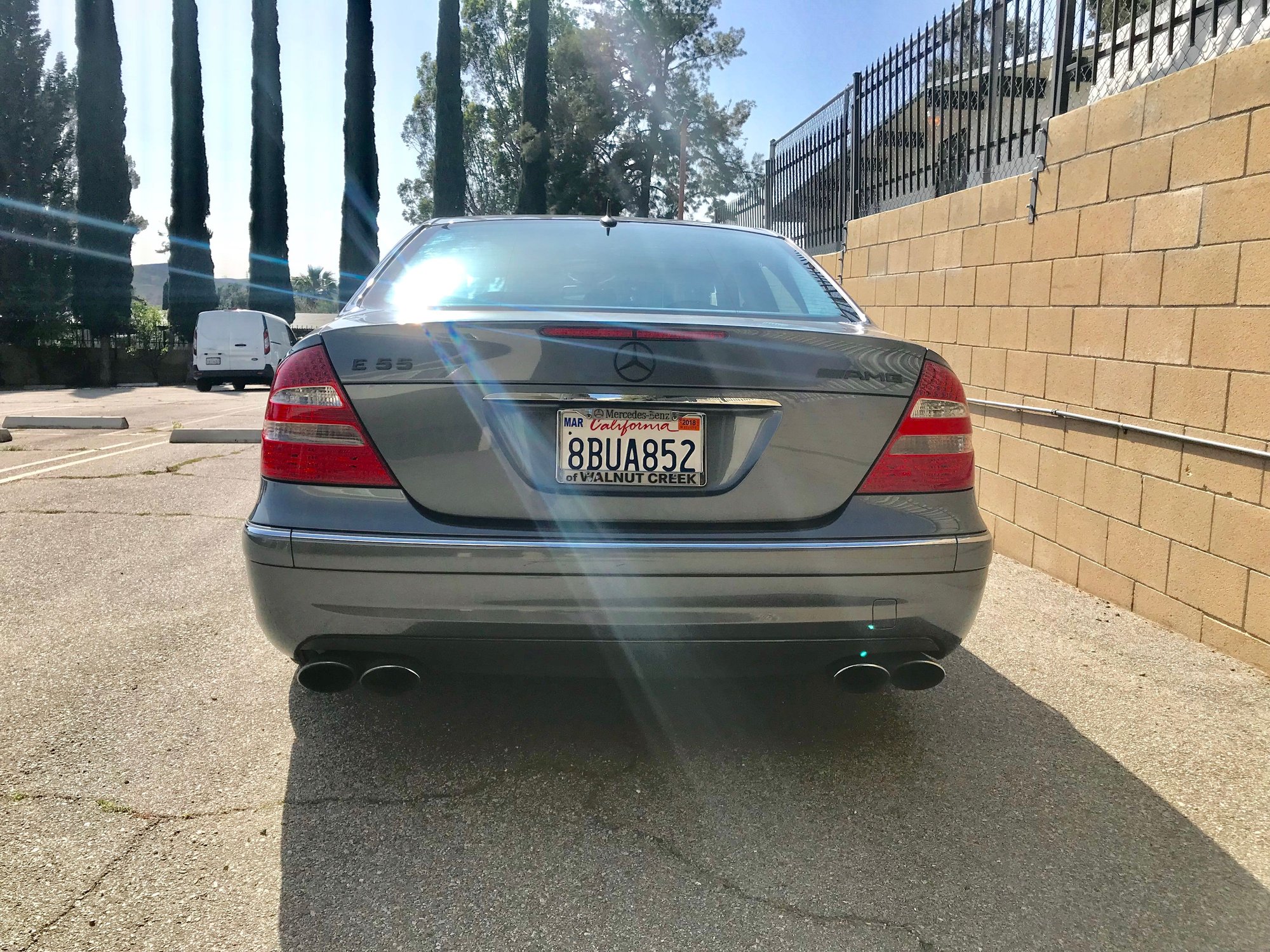

Got home a bit early today and decided to lower the car. Lowering links in front and a razor blade in between the bracket and frame out back. Its about from ground to fender 24.7 inches back and front is about 24.8-9. Passenger side is a tad higher both front and back, i noticed its the same as well on my e550
. Noticed overal e55 sits half an inch lower then my e550. I was gonna swap the rims as well but the bolts are on way too tight and cant break them loose.

Today i had the chance to do my emblems in black. So did the plasti dip. Here are a couple of pics.

Ride height looks just about perfect to me.
Never really cared for the slammed look.

Thanks Bahnstormer. This is at its lowest setting. Its super difficult getting the rear dialed in. So i always lower the rear first take measurments and go to the fronts. The front links probably need one spin up to lengthen it to lower the drivers front a tiny bit and 2 full spins up for the front passenger side. Ill measure again sat or sun first and see if thats the case.

nice color

thank you, I added more light to the pics for the emblems to stick out made the color almost look like the tectile grey but its actually much darker, mine is the flint grey.
