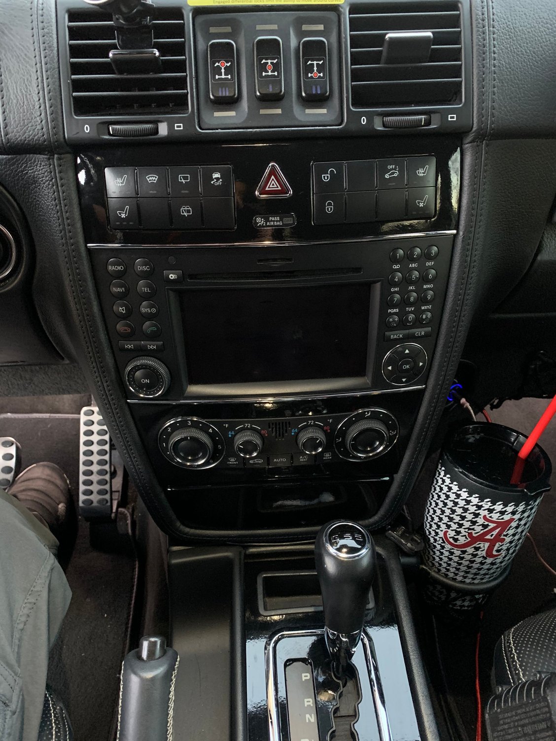

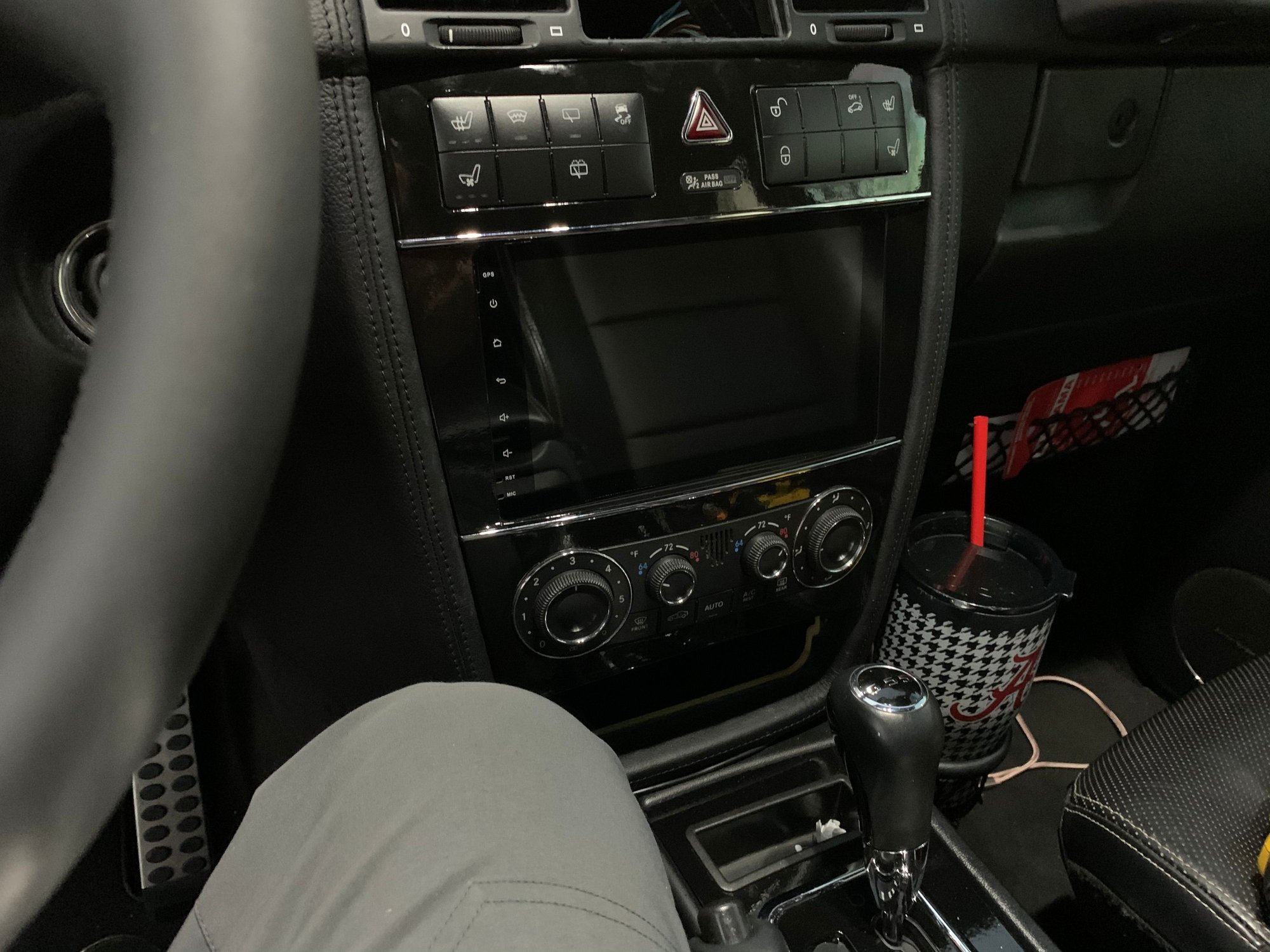

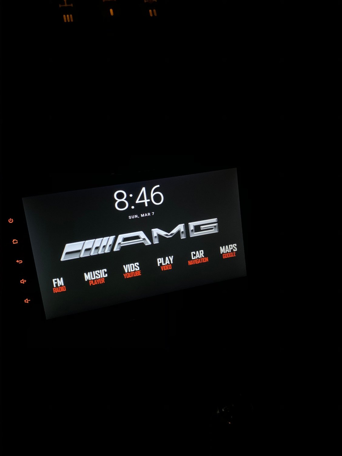

I used an android screen in my G wagon and only needed a decoder box. Note there are 2 diff versions of the box and the one i first ordered was wrong and the other works. They look the same but something is certainly diff. Yeah you lose some control vs stock as far as per speaker setting and such but if you just want sound and newer feel it’s worth it. I’m not a car audiophile I just want clear tunes and a little bit of bump with newer car abilities.
I enjoy the wireless CarPlay and used the I Heart Radio app for local stations bc none of these units work worth crap with the loaded FM tuner. Just stay in Android Auto or CarPlay mode. Mine connects just fine and auto play the I Heart app by the time I had reversed and was ready to drive.
Was super easy to program the steering wheel controls too!! I like could set the touch buttons to any color I wanted so I set to orange/amber to match the stock interior so it blended in better. Most never knew it wasn’t stock
I have a unit I plan to use in my E once it’s back to me.
pic of G install and links to the one I got for my E. I did use gloss black vinyl to cover the plan plastic edges and it made it blend in better. I plan to do the same for my E to closely blend with my real carbon interior. The AMG screen I had on the stock Android side was nice but rarely visible since I used CarPlay but nice if you want to use it and Torque app to monitor things.
E unit is likely this one but didn’t have the lower section bc I have a carbon piece there. But since i had a LED light idiots drilled into my carbon for my meth injection perhaps I should have gotten this style to combat having it there or a hole there if removed. I could black vinyl it all and blend in maybe a little more. Hmmm.
Checked vendors on AE and mine is no longer active it seems. I paid $500 but this below is cheaper.

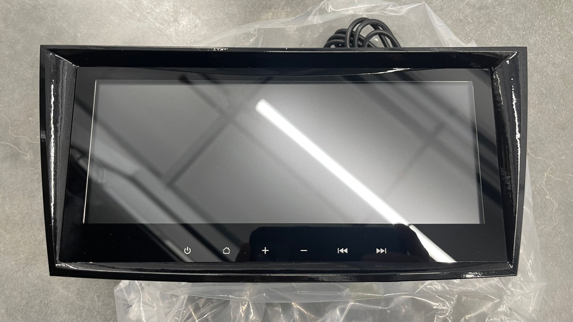

this link is the one most like the one I got for the E and G. How ever thr one in the E the screen is wider and more like the ones with the bottom trim piece. Always get the highest spec one but note some have extra cams and other stuff you might not need so you can find the same spec at lower cost by not getting useless thing. The sound in the DSP I had to press like the LOUD button to ensure solid volume. Again will ability to control some speakers like the HK stock can but it’s still steep sound to all speakers just not the faked surround of the HK.
Unit like the G wagon on and style wise like the one for the E but E has larger/wider screen.
US $133.27 46% Off | IPS 1280*720P Screen Android 11 8G+128G Car DVD GPS Radio CarPlay For Mercedes Benz CLS Class W211 W463 C219 2003-2010
https://a.aliexpress.com/_m04daEi
E version is most like this but isn’t as tall as this one so it doesn’t have the surround piece at the bottom
US $120.05 51% Off | Android 12 Car Player For Mercedes Benz E-class W211 E200 E220 E300 E350 E240 E270 E280 CLS CLASS W219 2 Din DSP IPS
https://a.aliexpress.com/_mPTUacA
Here is the one I am putting in the E when it’s back home. Note the wider screen than the top link but not bottom trim like the 2nd. Also controls are among the bottoms vs the side. Why this version is hard to get I have no idea. I do see the bottom trim version have more memory but it won’t matter if you use CarPlay. Again I put gloss black vinyl around the edges to give it a nicer appearance and blend better with my CF trim.
