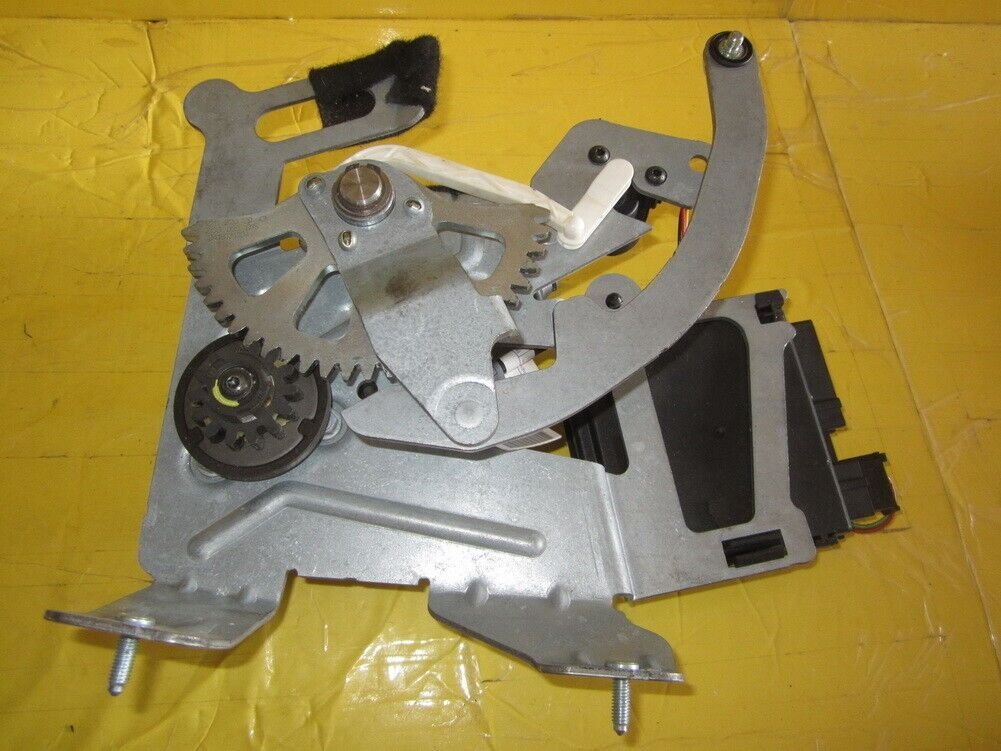

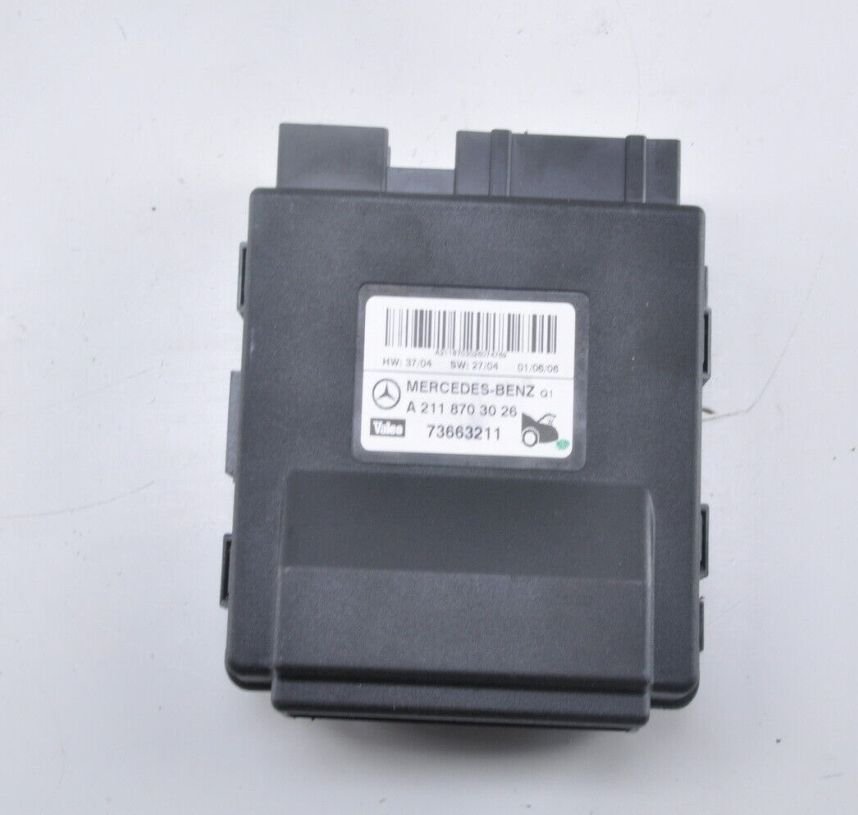

My recollection is that there were two versions of the control unit for the trunk closer. The first version closed aggressively. The later version closed more slowly.
What year is your car? Can you see what part number is on the control unit? It is attached to the hinge mechanism.

The ECU is mounted to the hinge assembly like this:
It looks like this:
The two versions are 2118703026 and 2118704526 (I believe)

I retrofitted my E55 with a trunk closer using all MB parts purchased from eBay. I paid $45 for the ECU on eBay. If you end up needing one, you can find them cheap if you take your time looking.
