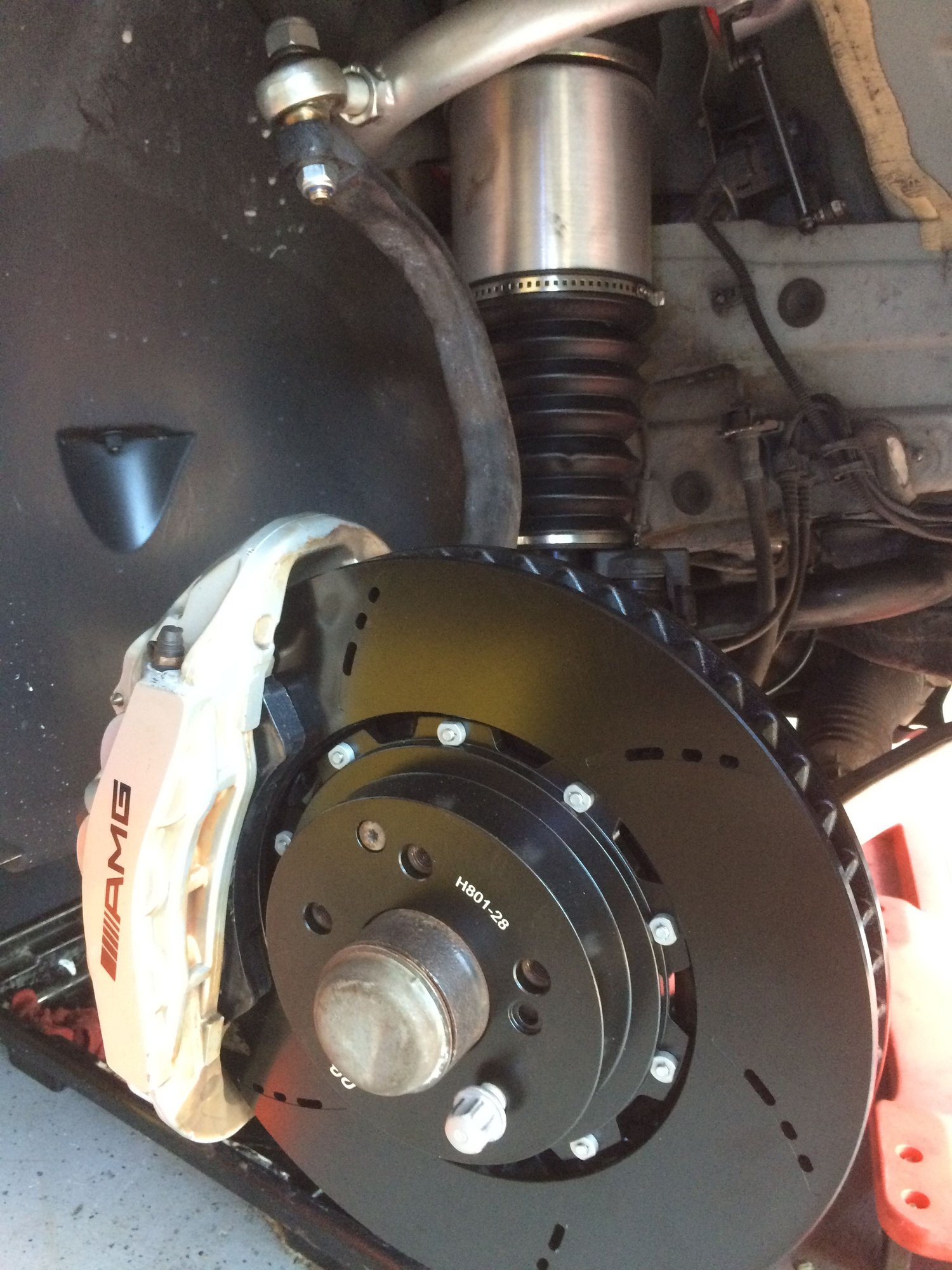

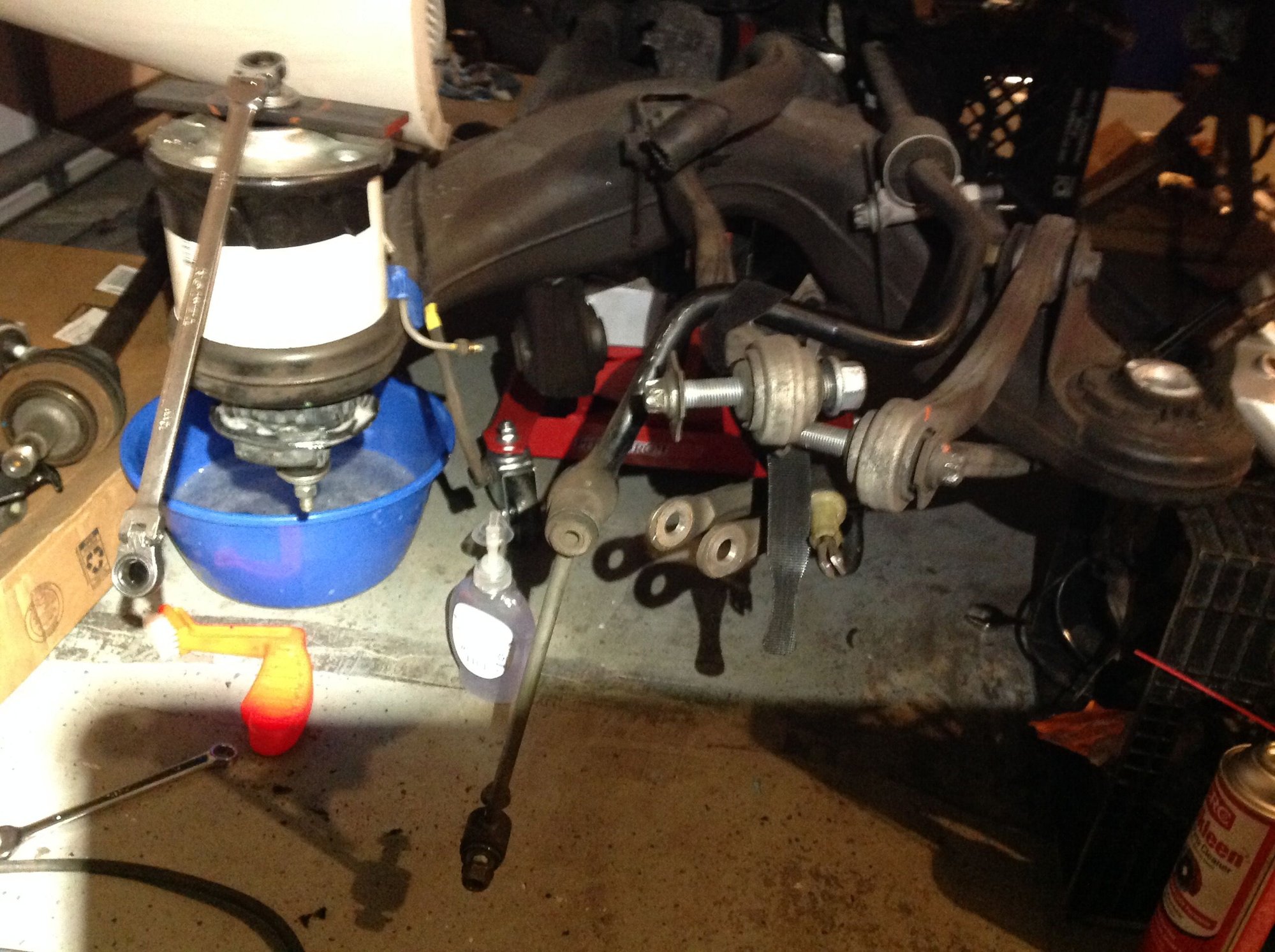

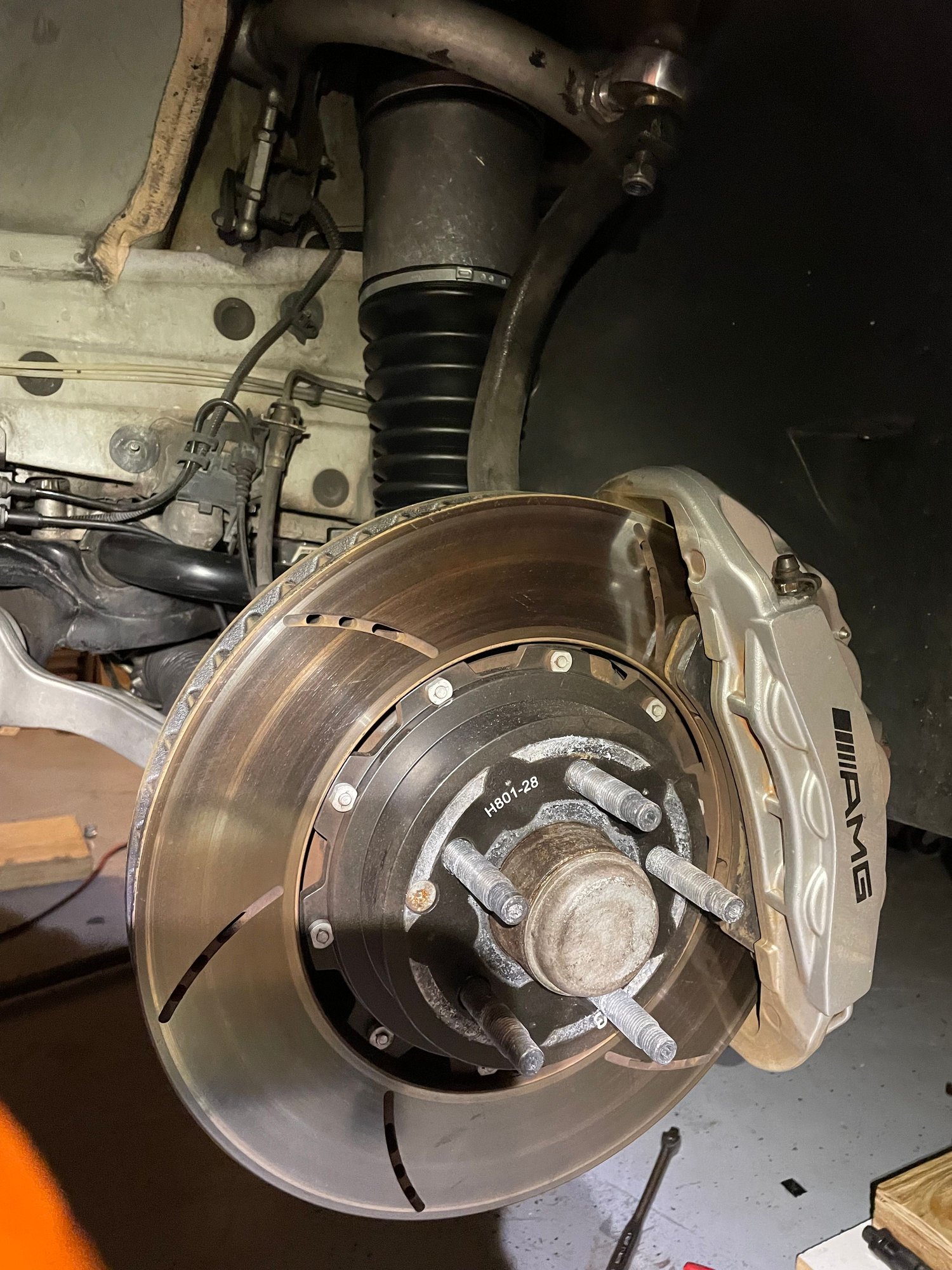

I had been compiling parts to completely refresh the rear end of my 2007 M156 E63 in the years preceding C0V1d, but once it hit, there was no better time for me than the present to commit to undertaking that project! I ended up installing new rear shocks, RMT ReBuilt AirSprings, Subframe bushings, rear torque arms with new bush in Carrier, K-Mac Poly Bushings for both upper rear arms, New Drive Discs and Mid DS Bearing, Rear Main Seal, Tranny Mount, Hubs, Painted Brake Dust bracket?, 3.06 Gear swap w/LSD, EVap Canister, UPD Toe Arms.
As to the rear Air Springs, since the Air Ride Control Switch in essence sets the Compression / Rebound to one of 3 settings, and since those setting features would be applied in the case of the rear end to the Shocks leaving the Air Spring to vary in accordance with ride hight presets, my worry would be that perhaps the Arnott may not work as Mercedes intended. That said, the Control Switch Features should work! I ended up dropping the whole of the rear subframe by disconnecting the e-brakes, Air Lines, and separating the Drive Shaft from the rear Diff. I used a Tranny Jack under the Diff ( after fashioning together a brace to stabilize the Diff ) to lower the whole rear end.

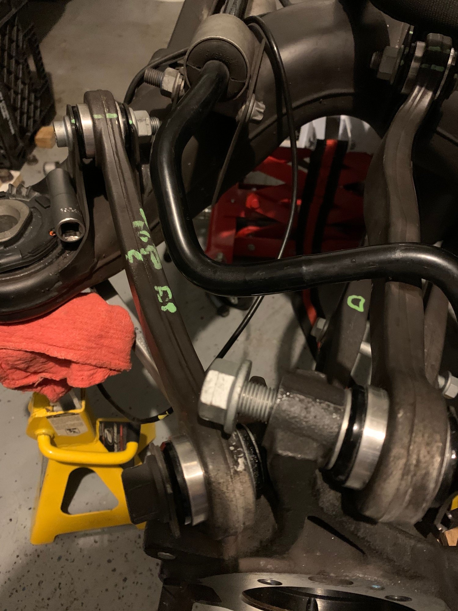

Removed the entire Subframe to replace all the Bushings for the Subframe to Car as well as those of the Arms (see shiny Poly KMAC replacement bushings), the Rear of the Differential, the front Diff Carrier to Subframe, wheel carrier to Torque Arm Bushings!!
Rear Subframe Installed with new UPD Rear Toe Arms. Notice all the alignment marks I made making sure to install those huge bushings just where they needed to be!!
My DIY Subframe Bush Removal Tool! Same tool used to replace all the bushings.
This is after 10k miles, still going strong!
This is what the Racing Brakes looked like when they were newly installed.
