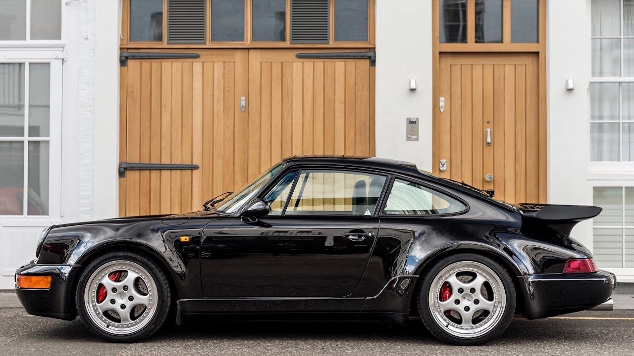

930 turbo,
The 965 Turbo (3,6L), from the original Bad Boys movie, is hands down my favorite car ever produced. Quite frankly, I’d sell the E55, my Supra, and possibly my left nut for one of those.
The ultimate car!
Sorry for the off topic, Chris, but you had me drooling for a second…
(Probably wouldn’t sell the Supra, but you get the point..)
