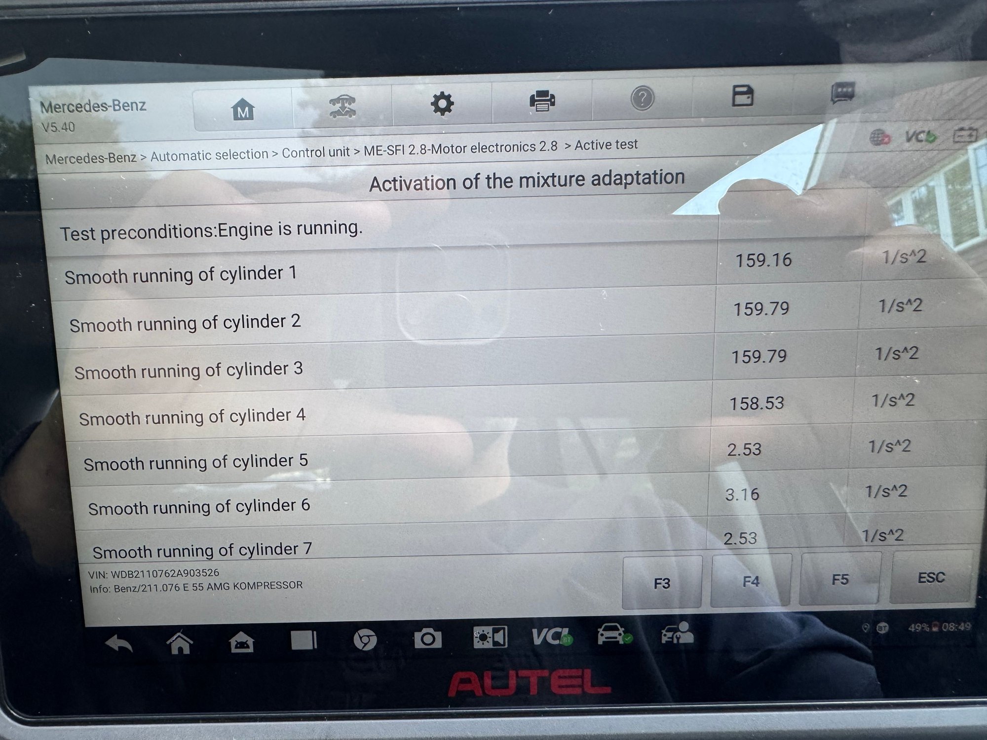

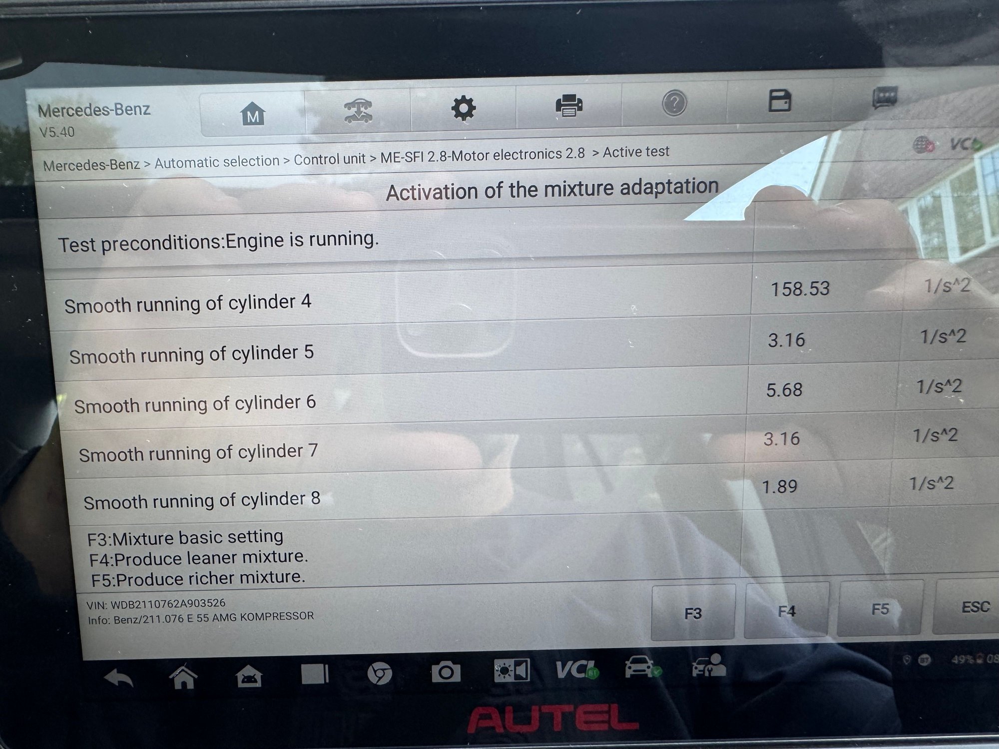

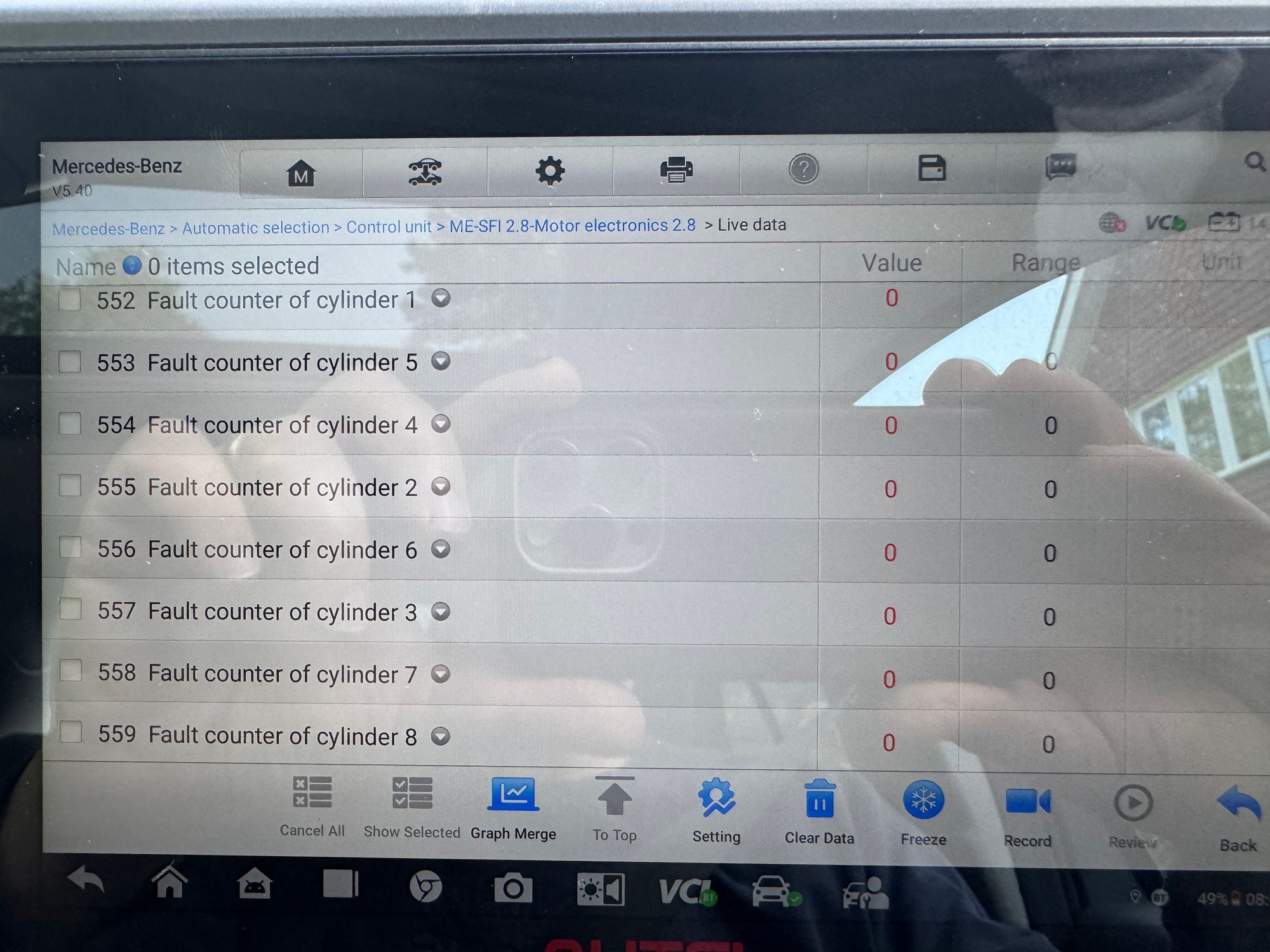

So bank 2 is being positively compensated and bank 1 negatively… how why??
No misfires or anything untoward…

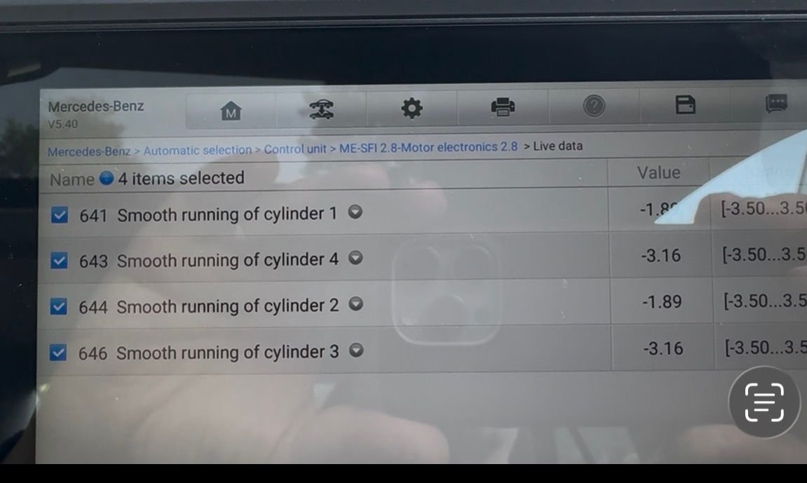

The reduction here is mostly within the -3.5 limit but also does exceed it at times.

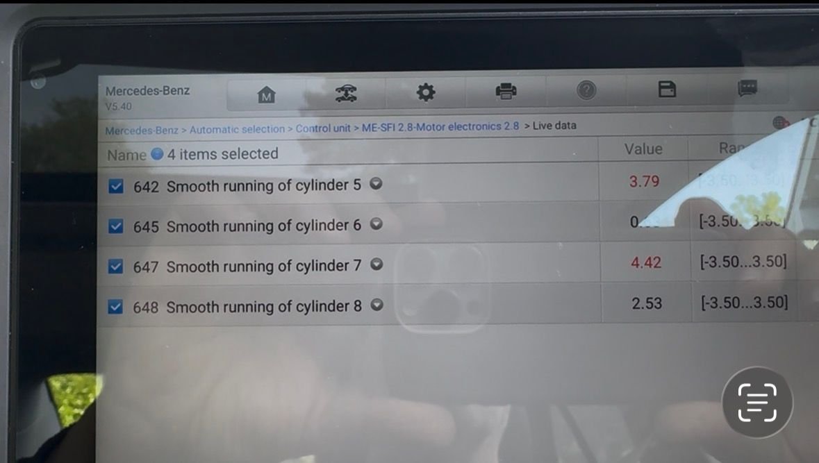

Example from video - these are being boosted beyond 3.5 quite often.
