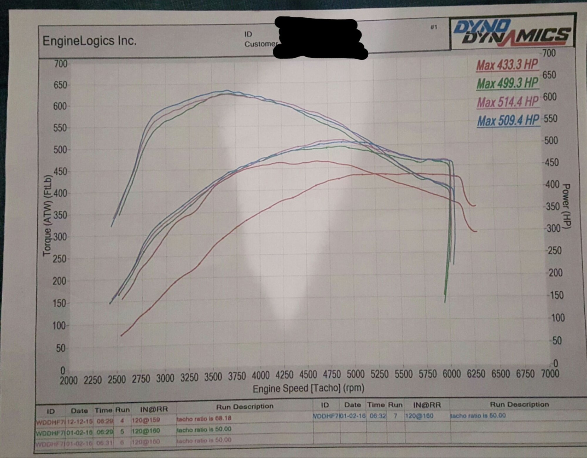

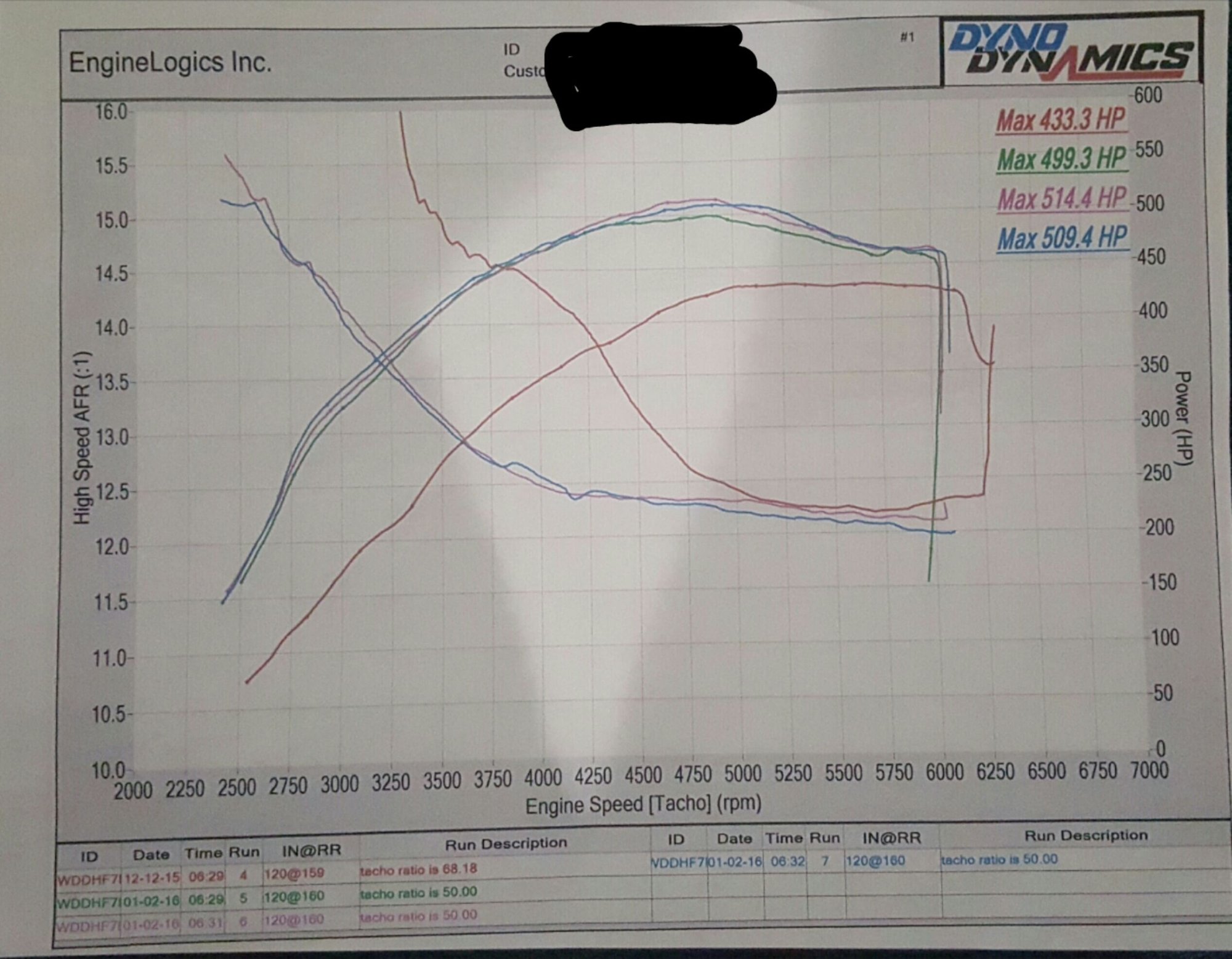

Sold my E55 and need to update my profile picture, but I have a beautiful 2012 E63 Bi-Turbo and believe it or not, it came with a Renntech tune in the ECU! I paid them a small amount of money to upgrade it to the new code, then I hit the dyno.
Here are the sheets - so my question is, do I use a 20% driveline loss as the dyno operator says? If so, my engine is putting out 625 hp? Does torque need any kind of a re-measurement or since that is twist, is the 655 valid? My first dyno!

seems kinda low... that 499 whp from dyno dynamics is about 560 whp on dynojet.... most of the new tunes i have seen are around 600-610 whp on dynojet....
do you have the old cooling setup or have you updated it as the pre- 2014 m157 supposedly had cooling issues

Same dyno I used, same range I got on that dyno and same thing the dyno operator said to me.

18% drive train loss

He might have the stock non-divorced cooling

Stock cooling, yes!

So, Mustang Dyno will have around the same WHP as DynoDynamics ??

yes, though i have read that dyno dynamics will actually be slightly lower than mustang dyno, but they are much closer to each other than dynojets
