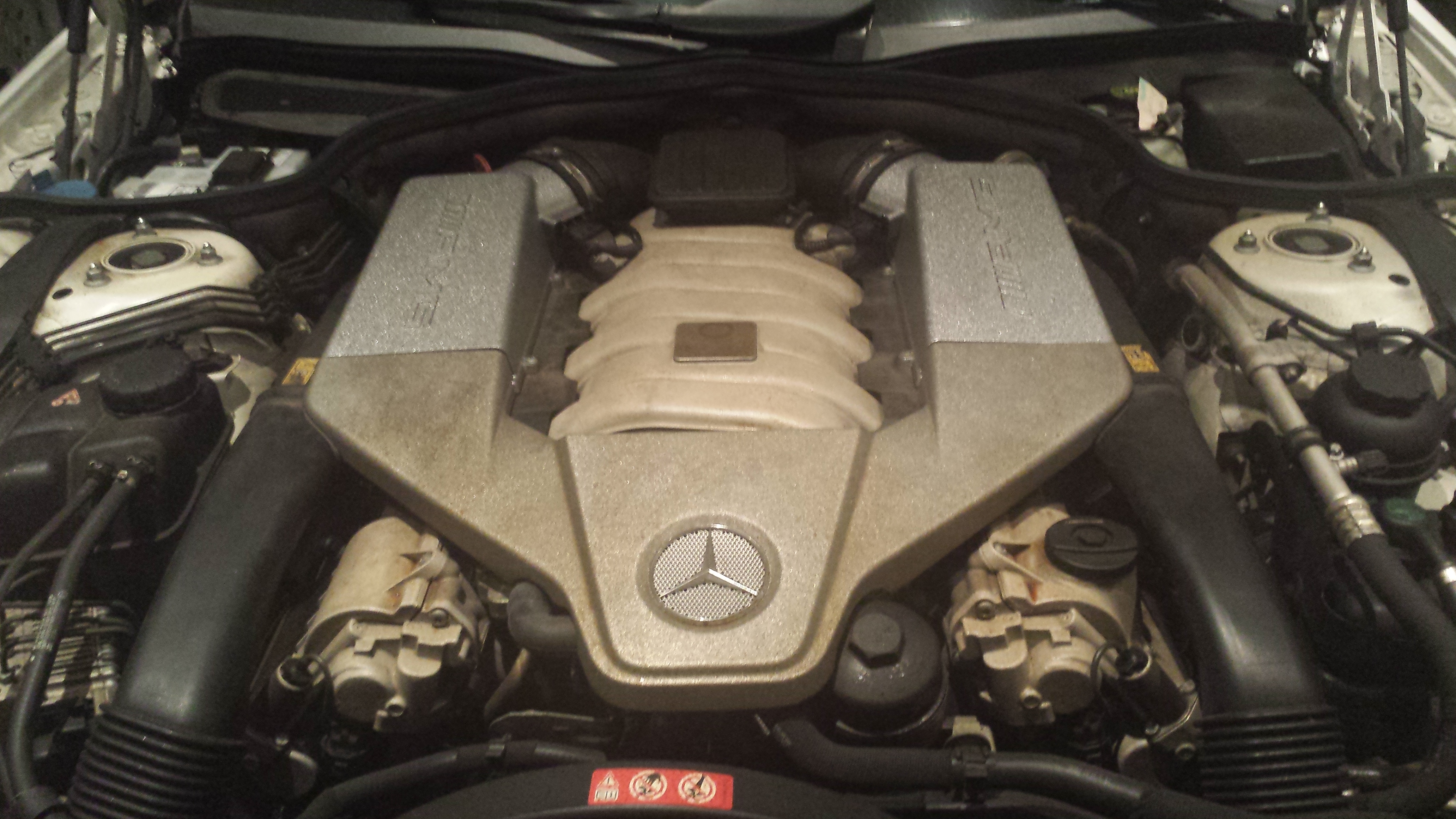

Yes, it is very easy to do just as you've described it. A couple of considerations for your M156 though. ROW air boxes can be picked up relatively cheaply if you shop around. ROW air boxes have better airflow based on their design. They also delete charcoal filters.
Whether you do that or not, I would look at high flow filters over stock and do the charcoal filter delete. I purchased afe filters from Amazon
Amazon.com: aFe 31-10154 Air Filter: Automotive Amazon.com: aFe 31-10154 Air Filter: Automotive
They are more expensive than stock but they will last for a lifetime, you can simply pull them out and clean them anytime and just put them back in. My engine ran more smoothly after I did this, was more responsive and also got a bit better mileage.

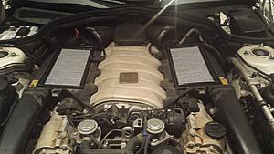

Have a look in the classifieds on this forum, you can find them a bit cheaper (or there were a couple available a while back). I just had my car emission tested (Ontario, Canada) and it passed without any issues. They are OEM, so look exactly the same but were designed for outside of North America. The Charcoal filters sit in the top of the existing air box, you have to pull/slide them out. I kept mine in case they were required for the emission test, but ended up not needing them.
I am far from an expert, but if you went to the Weistec site they suggest the ROW airboxes will actually help optimize the tune as you are getting better airflow into the engine. You should check with eurocharged directly though. I would suspect they would encourage this and likely also sell the ROW Airboxes to complement their tune.
Total time to install was less then 20 minutes start to finish, no special tools required.

Here is a picture with the new Airbox installed. You'll note a difference in colour but that is from the previous owner having rust proofed the engine bay without covering the engine, so my existing covers are covered with goop which I can't remove.
