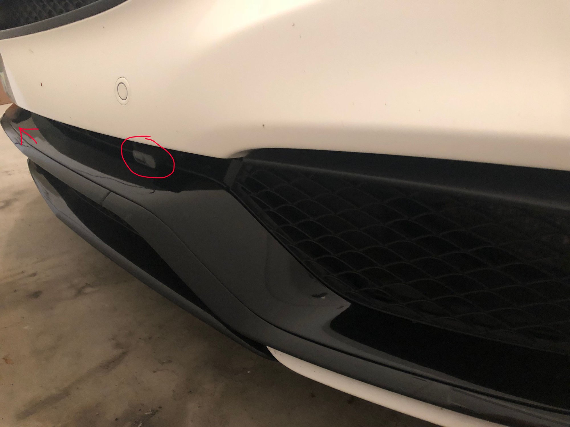

I did the escort max ci360 and performed the following:
Display - Driver side headliner near rear view mirror
Control - fabricated into ash tray cubby
rear jammers - above license plate both sides
front jammers - below front grill both sides
pics:

Thanks for sharing this. When I posted this thread it was more intended to get info on specifically the ALP system. Your post would be certainly apprporiate on a general laser jammer thread.
Also, I cant make out the picture of the front jammers. It is a 2015 e63 right? Also, have you had your system tested? If I am seeing your pic correctly, they seem a bit low on the front end from what I have read.
they are low in front, yes. I’ve put down a good amount of mileage since installation and am always alerted 1/4 to 1/2 a mile of an active threat with directional (front or behind). Haven’t been able to test the jammer yet but I’d like to. What made you choose the ALP over any of the others out there?

rear senses are attached to a license plate bracket. These are my fronts
I'm looking at your front sensor locations, and they seem to be configured differently than the ALP recommendations. They suggest the small TX sensor in the middle at least 20 inches above ground, and then the 2 standard sensors closer to headlights, like you have your drivers side sensor. Am I seeing your pic correct? Looks like you have the TX sensor close to the passenger side headlight?
Did you find out something different than what they suggest?

i had it installed before the TX sensor was available. The system failed after a few months due to a defective sensor. If the system was it would repeat
"automatic sensor checked failed F2"
over and over nonstop without pause until I turned it off. So the installer replaced the defector sensor with TX sensor. He could have used a regular sensor but he said TX was more powerful.
