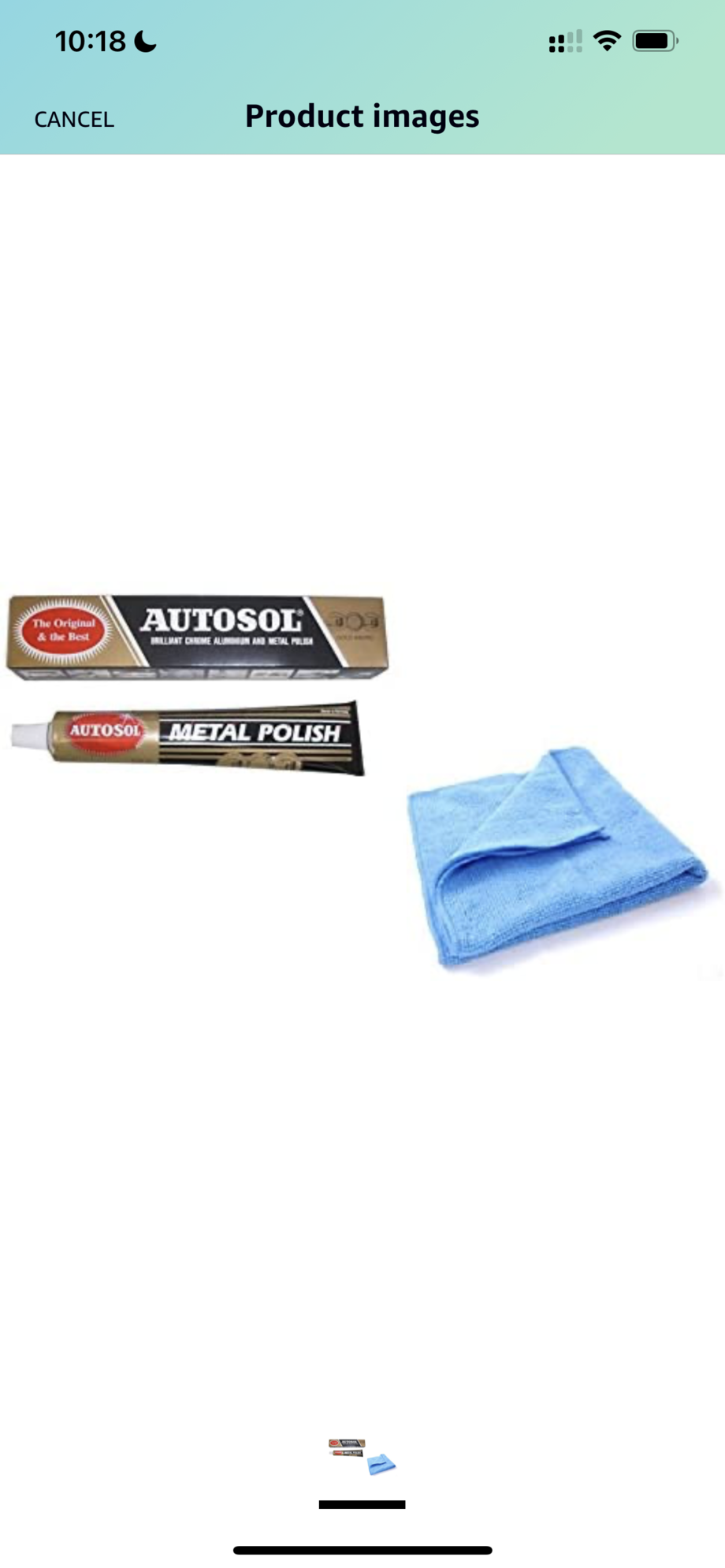

I used Autosol Metal Polish and soft cloth. I doesn’t take much I used maybe a half a finger nail in total per window trim and gently smeared it and then just dried it off with a gentle movement. And instantly then used a wet piece of cloth and then dry. To ensure no residue was left of that polish. It took about 15-20 minutes to do all trims and one tub of that polish here in Sweden costs about 5-6 euro.

Thanks very much!!! Have just purchased a tube and will be giving it a try as soon as the weather clears up. Looking forwards to having my car looking back like new(ish)!

Have you had time to try it out and did you get a satisfying result. I will redo mine once weather gets better. 5-6 times in auto wash and I see it’s coming back a little.

I did, and it looks great! All the discolouration went away super easily and now looks great. Agree probably needs do be done a couple of times to get back to showroom finish, but for now I'm very happy, thanks very much!!
