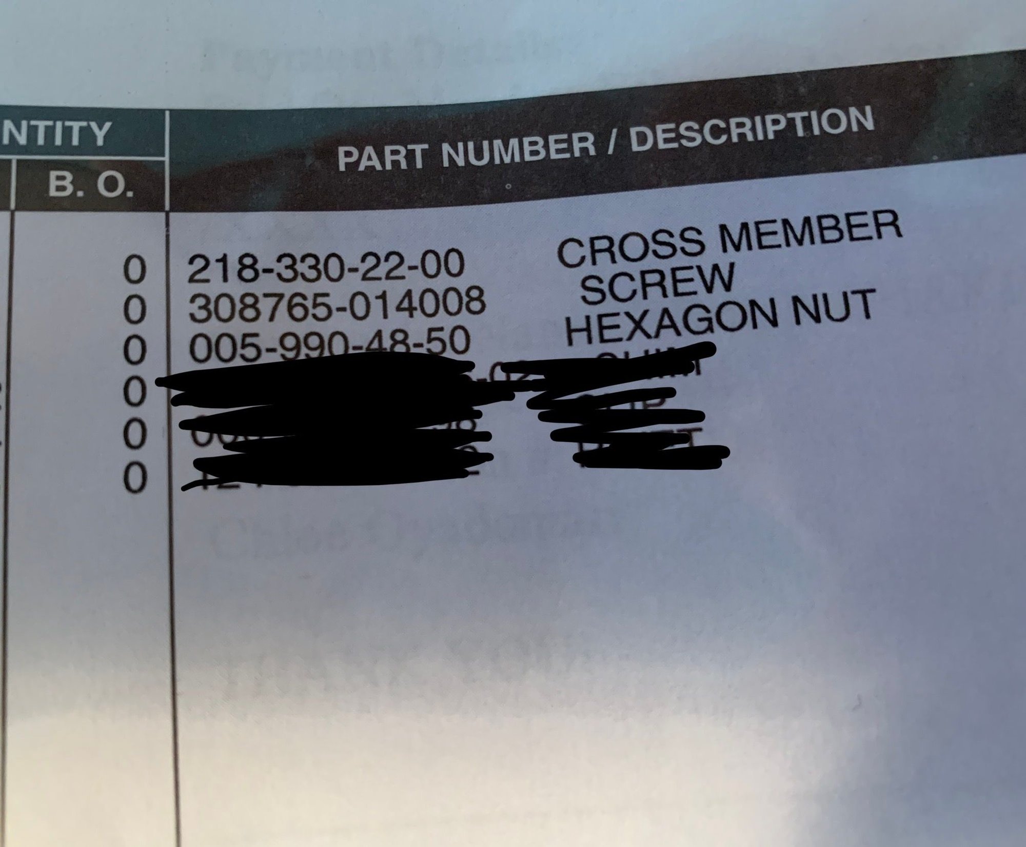

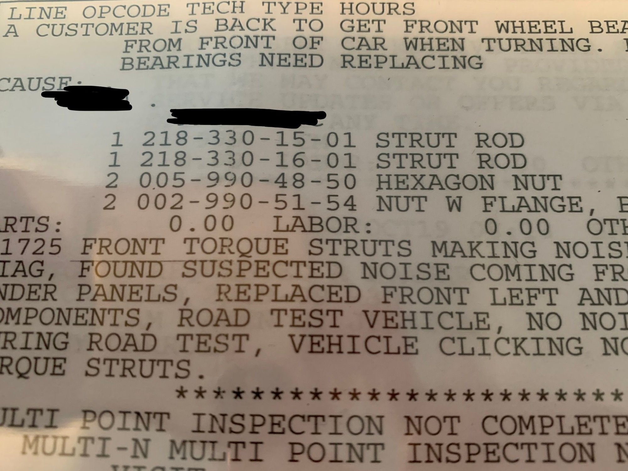

On my 2016 the dealer replaced front wheel bearings, both upper control arms and lower cross struts and then an alignment was performed. All under warranty, chasing a sound that was coming when moving the steering-wheel while the car was off. The sound got muted a bit but the ride quality not gonna lie improved noticeably, more smooth over bumps and the car drives straight like a nail on the freeway. At the time the car had only 20,000 miles. I think if i switch to Michelins from these ****ty P-zeros, ill see further improvement of ride quality.

Thanks Timm...I know I'm asking a lot, but do you happen to have the RO where they did that work? Wanted to see if I had the same PN's....
Mine is a 15 with an october 14 production date...

Hey no problem here you go, car production date is OCT-2015 and ill PM you the dealer. Also the “strut rods” include new bushings and the “cross member” is same PN for both sides.
