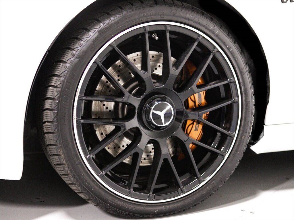

Thanks SAMzE63s! I love that idea regarding the exhaust. It's currently straight piped so it is insanely loud and frankly stinks!
Here are the wheels. Again, seeing it in person tomorrow but after speaking MB Parts they did say the VIN said they were steels to begin with.

Stock muffler with H pipe sounds amazing! you wont regret it
These are definitely not Carbon Ceramics Brakes, most likely previous owner wanted the "CCB" look and powder coated them that color. If he straight piped it I wouldnt be surprised ahahaha
Correct. Definitely not CCB’s. Looks like regular brakes painted.

As other have mentioned you are just changing the stock steel rotors/pads. The painted calipers do look nice.
