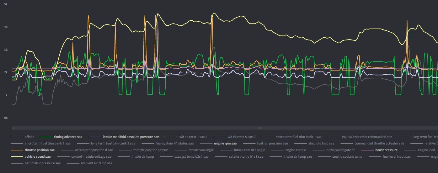

I've got a 2014 E63S Wagon with a Stage 2 ECU tune from Jerry at EC. I've been running it for a little while and have noticed that the car seems to go through multiple modes of behavior - I've searched to see if others have had similar issues and I cannot find any reports, so I'm getting the sense it is unique to my situation. I'm big into data (looks like I'll be at home on this forum) and excited that this presents the opportunity to get to know my vehicle a bit better. I've gone ahead and purchased the HPTuners MPVI2 and had my first go at pulling some long logs today. Following in the footsteps of 5Soko and Brutus I've taking the data and thrown it in datazap.me to make it a bit easier to manipulate. Note that the car is all stock minus the tune.
Key differences in behavior that I've noted on occasion:
  • Car will suddenly feel "bogged" and any throttle inputs elicit a sluggish response
  • The burble aspect of the tune will go crazy - nearly any closed throttle on a decline will make non-stop cracks and pops
    • The only way I've found to limit this is to keep the throttle partially open or to get on the brakes to slow things down (Leads me to believe this is related to vacuum and/or timing)
  • Shifting can be affected - either shifting too early or what I describe as a hesitation when shifting (notably when accelerating in 7th as it drops down to 5th)
  • RPMs can hunt on occasion at idle (I've not seen this in the stock profile otherwise I'd suggest this is potentially a sign of a vacuum leak)
Up to now learning HPTuners and collecting data has been fairly easy, but I could use some help with analysis and putting some of this data into context (i.e. normal or not). I'm throwing this out there to see if some of the resident experts have any initial insight or can identify anything worth of investigation.

Some details on max and min:
  • Boost
    • Max of ~30PSI absolute
    • Min of 14.7
  • Timing
    • Max of ~35
    • Min of 19.5
  • Intake Pressure
    • Max of ~30
    • Min of ~3

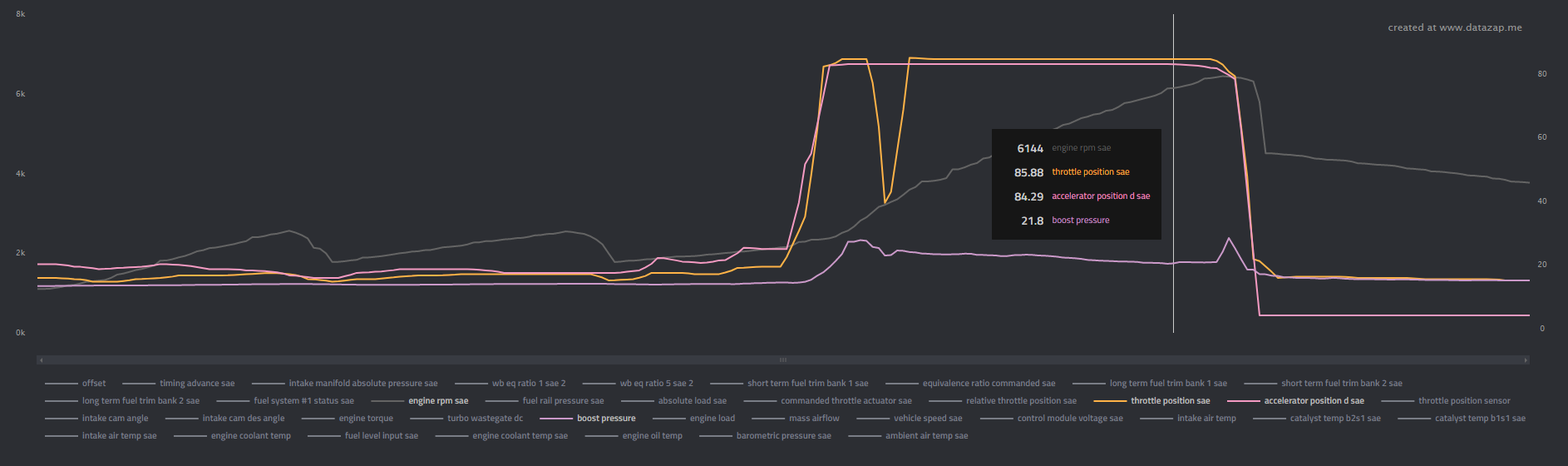

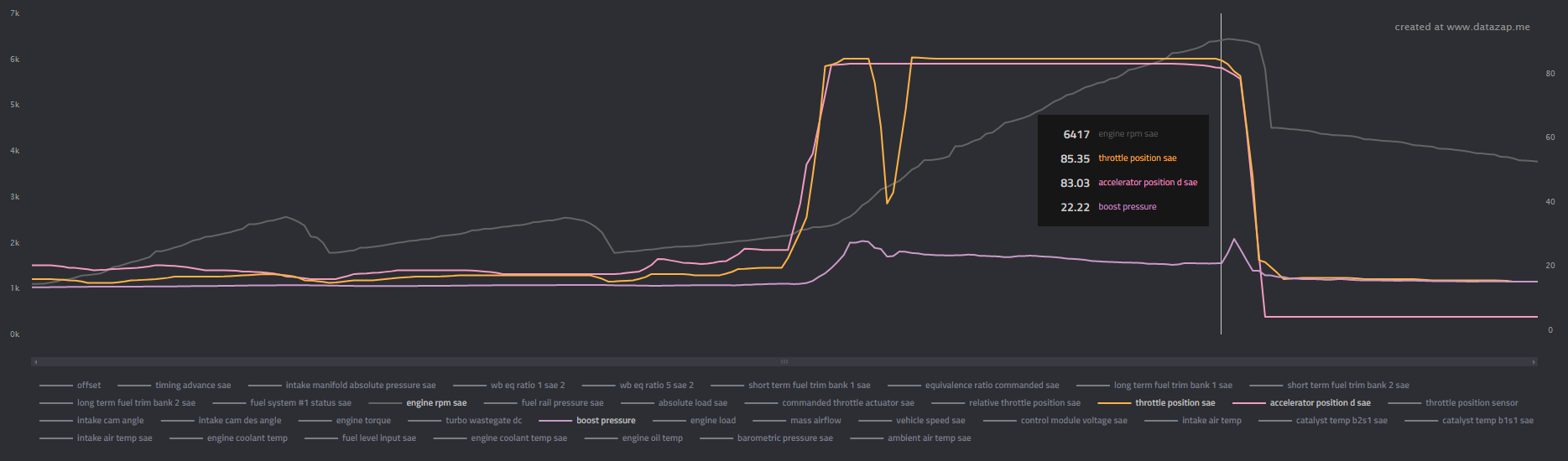

@brutus_tx Here are a couple of 3rd Gear pulls - I believe you had this same issue with the throttle closing even when commanded full open, but I couldn't find the exact post to revisit the outcome.
Today's weather was quite fair here with an approximate DA of -370ft
Pull 1
Pull 2
I didn't get chance to run the other tunes so will have to aim to do that another time this week.

There's something odd going on there for sure... not only is there no reason why you would have the throttle closure at that point in the RPM range, but your boost seems to taper off over the course of the rev range.
What's your timing doing over the same range?
Thats a nice little boost spike at the end of the run as well.
My throttle closures were attributed to the TCU intervening to restrict torque during gear change by forcefully closing the throttle regardless of peddle input. Never during a pull after the gear change.
Look at all the other data points to see if anything looks amiss.. check fueling, timing, knock etc...
I suggest sending this log to Jerry to see what he thinks may be at issue.
Old Nov 3, 2020 | 04:15 PM
JGun's Avatar
Joined: Jul 2018
Posts: 20
2014 E63S Wagon
Got it - and agreed. I can't say I felt it during the pulls, but it does seem strange. I've sent these files to Jerry as well to see what his thoughts are.
Timing doesn't shift at the moment the throttle closes, though obviously I don't know if the timing on a relative scale is normal at all. The only things that show similar dips around the same time are boost pressure and intake pressure.
Appreciate the input.
