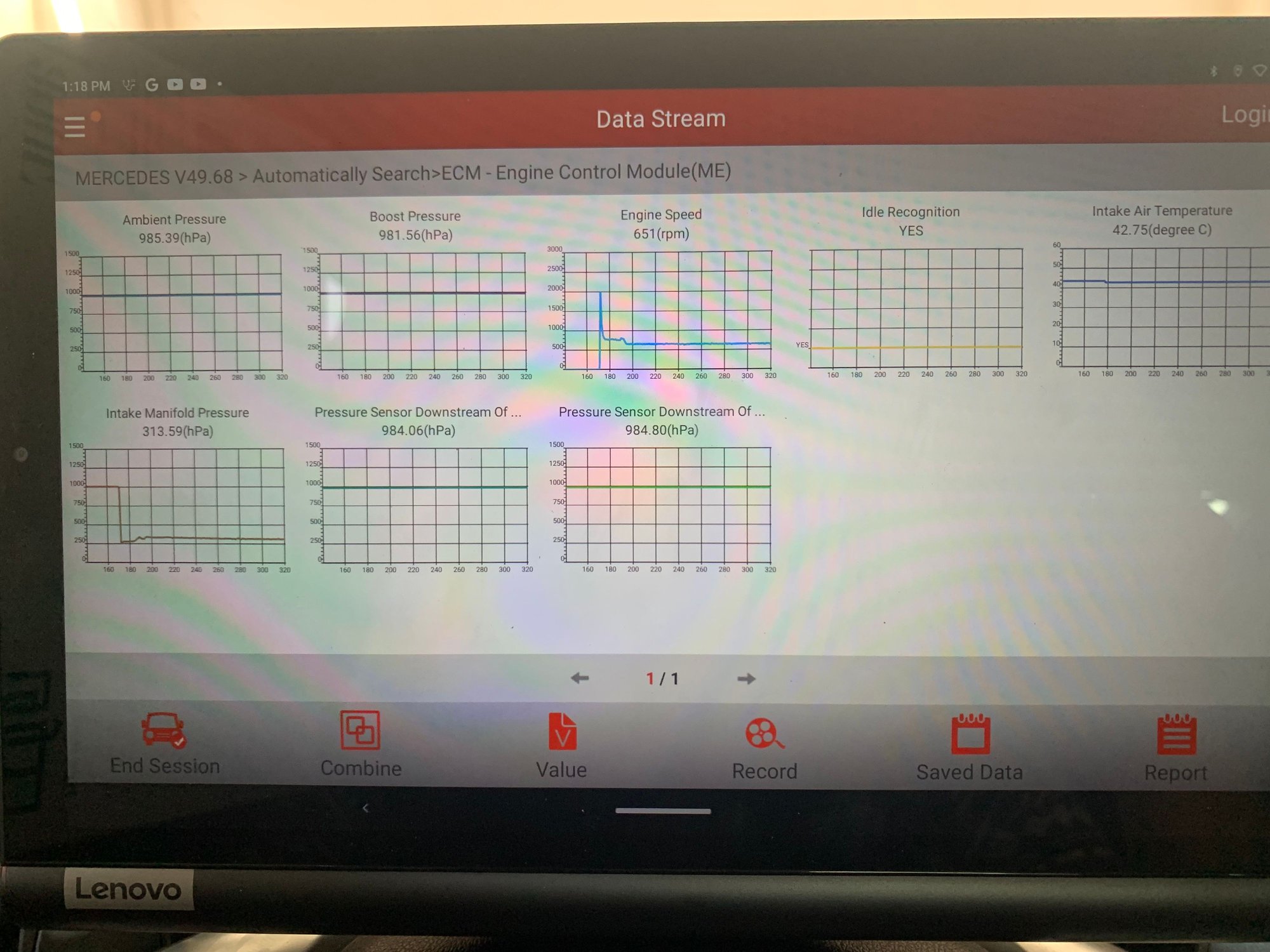

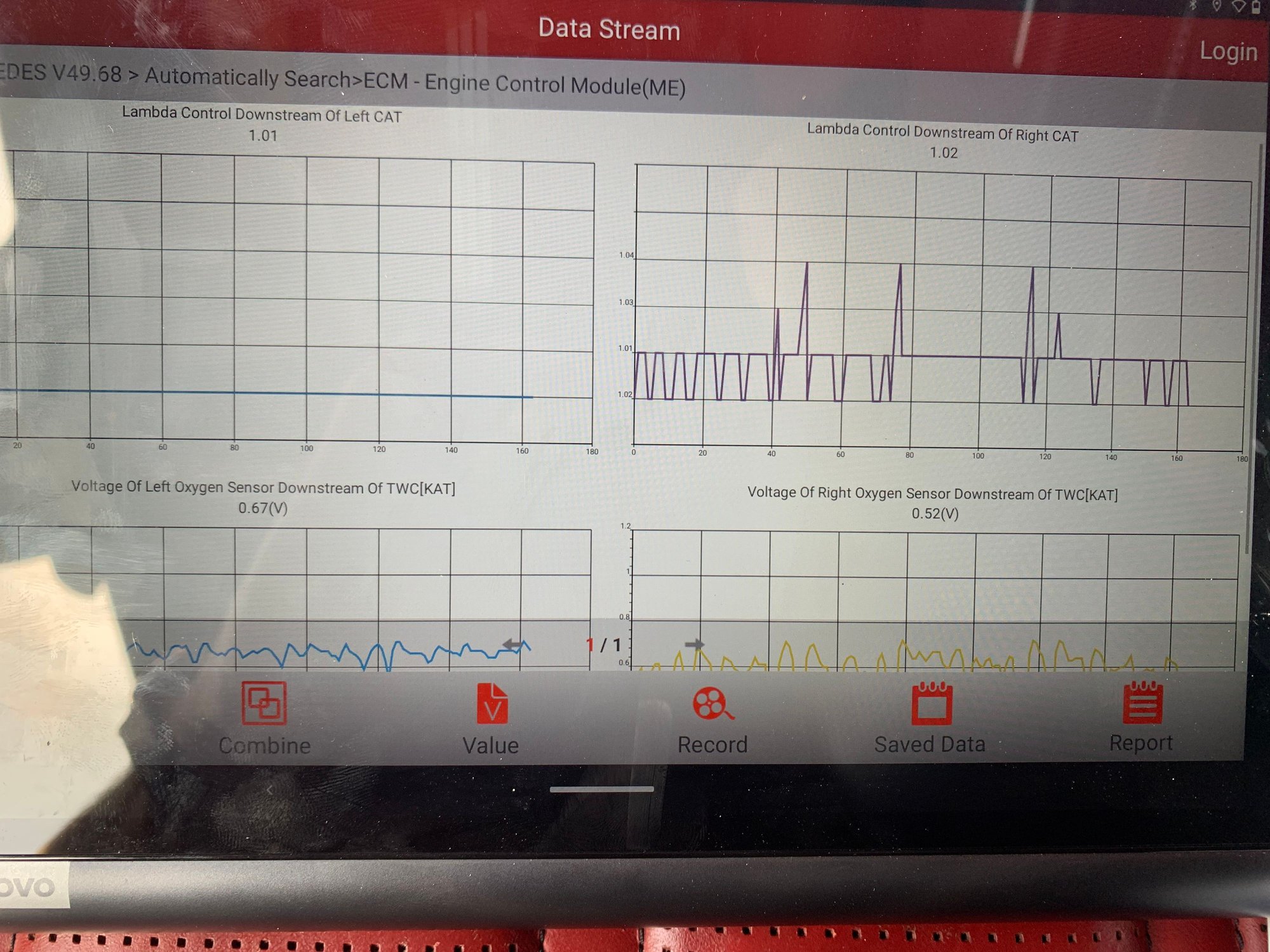

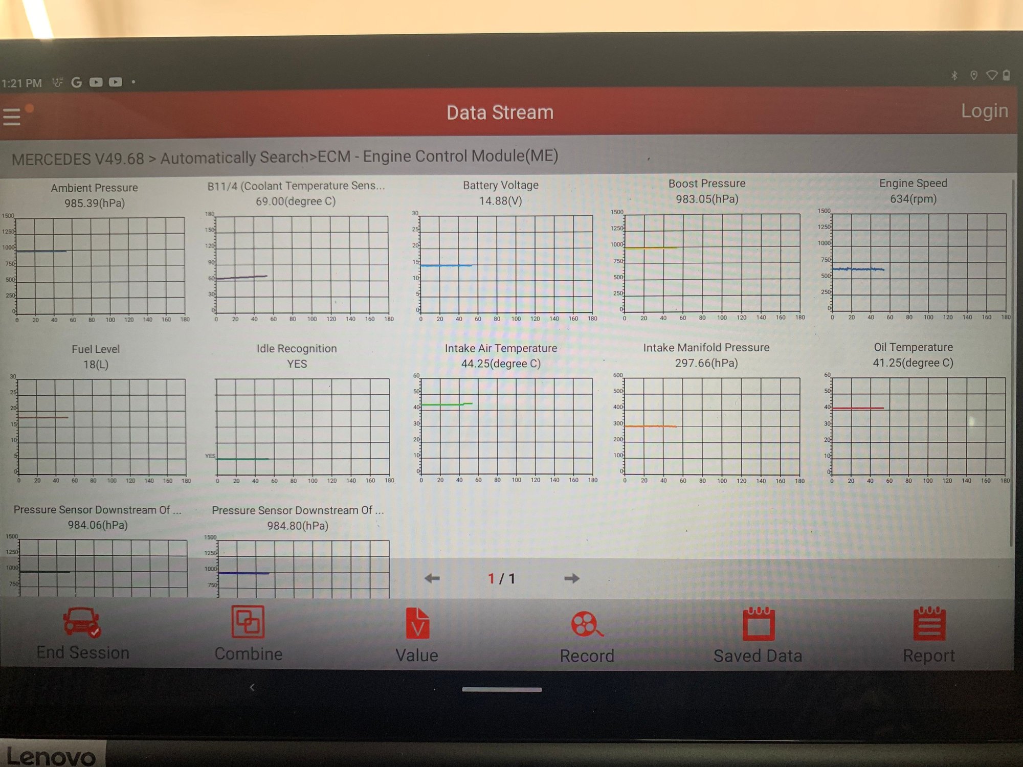

Old Apr 1, 2022 | 07:25 PM
Siegmann's Avatar
Joined: Sep 2018
Posts: 961
Likes: 103
10-second E550
Check also the MAP sensor value for vacuum at idle.
If you can choose data to log, look for short term and long term fuel trims, and manifold absolute pressure sensor. I'm not familiar with that software interface or I'd try to help more.

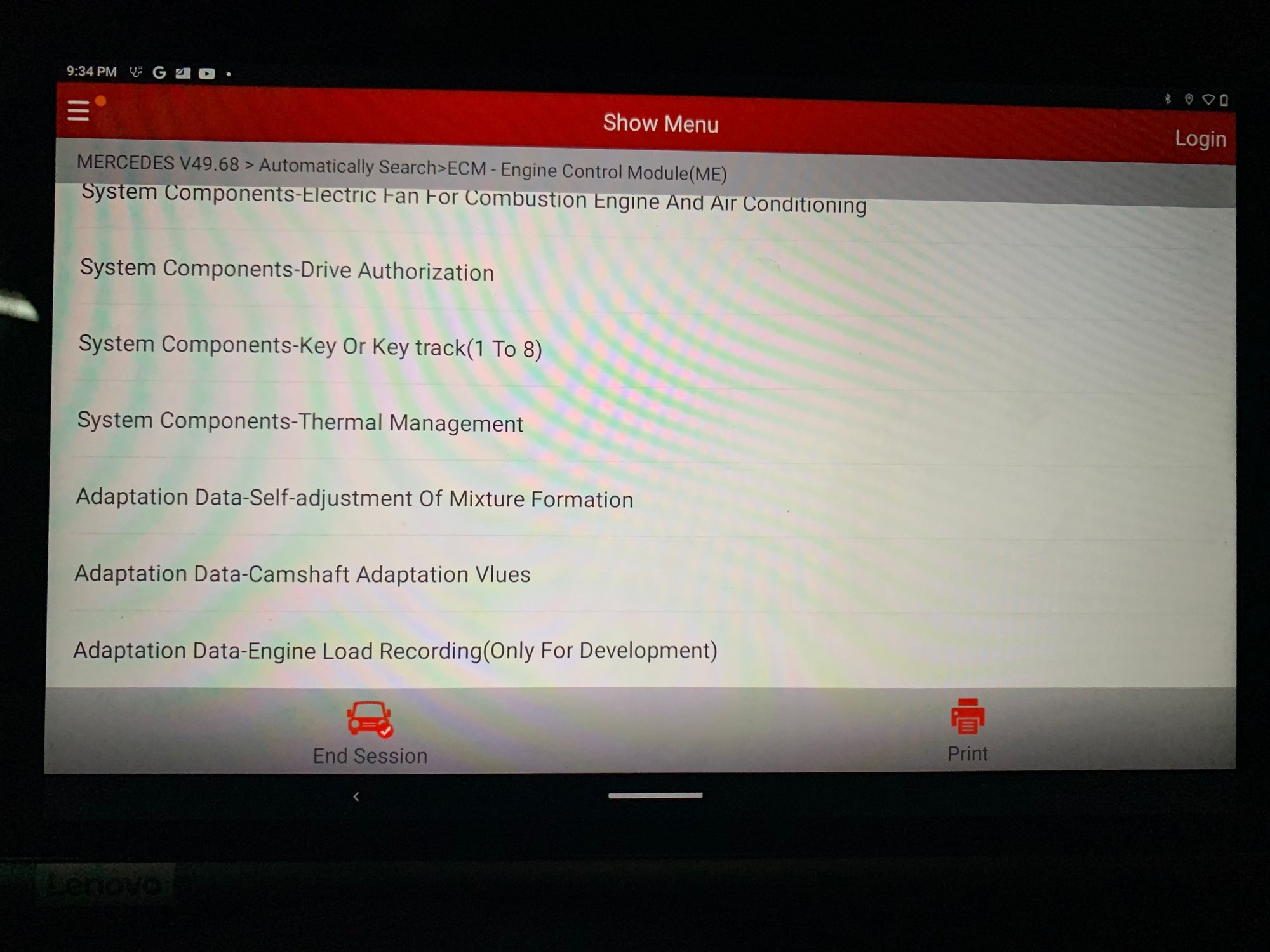

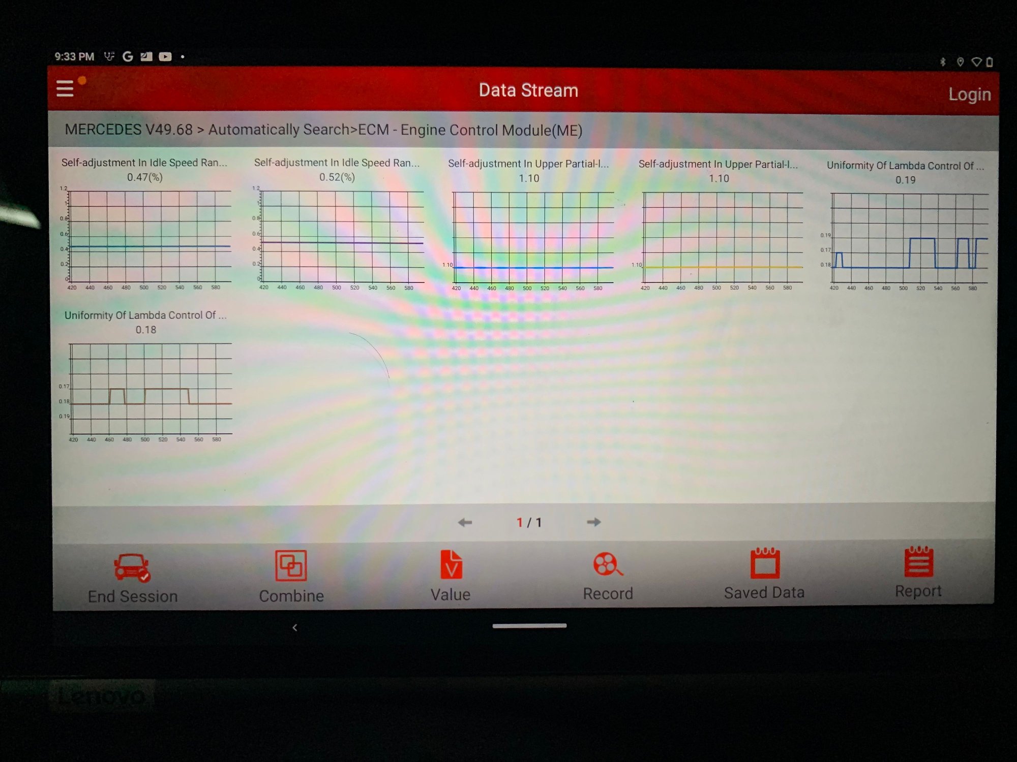

Old Apr 2, 2022 | 08:25 AM
Sltncls63's Avatar
Joined: Apr 2020
Posts: 48
Likes: 13
Cls63 s-amg 2014
My friend there is no short term and long term fuel trims in this software but i think it’s same what i post in first picture but different in name only

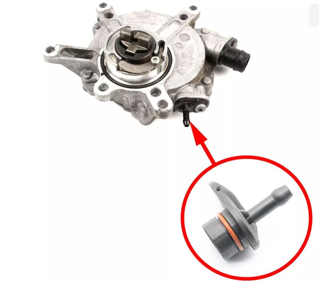

https://m.youtube.com/watch?v=-SFgtu8Zoiw
Solved, The problem was in Vacuum pump Valve everybody keep your eye in this valve always it’s very common problem in M157

What's the part number for the pump?
Old May 11, 2022 | 06:42 AM
Sltncls63's Avatar
Joined: Apr 2020
Posts: 48
Likes: 13
Cls63 s-amg 2014
A 2762300065
Replaced by
A 2762300265

Apparently the company Klifex sells a complete replacement for the faulty part in addition to the diaphragm for those that are interested in possibly not buying the complete pump.
Got it, and 100% confirm that it's the right one.

Did you try sucking and blowing on it to make sure the membrane works?
I purchased one which didn't work.
Old May 27, 2023 | 06:16 AM
WANTED!!'s Avatar
Joined: Oct 2013
Posts: 745
Likes: 139
14 E63, 05 E55, 03 Evo 8, 08 F250, 06 R6R, 92 Talon TSI, and instability
I did. Worked perfectly fine.
