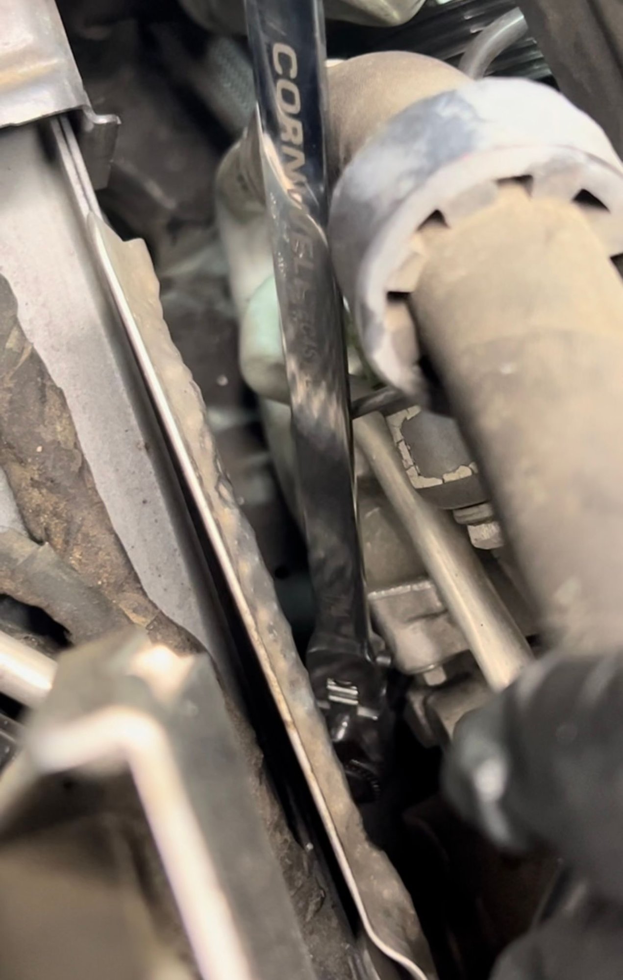

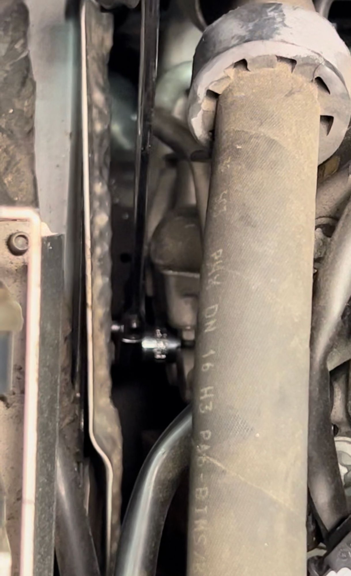

You won’t be able to get it over the bolt due to tight spacing. The issue we ran into is the socket + ratchet made it too tight to back the bolt out. It did not allow us to pivot the wrench over the bolt because of how long the socket was. So we had to shave the socket down to make it shallower. The issue I think you’ll have with an box wrench is that it not going to clear the lines which sit above and below the bolt that’s holding them to the bracket. Basically the bolt is recessed between them in a cavity of sorts. The socket comes out past them giving you clearance to swing a ratchet. You can also use vice grips to hold the socket and remove the bolt that way too if you don’t wanna deal with shaving it down.
Before we shaved the socket
After

Ouch - I see that... okay. I was looking at it again today and I think I am going to leave the radiator hose in place and just pull the fan out for clearance.

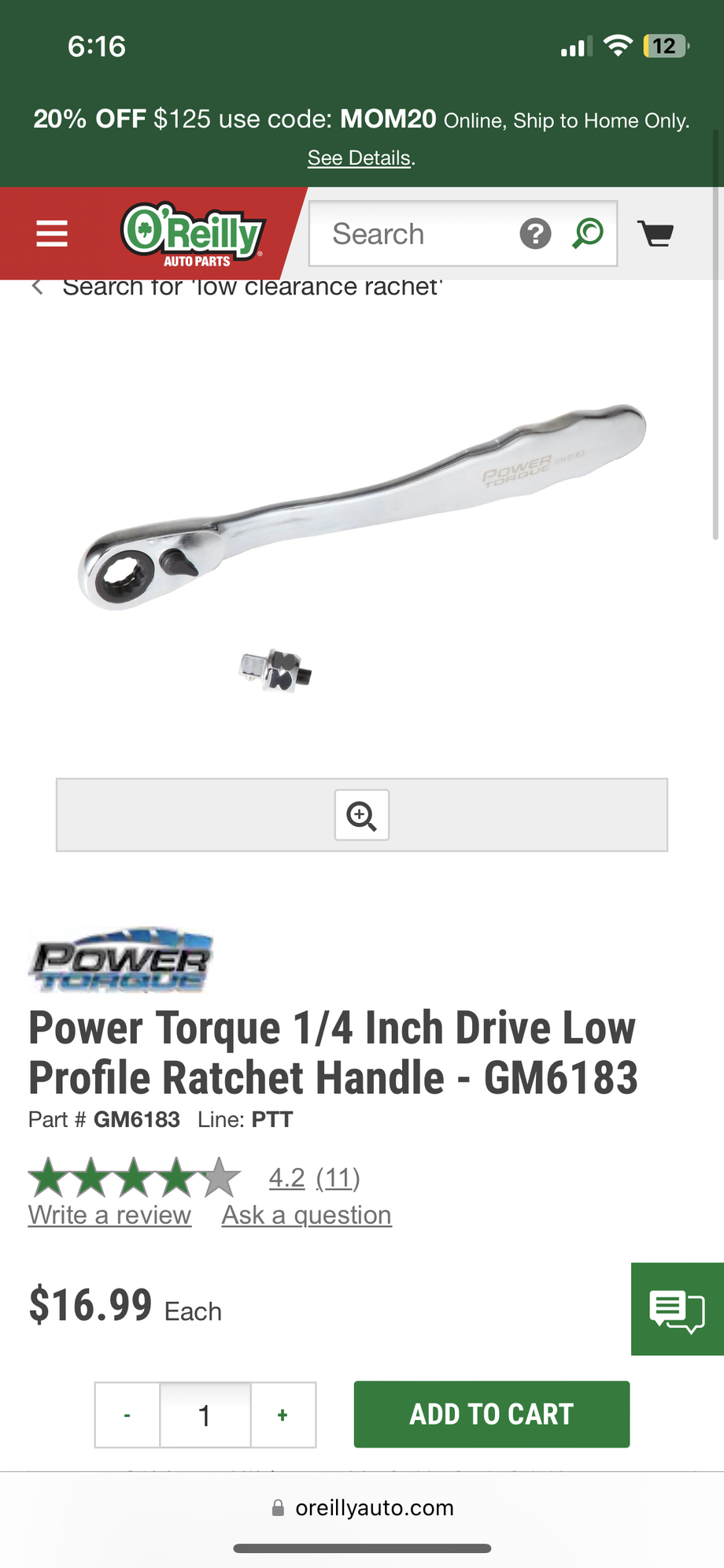

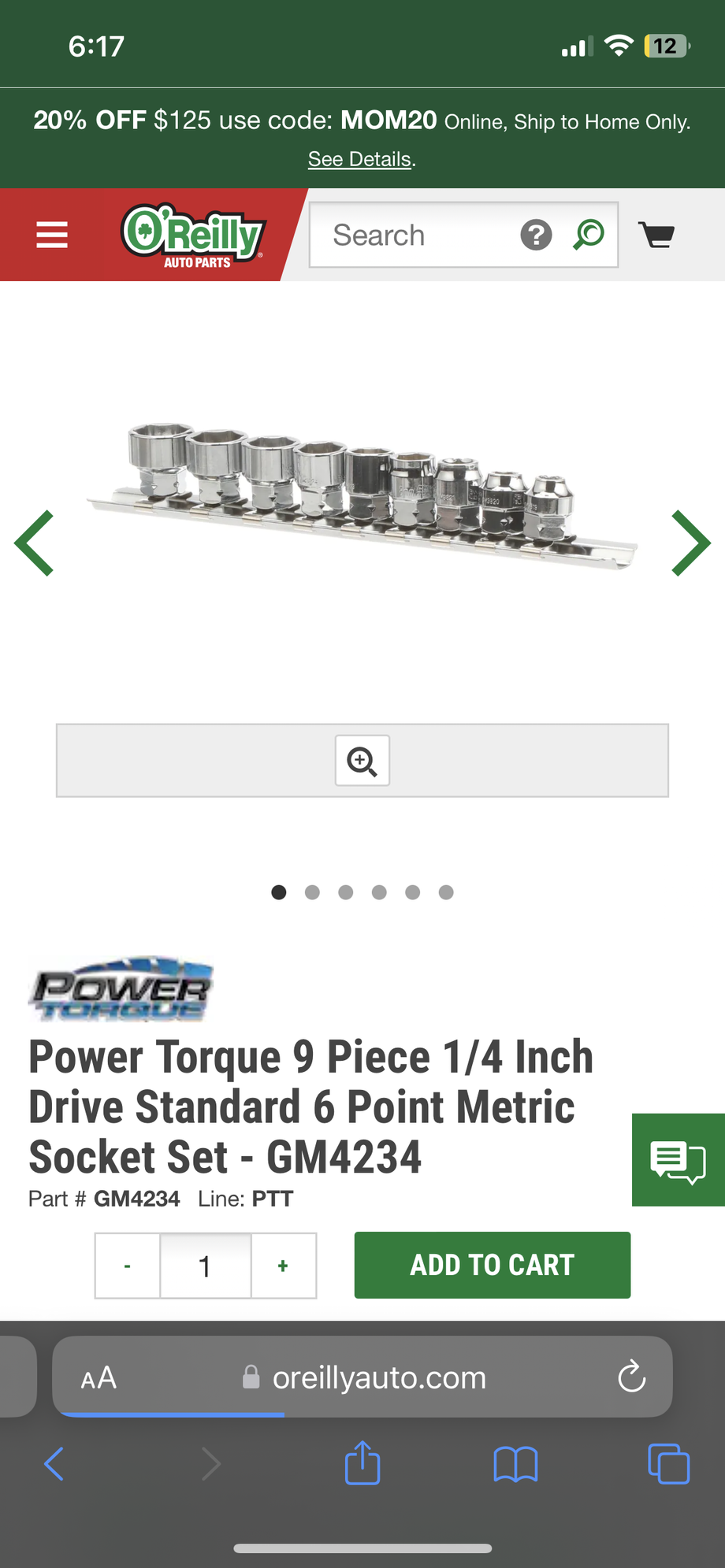

I’ve done this job twice, it’s almost comical how having the right tools will half the job time. The first few tries i welded a shaved socket to a flat piece of metal. This rachet from orielys fits perfectly and makes it a 1 minute removal. I sandwich teflon tape between the bolt and socket to not let it fall off

Just to clarify...are you using this slim ratchet to remove/install the bolt at turbo, or on front of water pump? I have already replaced the water pump and need to remove the broken turbo coolant lines next...
Old May 19, 2023 | 11:56 AM
BenzFan2001's Avatar
Joined: Aug 2021
Posts: 41
Likes: 15
CLS550
I used it for the bolt at the turbo

Bought and used successfully last night, thanks! Now I'm struggling to actually pop the lines out of the turbo! I removed the double line clamp, but these boogers are really stuck in the turbo!

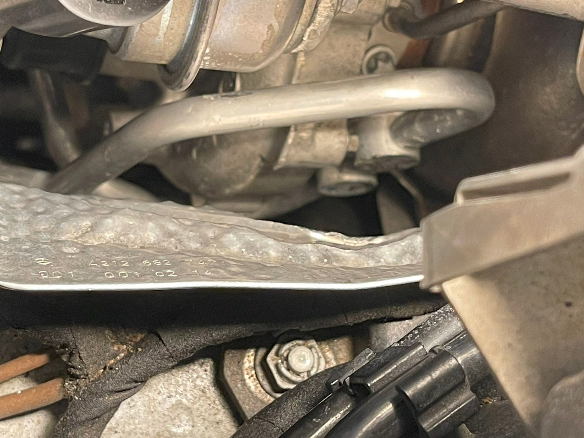

I'm doing this job right now and can't get that upper line to seat against the turbo. The bottom feed line seats snugly against the turbo but the top line doesn't due to that overlapping bolt connector, is what it looks like. How did you solve this issue?

It was really hard to get the upper return line out of the turbo - I had to use pretty good force to get it out. But I can't remember how snug it was up against the turbo itself. Right now, the tightest I can get it is in the pic, and that's using the same amount of force I had to use to get it out. Should that upper line fit snugly against the turbo like the feed line does?

The top one will stick a bit out as it overlaps with the bottom tab. If you look at the lines themselves, the top insert that goes into the turbo is a bit longer.
I finished mine yesterday. Looks like yours and there aren't any leaks from the turbo.

i cant look at my car right now, but if the two plates where the bolt goes through are touching id say send it.

Thanks fellows. I saw that gap and thought when I went to take it loose there wasn't any gap but honestly can't remember. Laying the tube ends side by side with the bolt hole lined up it looks like it would indeed sit in there as pictured, I just find it hard to believe. Seems like they would've built up the top outlet to compensate.. But then again, seems like they wouldn't have made these lines so brittle either.... Thanks - I'm going to send it!
