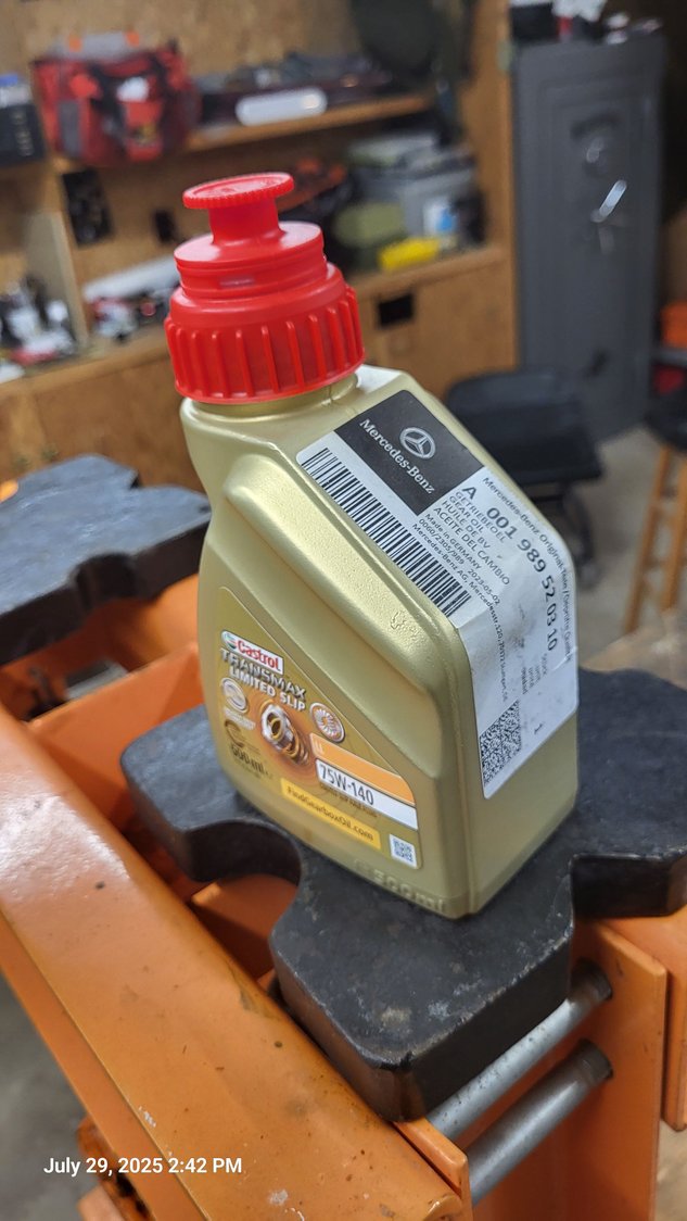

Rear got Castrol 75w- 140 for limited slip. Front got Liqui Moly 85w-90. hypoid.

For some reason mb specifies their mb genuine 75w85 hypoid gear oil for the rear

2014 E63 AMG wagon 1965 Austin-Healey 3000 1970 AMC AMX
S models need limited slip formula.

-Rear-
Castrol 75w140
-Front-
Redline 75w85 gl-5
