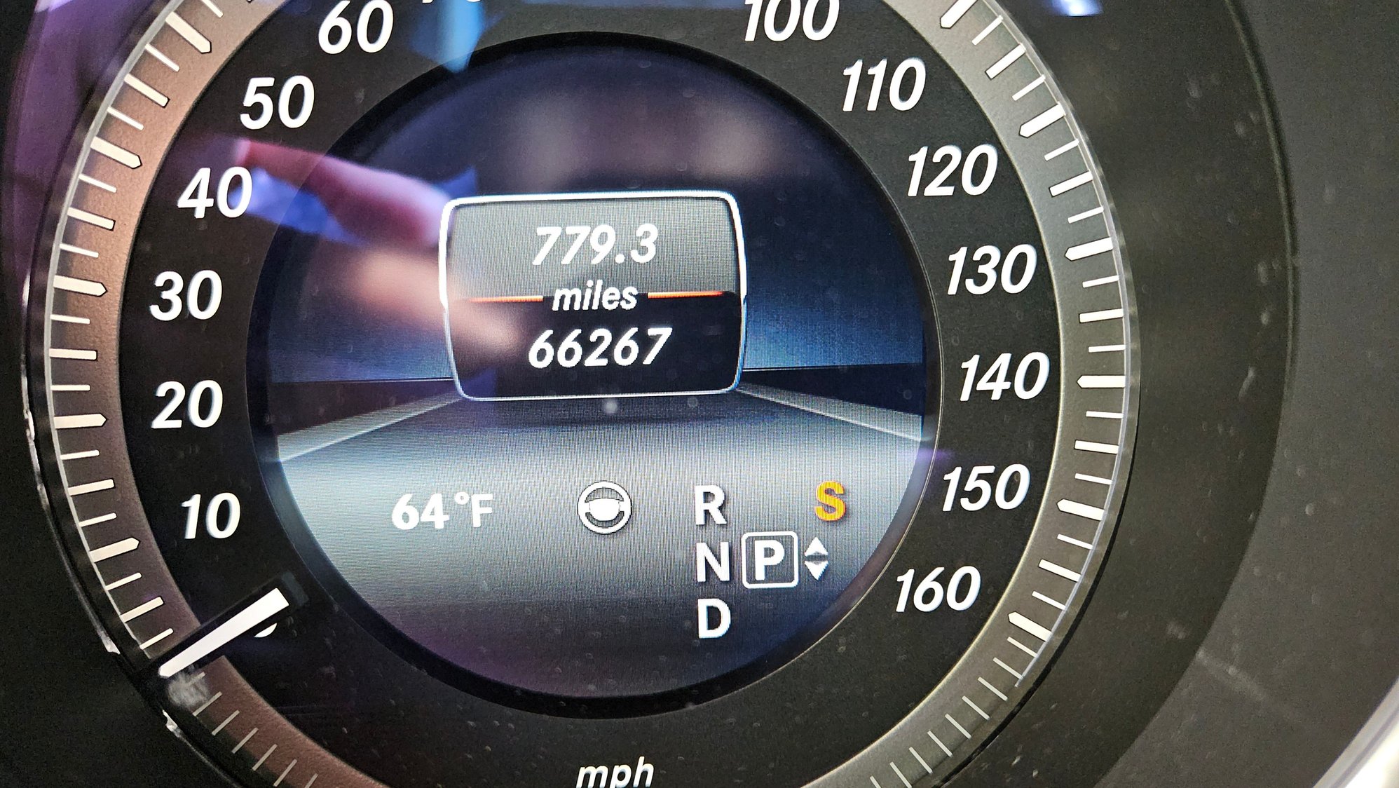

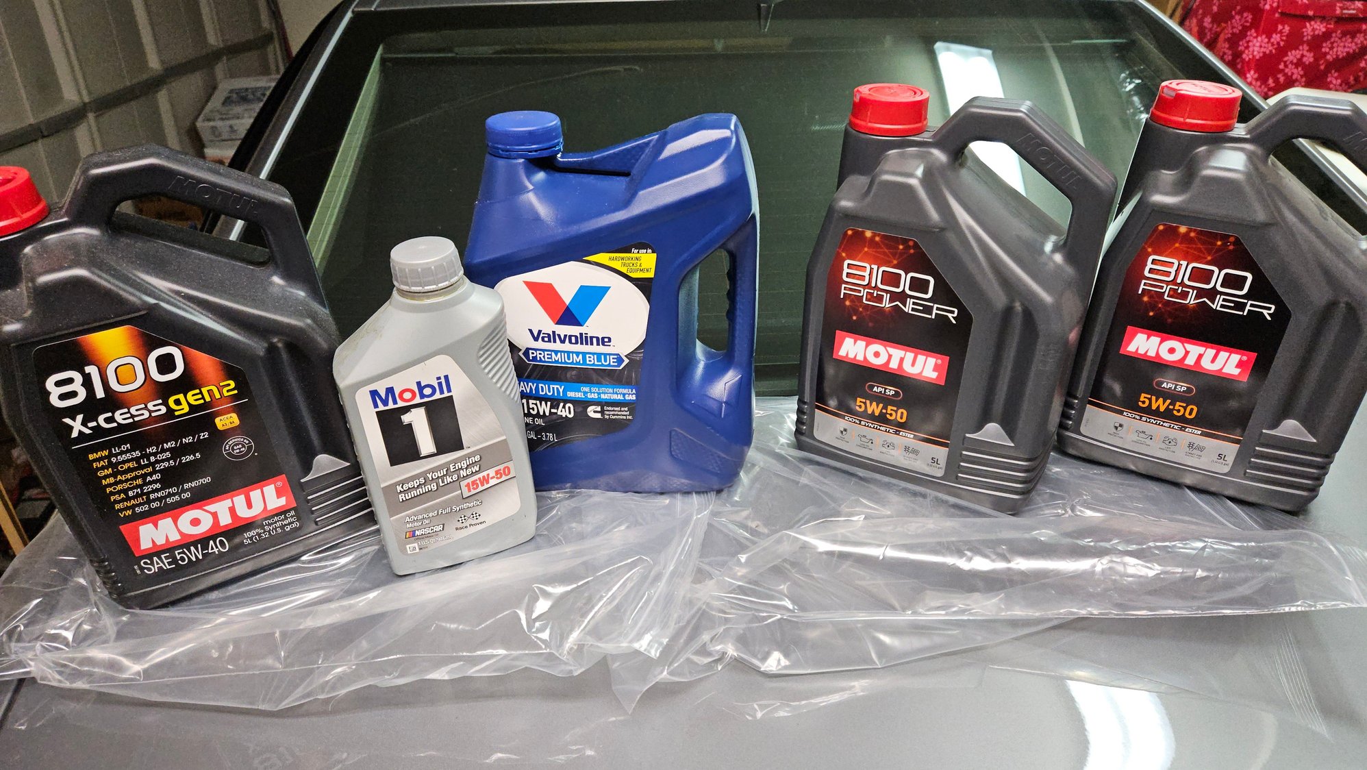

PAST PRESENT FUTURE oils...
Originally Posted by E63SAMG2014
what oil did you use
on your last oil change,
current and
next oil change what will you use?
my answers is :
past and current oils
800Mi on MOT.5W50 👍
800Mi on MOT.5W50 👍
Next oil may be a repeat 5w50 in Motul or a Castrol, Pennzoil, Mobil1 or a 10w50 if viscosity shear on MOT:5w50 is significant.
Every new oil starts great then falls of the clif at some point... Motul has been tought
Definitely within W50 range for sure.
The happy median is to have enough viscosity reserve that it can shade a bit without being to noticeable early.... 4500Mi ok.
I want to drive a stable 0w50 so I begin with a 5 or 10w50 later.
