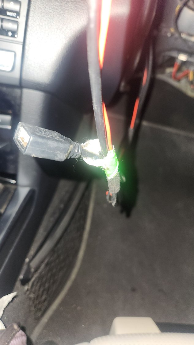

Hi guys, posted this in the e class thread last week with not much response. Does anyone have wiring diagrams for their aftermarket android head unit? Not having music is killing me.

Seems to be an older Android version. Is it the 10.5" screen?
Have you tried contacting the company you bought it from?
If no sound, the stock comand has to be set in the AUX position. This only works if you connected the AUX extension cable from the Android monitor to the AUX out connection in the center console.
The original back up cam can be activated through the monitor. Back up lines too. Those can be turned on or off.

Thank you. Yes, I do have the 10.5 screen. My issue is I just bought the car last week, knowing it had this issue. All the writing and labels on the screen itself are in a different language. I do see a long Aux cable, female USB and a random connector for something coming out of the side of the radio. I also don't see a Aux port to connect to in the center console. Once I start the car, nothing I press on the factory radio does anything to bring up the factory command screen either. Any help would be greatly appreciated.

I have an Apple CarPlay system and no experience with an Android system but here is something worth trying to see if it works.
On CarPlay, to toggle between the factory MB system and the CarPlay system, I press and hold (for 2-3 seconds) the “Hang up” button on the steering wheel or the “Back” button on the center console.
Maybe that works similarly on an Android system.
Good luck!
