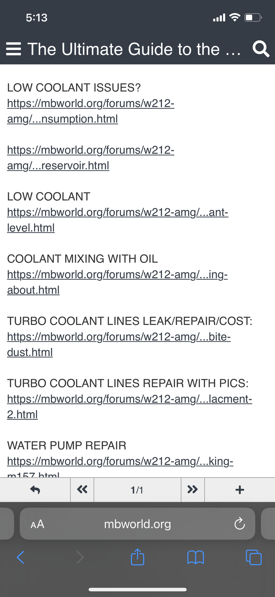

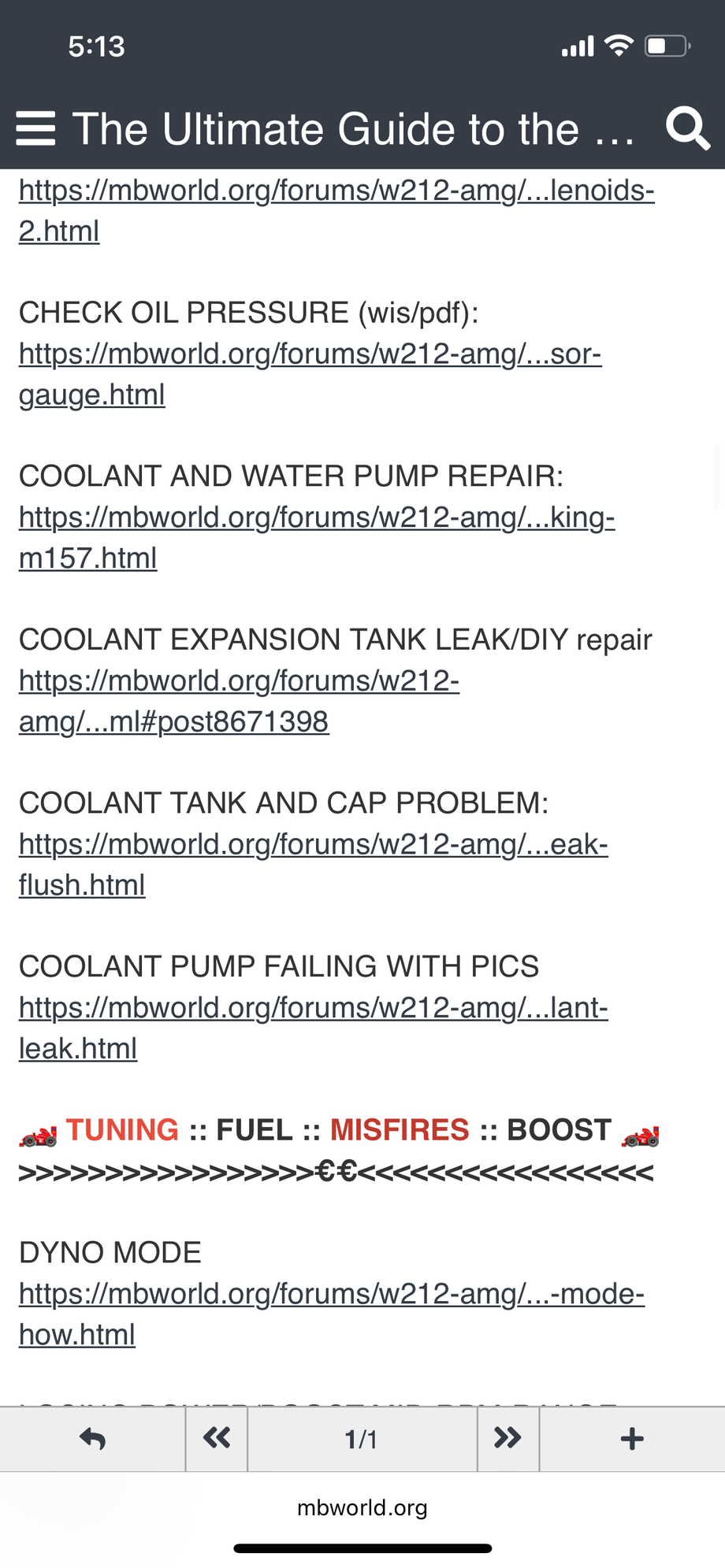

Lots of info from links in the sticky:
https://mbworld.org/forums/w212-amg/...2-amg-e63.html
