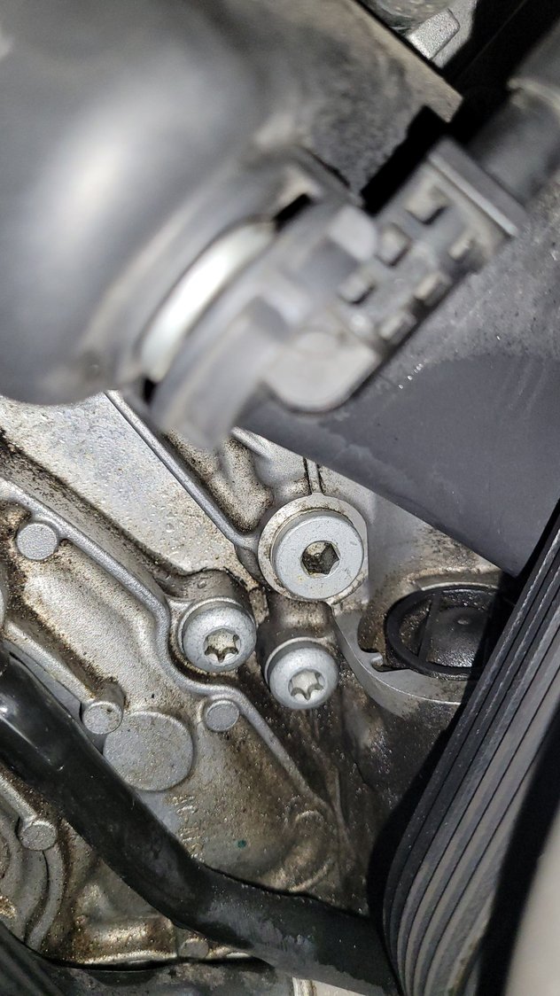

Once again, like I said about. I don't recommend this. It's completely a pointless endeavor.
But if you are determined to do this, you would pump it into the place where you would put an oil pressure sensor. There is a 6 mm Allen plug on the oil pump housing.
That's where the factory says you can hook up a mechanical oil pressure gauge, meaning that is in the pressurized side of the system. So if you were able to hook up a pump to that port, and pump oil in, you would prime the motor
