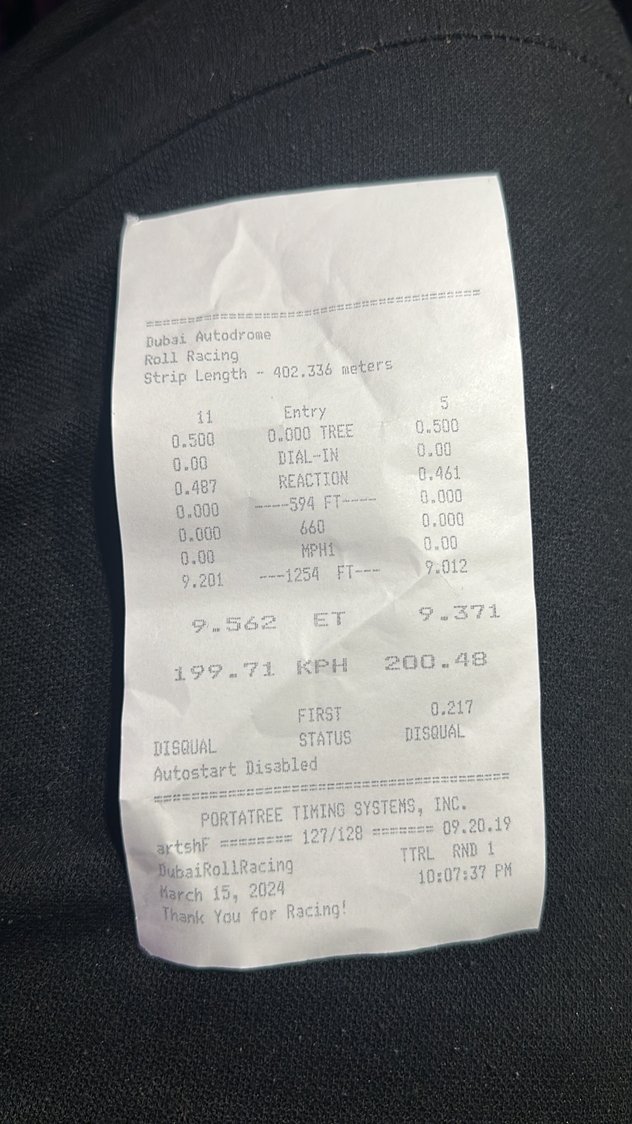

Hey guys , I own a w212 e63s , and was wondering what upgrades to do next on my car. So far i have a stage 2 tune , downpipes , blackboost intakes , hks spark plugs , and csf radiator and turbo coolers. I took my car to drag racing and did 1/4 in 9.371. What other upgrades do yall recommend to do to maybe get it faster ? I live in a pretty hot place hence the csf radiator and turbo cooler , I also get a very hard clunk while shifting manually from 2-3 gear. What do yall think ? Thanks in advance

Heres my best 1/4 so far and yes i do have oem turbos
This race was againts a c63s stage 2 aswell

so you're only trapping 124mph? (200kph)
something doesn't seem right if you're doing 9.371 in the 1/4 ... also it says roll racing... you started from 0 mph?
I've never heard of a w213 amg with stock turbos doing sub 9.5 in the 1/4 let alone w212 amg with stock turbos, you're the first.
please elaborate on your stage 2 tune - 93 or 100 or 110 octane? Ethanol tune?
do you have a tcu tune? If so what are the limitations. Are you running meth? NOS? Tell us more about these turbo coolers please
2-3 harsh shift - making the power you would need to pull a 9.3 in the 1/4 you likely are shocking the drivetrain, consider clutch packs in the trans or a bad conductor plate. Also if you have a tcu tune they may need to increase the line pressure for firmer shifts and this could lead to harsher shifting .. so many things To consider hard to know where to begin.

Dubai roll racing starts at 40 kph.
and there it is
