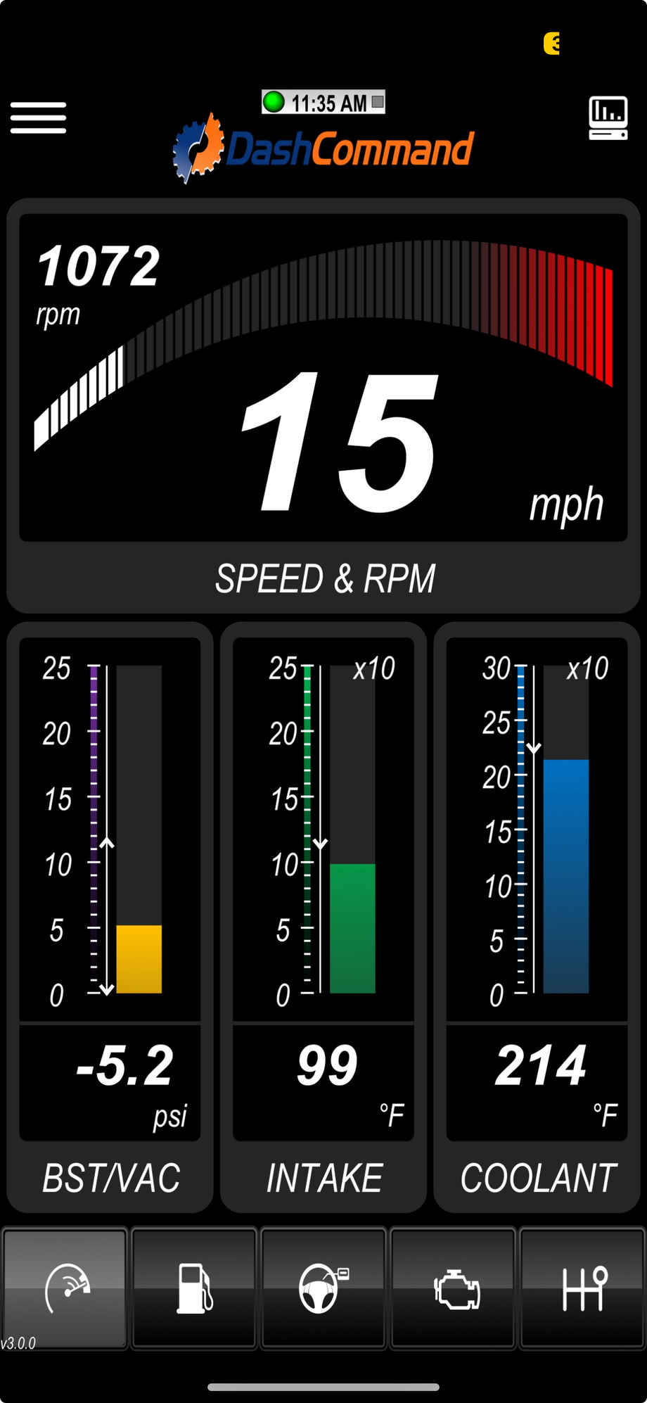

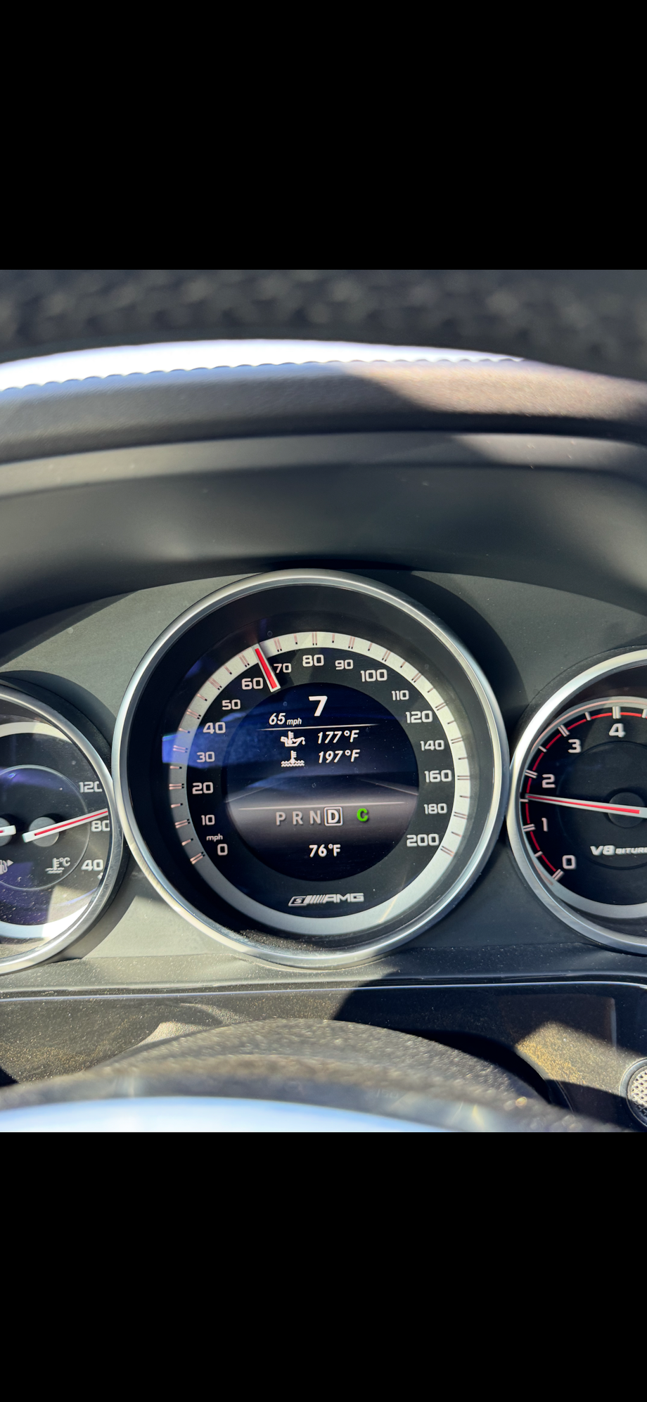

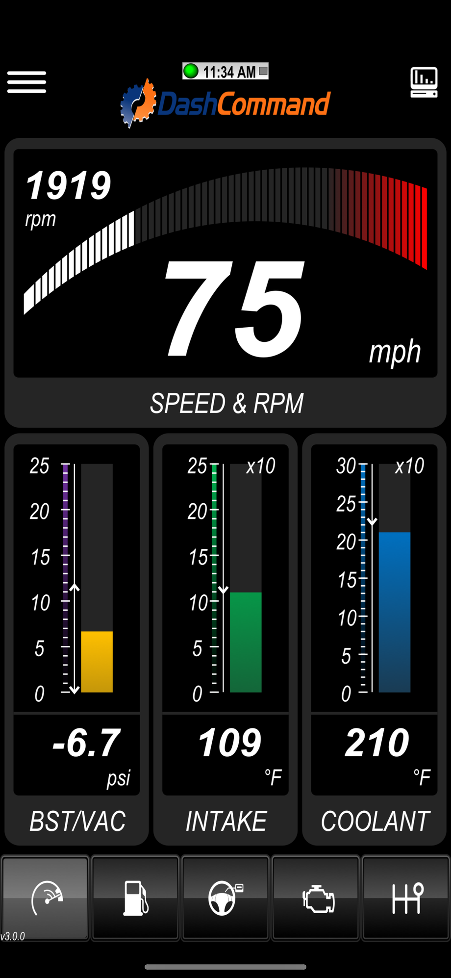

Thanks for the info Peter and I’ve seen the video contemplating doing that small mod too! Here are my logged IAT’s today with descriptions, does it look normal?
Cruising on highway 76 degrees outside
After it hit 113ish dropped down to 99 and fluctuated up and down there. Seems that’s when the pump turns on
After it hit 113ish dropped down to 99 and fluctuated up and down there. Seems that’s when the pump turns on ( stop and go traffic on highway)
Oil temps etc
Oil temps etc
Oil temps etc
Oil temps etc
looks good
