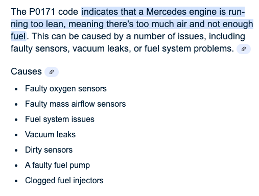

Before I go digging into the car or get time that is, just wondering what are some common places for vacuum leaks that could cause this lean condition. When coldish the ltft start at around 6-8. and once warm get upto 16-18. close to setting a check engine p0171 code. Its not quite there yet but i think it may be on the horizon. Do the pcv fail on the m157 similar to some other european make and models? do they have a similar effect and cause lean conditions and lean codes? let me know if anyone has ran into something similar. car has 78k miles now.
