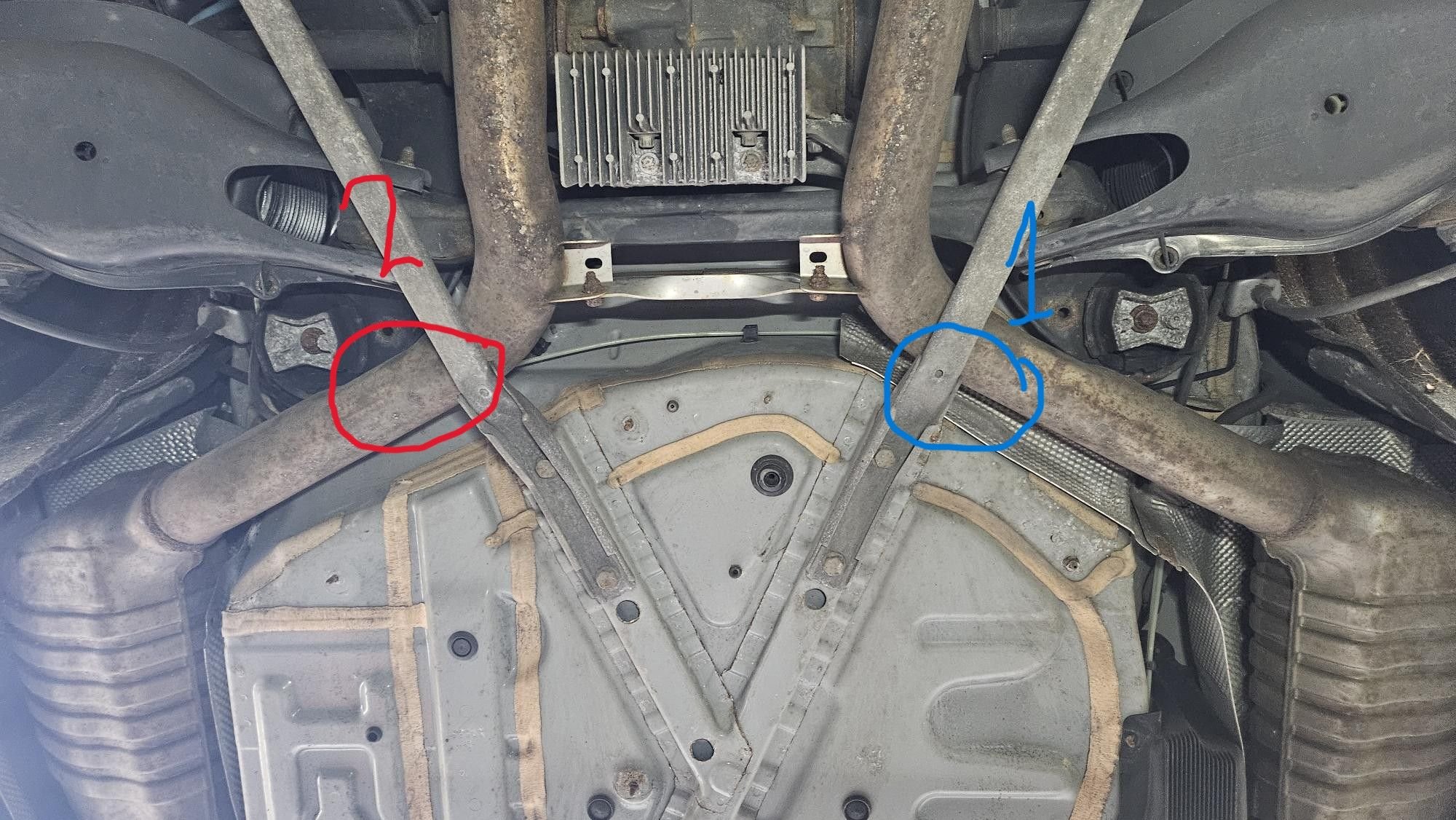

Update - other side went as well!
4 months and 600 miles later, move the car from one garage bay to another. When parking I hear a loud hissing again. WTF? Still from passenger side. First though - well - good I bought that air spring from FCP - will have to replace a faulty one.
But after checking - no - it was the same high pressure line, but this time on the passenger side! Looking at car from bottom, this is what I mean. 1 is the location of first leak, 2 is the new one. Note that I have here removed the plastic cover underneath the spare tire well and the passenger side exhaust heat shield. The high pressure line goes between the heat shield and the car body.
Repaired it the same way as last time - using a $20 coupler. Looking at the high pressure (hard plastic) lie, a slight white tint could be seen. Ignore the black marking - that is my mark to easier find it after I had located the leak.
After it being removed from the car, you can see the actual crack in the enlarged picture.
This happening twice in the same (but mirror image) location felt unusual. When looking at the car, I saw that there is a tiny piece of leftover steel right where the leak was. Exact same location as on the first leak (but again - mirror image). For some reason this tiny piece of metal is left from the factory and over time there is a tiny bit of rust as well. increasing its size. The plastic line is likely about 10 cm or so too short and hence rubbed against it instead of floating above it.
For anyone else doing their air springs - take a quick look at the line, may make sense to replace it at the same time!
