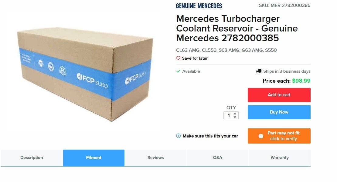

@RVAE34 One part I didn’t see in your very thorough list is the expansion tank. It looks like you already have it out, and in my experience it’s one of those “not if but when” items. Since you’re already deep into the cooling system, it might be worth doing now. FCP has them for around $70–$125 depending on the version.To that end… and I don’t mean to hijack your thread… I’m probably about to follow the same path because I’ve had a string of cooling-system issues pop up recently. I’m at about 57k miles, and back in mid-October, after about an hour of driving (with some of that being a bit spirited ), I noticed my oil temp suddenly drop into the blue for several minutes. A week or two later, I got a P0128 code. I cleared it and it hasn’t come back yet, but I’m assuming the thermostat is on its way out.
Then last week I got a “Check Coolant Level” message. When I went to investigate, I found some crusty dried coolant along the side of the expansion tank. I rushed to order one during the Cyber Monday sale and it just arrived from FCP, so I’ll probably be replacing mine this weekend.
I also found that my intercooler reservoir needs to be replaced, but FCP doesn’t seem to definitively list an intercooler-loop expansion tank for the W212 E63S. I think it’s the one below… it shows compatibility for other 5.5 TT M157 motors (S63, G63, and CL63) but not the E for whatever reason. I may just buy it and return it if it’s not the correct one, but I suspect it is.
So again, in the near future I’ll likely be doing exactly what you’re doing. If you can supplement the info already floating around with any lessons learned or tips from your teardown, it would definitely be appreciated.
Good luck!
