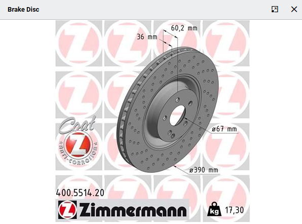

I am getting ready to replace the rotors and pads on my 13 CL 63 (C216). I know this is an E63 forum, but you all have the experience. Obviously, I could go stock, Brembo does not list a set, but Racing Brake and Giro Disc have the parts. Giro Disc does not have the front pads. These are the odd two caliper front brake system.
I am not interested in changing calipers. Reasonably sure they are 390/360 mm but do not know anything about offsets or thicknesses.
I would appreciate your thoughts.

Thanks for the replies. This is a CL, think S coupe. The fronts are 390mm. Zimmerman only has fronts, and they are not two-piece. FCP was Zimmerman (front's only), Mercedes and a SHW brand. Brembo does make pads and could probably find a disc that would fit. The pads are out there but thinking about a matched set with the rotors. I just started looking, so I will continue my research. Thanks again.
