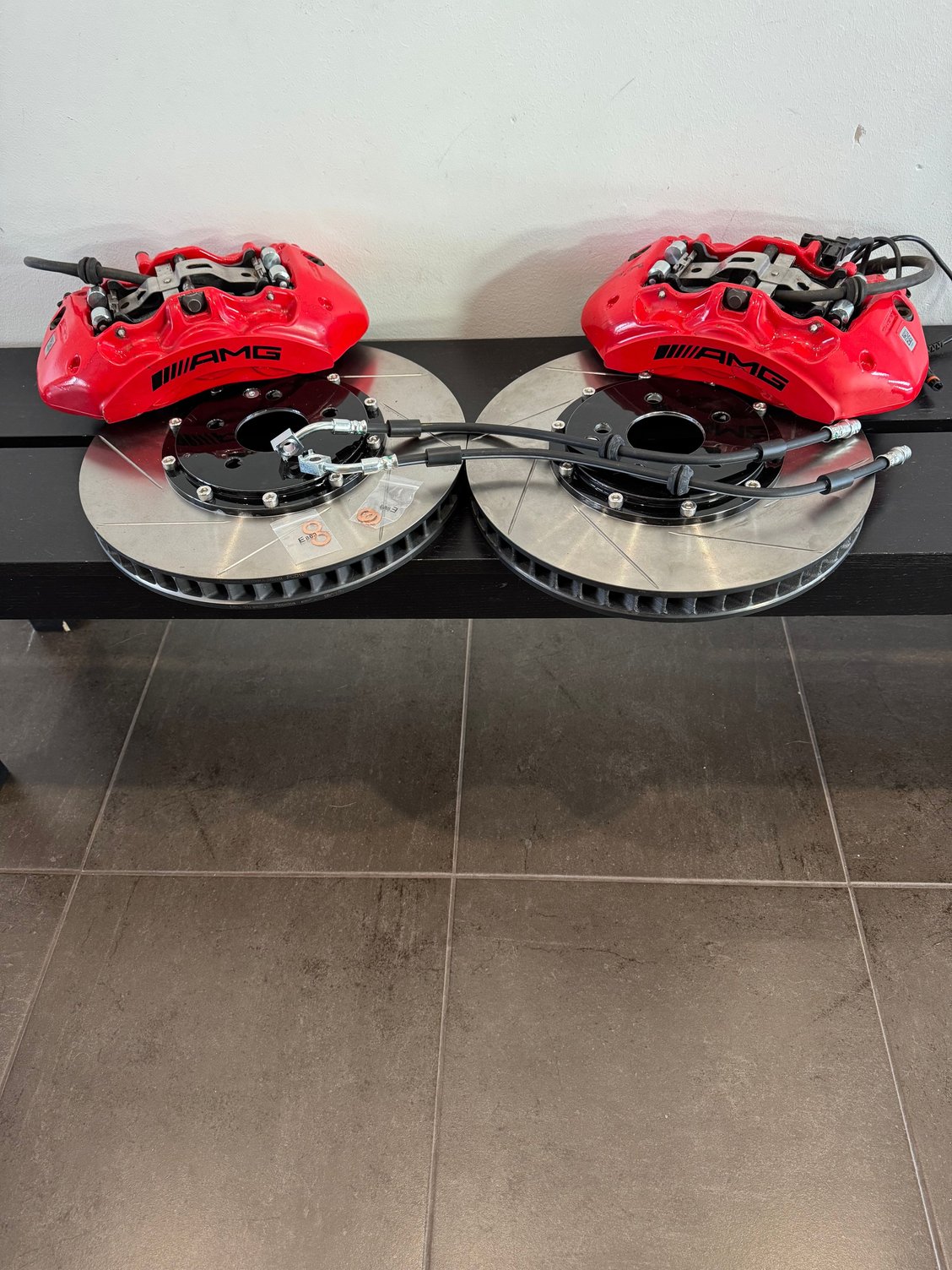

excellent! Are you currently in the process of rebuilding the caliper shown in picture?
No, those are mine. I have rebuilt calibers and those are light weight performance rotors with custom "hats". I will upgrade my cars front brakes. I have a built topic in cls218 coupe section. There is more stuff about this brake job and also other upgrades etc. if you are interested to see.
