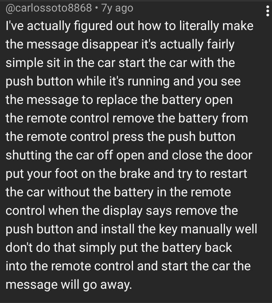

You'd expect the fault to clear itself with a good fob battery installed... not so quick!
The firmware requires a MANUAL RESET to clear low fob warning.
There is a weird service procedure to clear that. See youtube vídeo... I don't quite remember (key cycles On/Off/On) - I use CR2032 that last many years like most Jp cars.

how to clear...
here is the weird reset procedure to clear warning msg:
fob warning clear
fob warning clear
enjoy MB ergonomics
