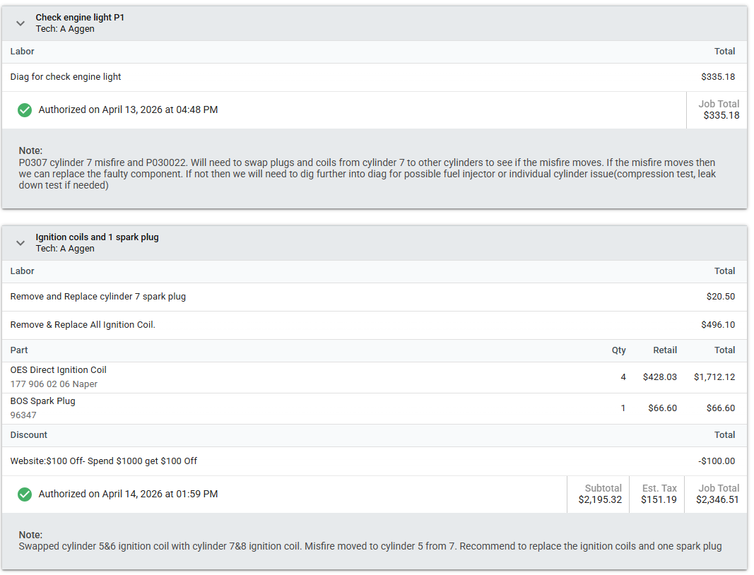

Update - see screenshot
It was the ignition coil that failed causing cylinder 7 to miss fire. Apprently spark plugs were changed only 6K miles back so I ened up changing all the coils. Warranty covered a little bit and my net out of pocket was 2440.
Got the service A due in July

Invoice details show only HALF the 8 coils got replaced, right?
QTY 4Pcs
QTY 4Pcs
Keep that record in mind.
QTY 4Pcs
QTY 4Pcs
Mechanic said only 4 coils are needed for this V8 because engine is split in two banks 2 per 4cycl on each bank. Dont know what that means but ChatGPT seems to agee

mixed new coils
Your two banks of coils fire up as follow:
M177 firing order: 1 - 5 - 4 - 2 - 6 - 3 - 7 - 8
The timing of both banks are mixed together :
Bk1 Bk2 Bk1 Bk1 Bk2 Bk1 Bk2 Bk2
With 7 years difference old vs. new coils put out different high voltage. That ignite with slightly different delays. That is ok but not best for ECU timing work. New coils will fire a hair sooner than older ones. ECU will adapt to engine.
The rational is you shall be replacing remaining over heated coils within a year or two and you better match exact same one, not just new ones.
Retail M177 MB.coil : $428 Ea.
At that price point... don't worry mixing old + new coils. It is done everyday everywhere - A common practice.

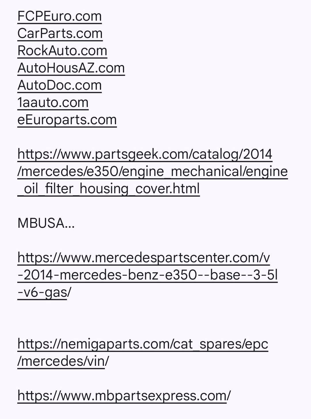

Here's my go-to list in no particular order:
trusted supply-chain suppliers
trusted supply-chain genuine parts suppliers
Do you know other good suppliers ?
(I forgot "ECS Tuning" in my list)
$3,400 + Tax for 8x bare coils wakes up creativity.

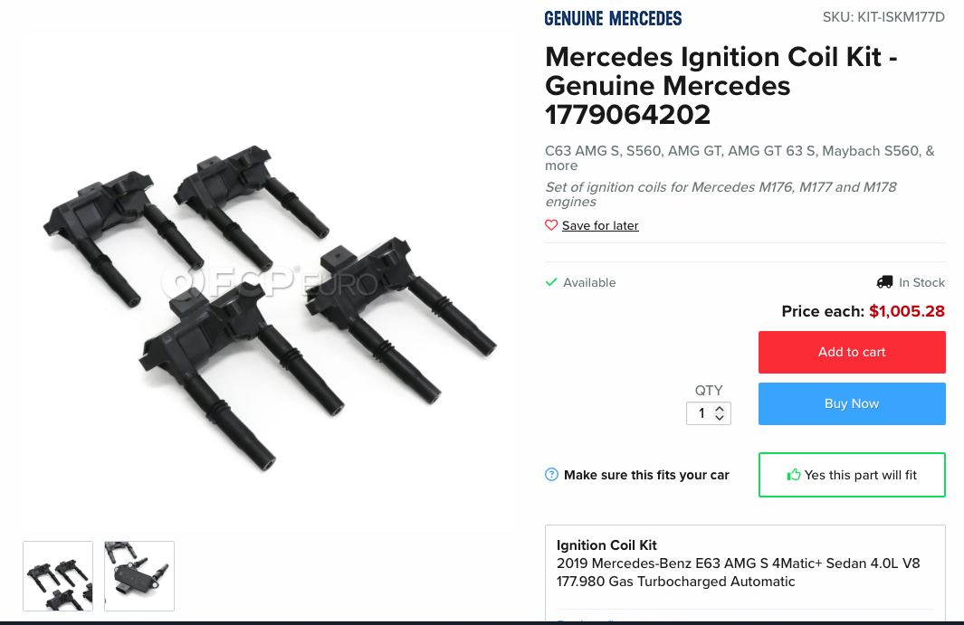

Old Apr 17, 2026 | 08:29 AM
PotatoHeadII's Avatar
Joined: Mar 2026
Posts: 118
Likes: 50
Here’s the problem with owning a Mercedes: Either you don’t care how much it costs to own, or you learn to do stuff yourself. Lots of people think that if you own a late model Mercedes, especially an AMG car, you fit into the first category. Always, always, always ask for a detailed estimate up front. Then, do some homework. I know it is easier to have everything fixed at once, but you will pay for the convenience.
From FCP’s website, it appears a single coil assembly supports two plugs. I don’t know the complexity of swapping out coils on your engine, but certainly you were screwed on the price for the coils. I would get a quote from the Mercedes dealer for the parts.
The “good news” is that it appears all of your coils assemblies (4) were replaced.
Old Apr 17, 2026 | 08:33 AM
Joined: Mar 2026
Posts: 118
Likes: 50
The FCP price of $1005.28 is for a set of 4 coil assemblies. Each coil assembly is $251.32

Strong Ignition Setup
That's very good news! OP has ALL new ignition !
DUAL COILS...
M177 only has 8 plugs, not 16 here.
The coils are dual-in-one package.
(Not legacy "wasted-spark" in exhaust).
PARTS SUPPLY...
The high parts mark-up is usual cost of repairs.
Wholesale: $1000 only for 4x genuine MB
Imagine cost of OE units...
Bottom line is great reliable ignition for balanced cylinders output. The pro hooked you up with nice gear.
@potatohead
Thank you for digging into this.
You came up with important info on total count & cost for MB Genuine parts.
These complete kits are gonna be great purchased with free lifetime warranty exchange.
