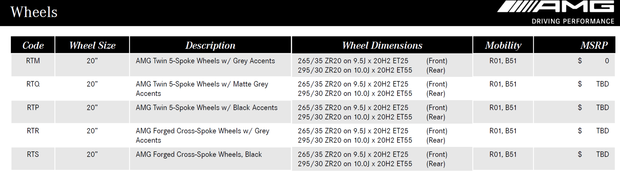

The DOG has offsets for the 20" wheels on the E63S.
265/35 ZR20 on 9.5J x 20H2 ET25
295/30 ZR20 on 10.0J x 20H2 ET55
What DOG? Can you post it?
There is an updated 2/1/17 DOG in the AMG Private Lounge forum, which is for MY 18 and has the E63 Sedan in it.
Thanks man... yeah, it looks like 20" only:
