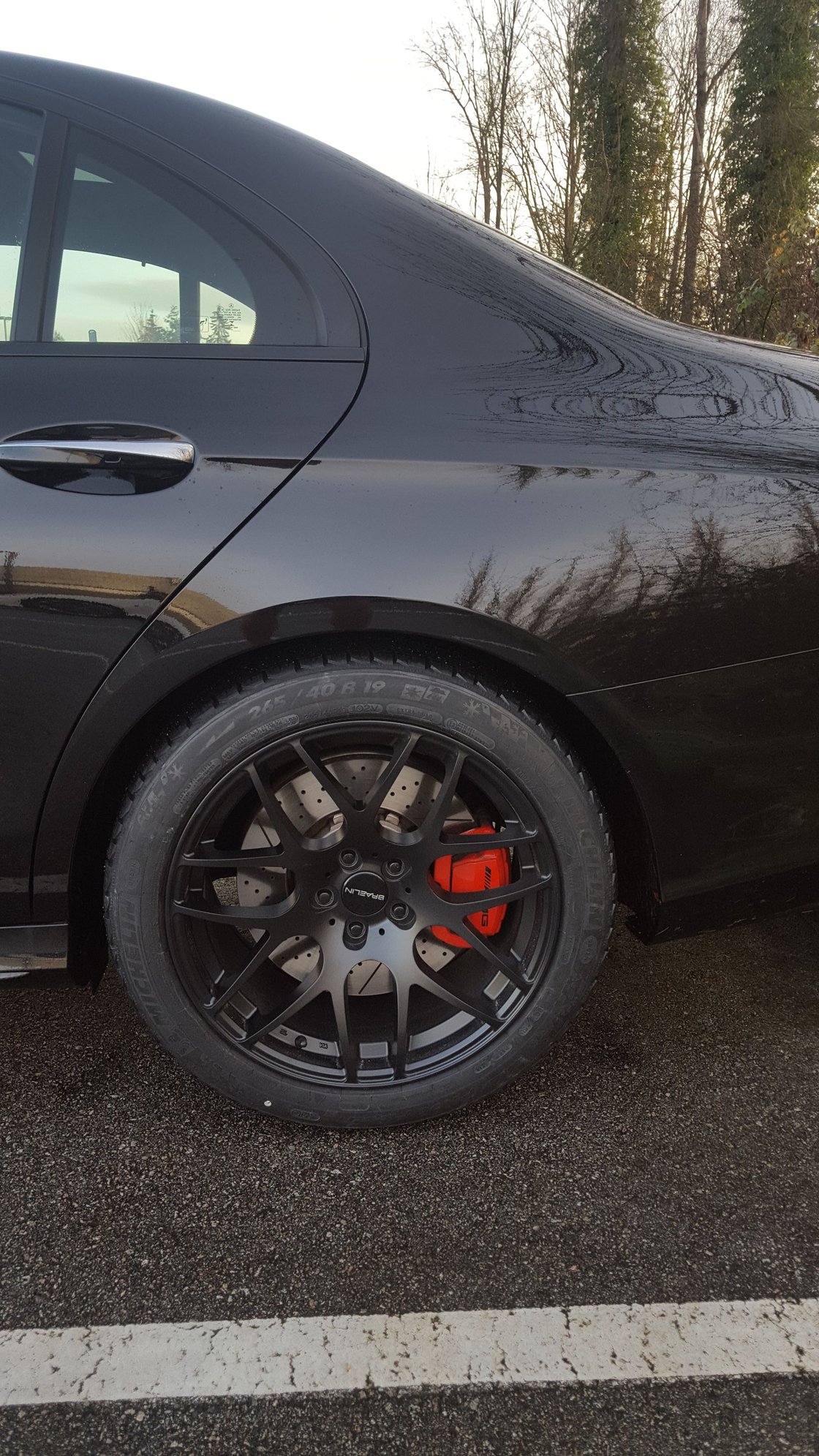

Finally have the Michelin PA4's 265/40/19 with the Braelin rims installed!
They look good and ride great. Big thanks to bobblehead for all his feedback and advice!

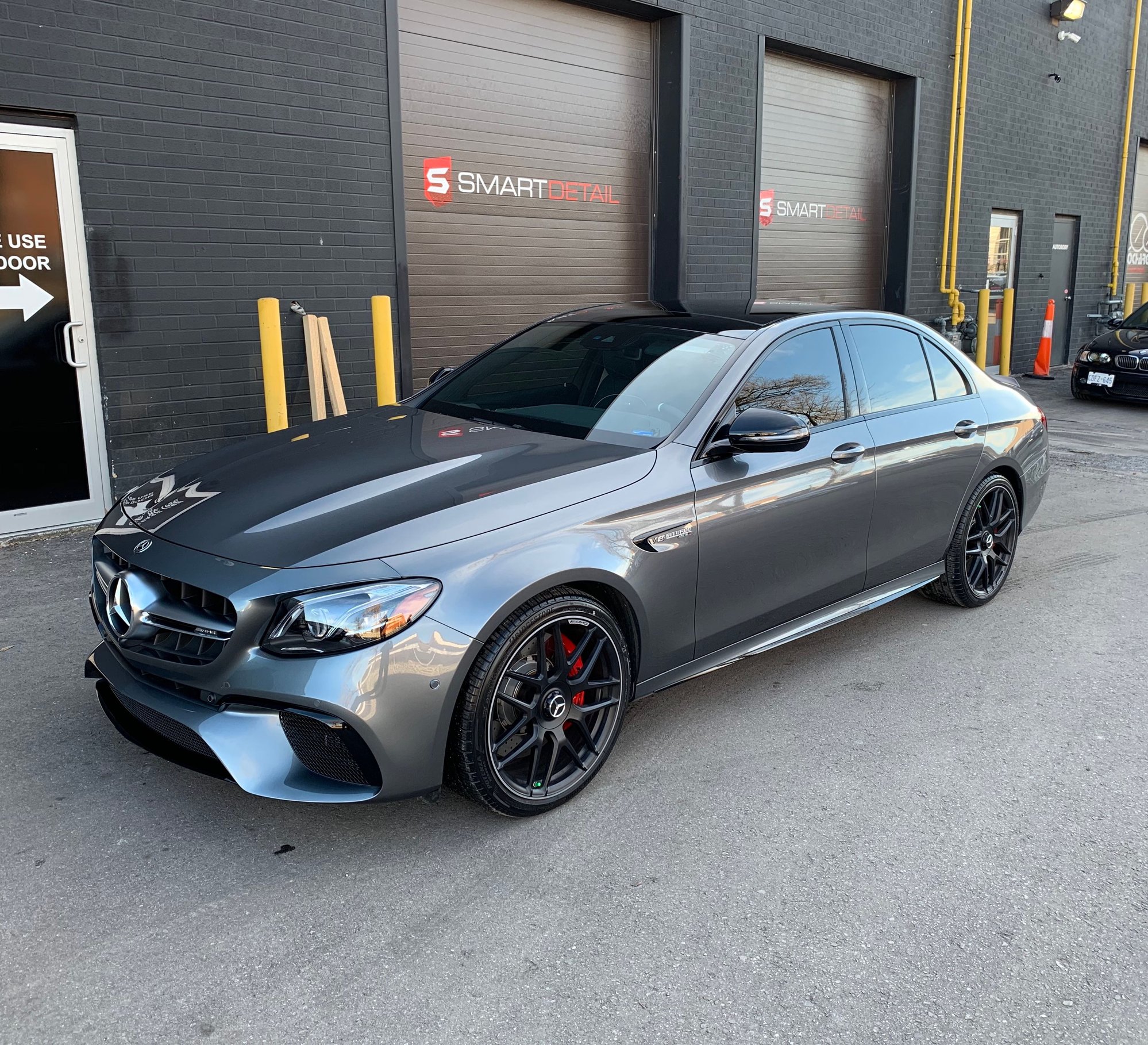

I went with 9 inch wide wheels as recommended by Tirerack, for the 265/40/19 square set up. Not the best pic - weather has been crappy and I have only had the car for just over 1 wk,...

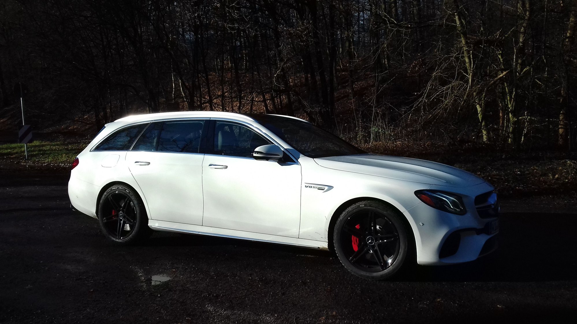

I'm driving in real winter conditions (Longyearbyen, Svalbard). We have ice and snow all winter (from october until may)
Do they allow studded tires in Canada? In that case I would go for the Nokian Hakkapeliitta 9 studded tire. Really just the best winter tire I've been using ever.
I'm using 255/40-19 on my E63S
