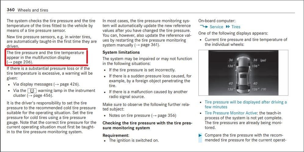

Interesting. So is there a 2nd sensor in the brake caliper to register temp data and transfer that to the TPMS?
I was told by the MB peeps the dash temperature is for brakes and at a track day I was seeing temps over 220F which I can’t imagine tires would be too happy about?
My display shows tire temp, not brake temp.

The car doesn't show you brakes temperature at all. This is another "cool story" from people who are enjoying to make "cool stories" about their cars.
The temperatures on gauges clutch are temperatures in the tires.

BTW, 225F is not unusual for tires to reach on a track. Under similar circumstances, rotors can approach 1000 degrees. 800 is common for metal rotors.
