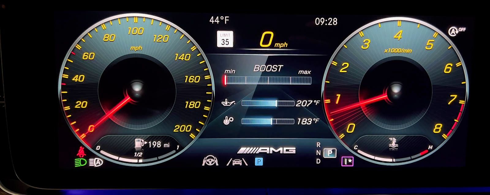

Cold night, temps after highway driving (hence estimated 400mi range per full tank of gas)
