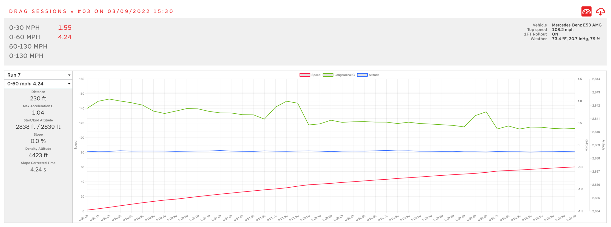

For the TLDR in the group, the simple answer to the question is, there is NO 0-60 mph time differences in modes.
My best 0-60 run was in COMFORT MODE @ 4.24. But the worst was 4.28. The average was 4.27. I could continue to record runs and end up with 4.2x each time. The determining factor was the slight wheel spin at launch. The COMFORT MODE hooked up the quickest. I tried running a RACE MODE with TRACTION ON and I consistently got 4.44 +/-. Take it for what it's worth, but I can choose any mode with my car, take traction off, hold the brake, rev and go and I'll get a 4.2x time at this altitude. I am sure I could probably get under 4.2x a lower altitude and 94 octane race on a drag track.

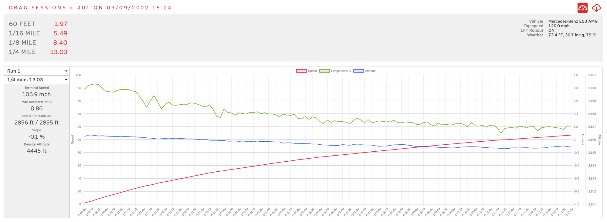

As far as 1/4 mile goes. I ran one run (really not trying) @ 13.03 second w a trap of 106.9 mph. I am positive I would break in to 12.8x range. Even more at sea level.

COMFORT MODE TRACTION OFF (1.55 / 4.24)

COMFORT MODE GRAPH 0-60 mph
RACE MODE TRACTION OFF 1/4 mile

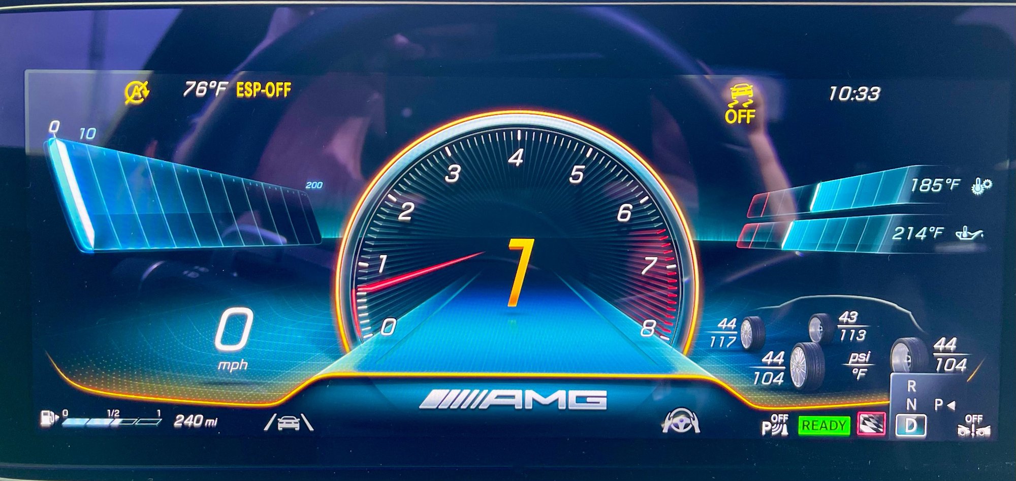

Dash with RACE MODE icon. The steering wheel dial also shows a read flag graphic.
