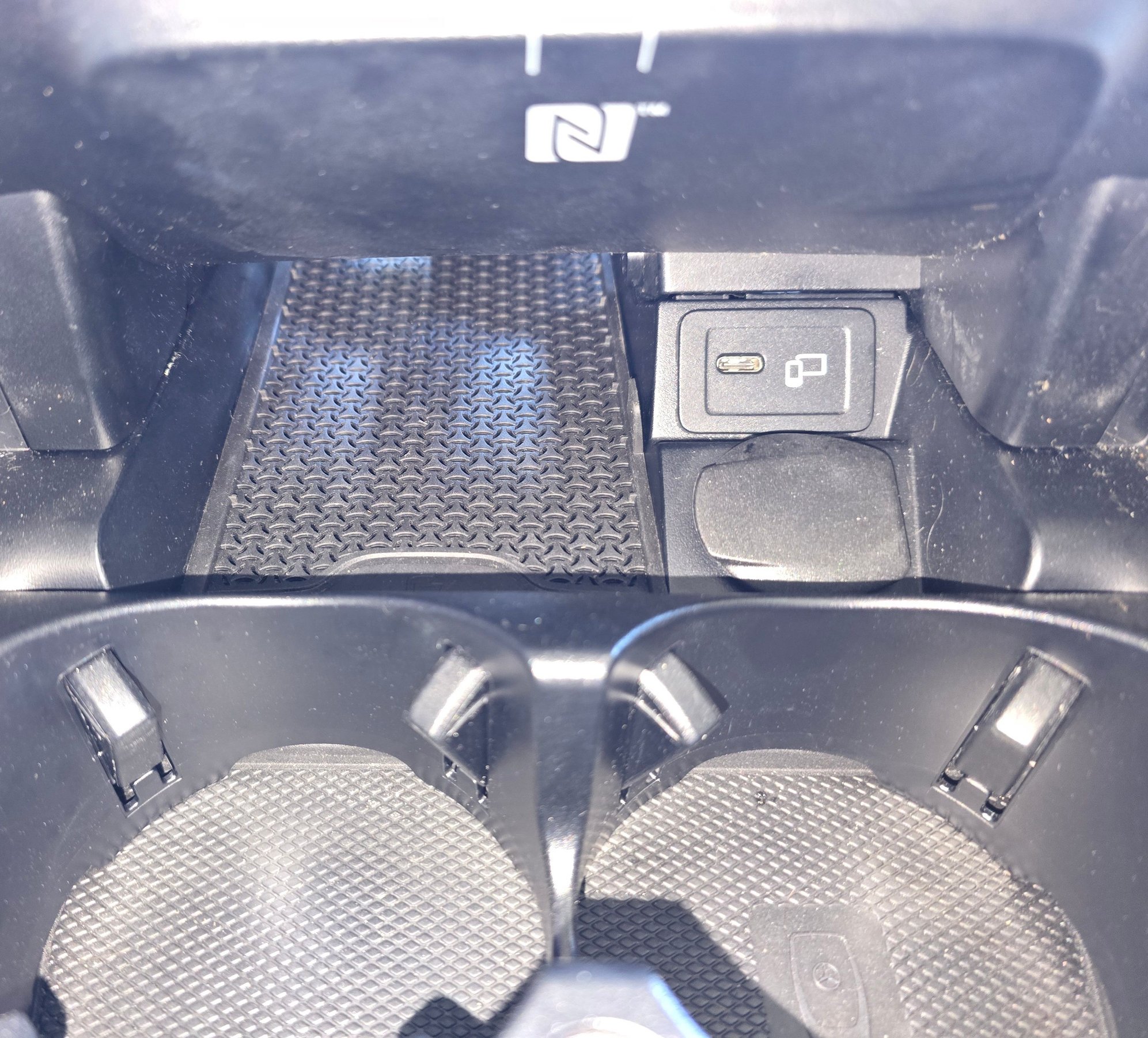

Yes! Here is the USB-C port instead of USB-A. Can be found on ebay
Old Jul 1, 2025 | 03:03 PM
PeterUbers's Avatar
Joined: Jun 2004
Posts: 13,799
Likes: 3,229

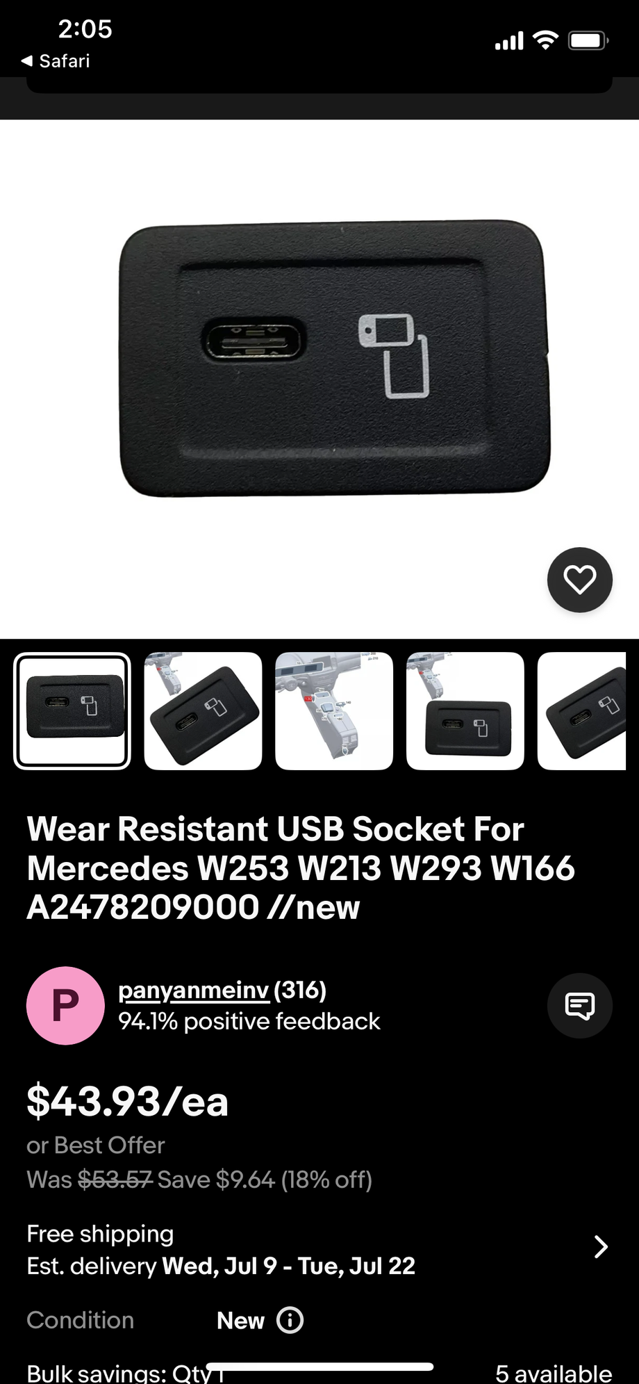

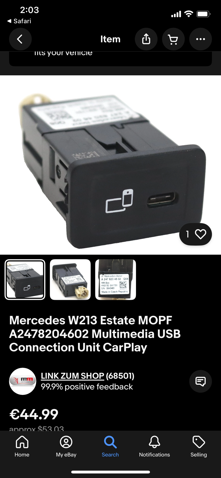

https://ebay.us/m/MftJjk
https://ebay.us/m/Rwu2jg

I've reached out nonetheless to the sellers on eBay to see what they'll claim ... more to come
Is it possible the head unit can deliver more than the usb-a requirements? Like a usb wall plug capable of multiple wattage depending on the device and plug used?

Can anyone confirm that they've successfully swapped the USB-A connector (2019 W213 Wagon) for a USB-C?
The rear connector looks like it's just power and data so I wouldn't be surprised if it's compatible and there is a USB controller inside the part.
It looks like there are both remanufactured ($34) and new MB parts.
