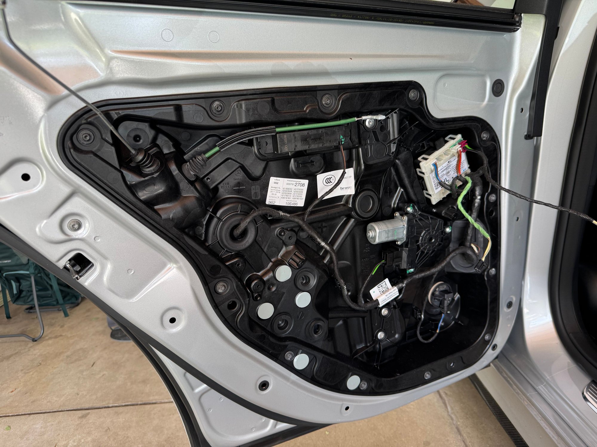

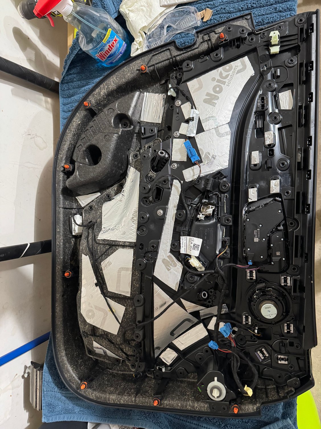

  3. (see pics below) removing, improving, and reinstalling the door panels (per this video:
    ), specifically:
    1. applying window weld to all the plastic clips, and anything that can jostle around
    2. applying sound deadening mat to any larger flat portions
These measures have certainly improved on the rattles, but far from eliminated them. I still hear several buzzes in the doors, and the dash and center console remain host to many vibrating components. I'm thinking of tackling those areas next, but given their relative complexity, figured I'd ask the forum for their solutions before diving in.

Door panel with sound deadening mat and window weld applied

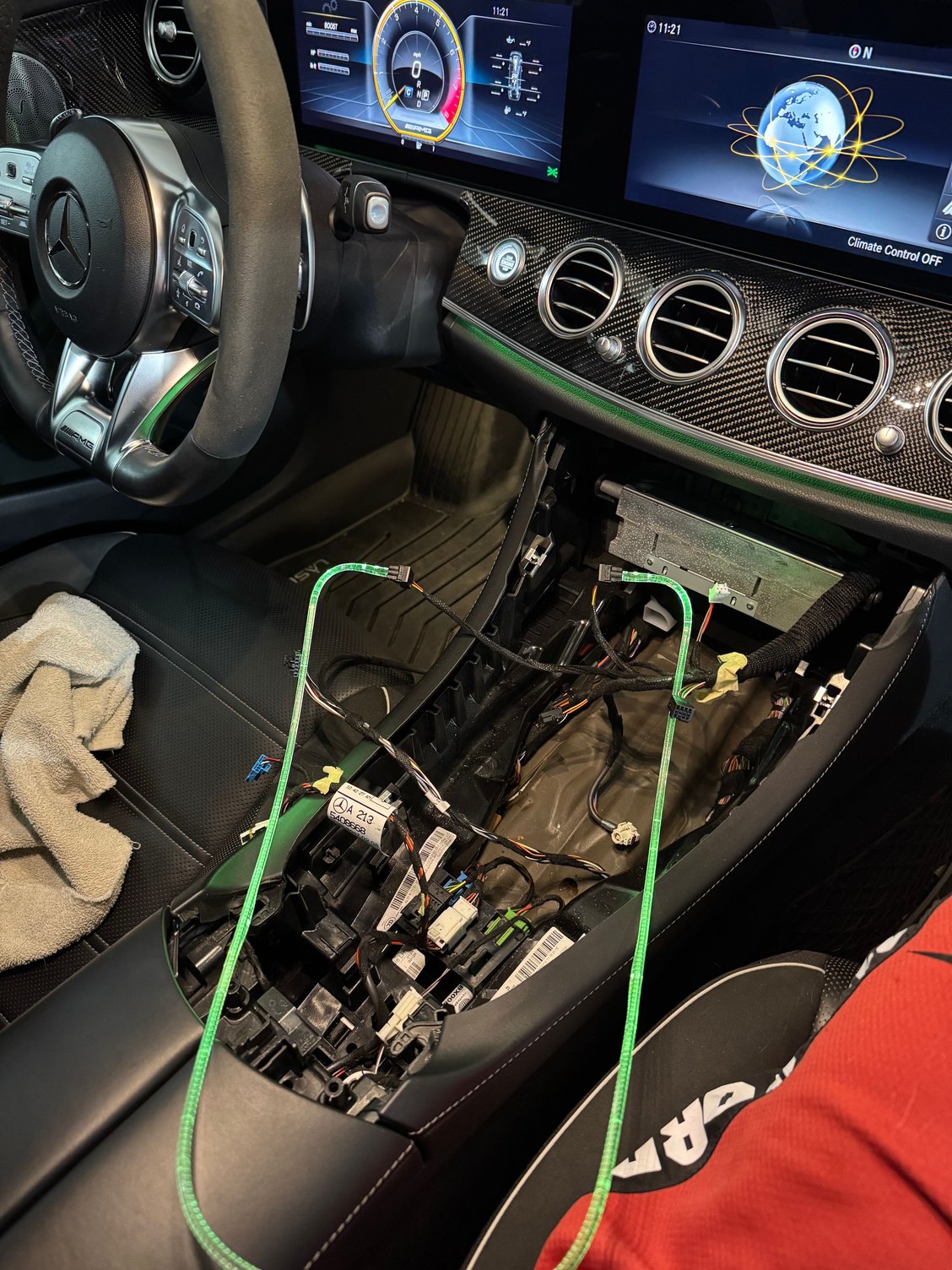

Couldnt find a way to unclip the wires from the ambient lighting. So I removed the ambient lighting. Easy enough to just pop out and back in.
Couldn't find a way to unclip the wires from the ambient lighting. So I removed the ambient lighting. Easy enough to just pop out and back in. Also discovered that a previous owner must have spilled a soda in the car, some drops of which ended up in here. Was glad to be able to clean that up.

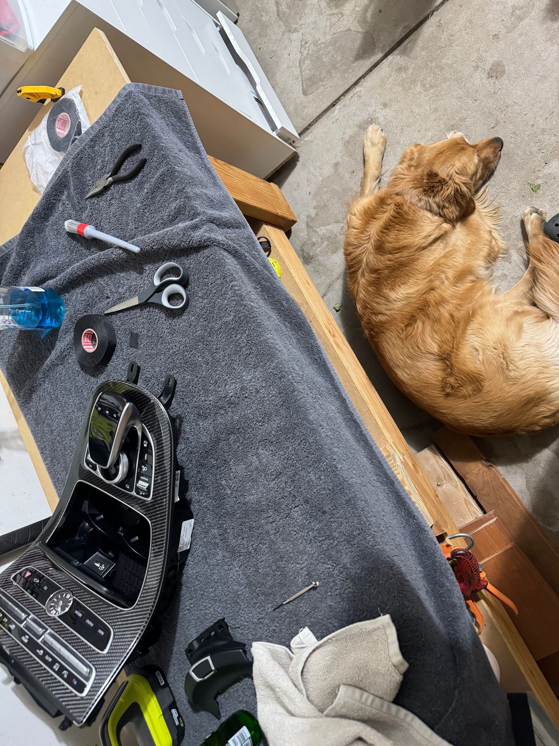

I put a layer of tesa tape between any two different plastic pieces that had even a remote possibility of coming in contact. The cupholders seemed to be a big source of noise. Even when clipped in, they sit pretty loose in their cavity. Lining every edge with tesa tape helped immensely.

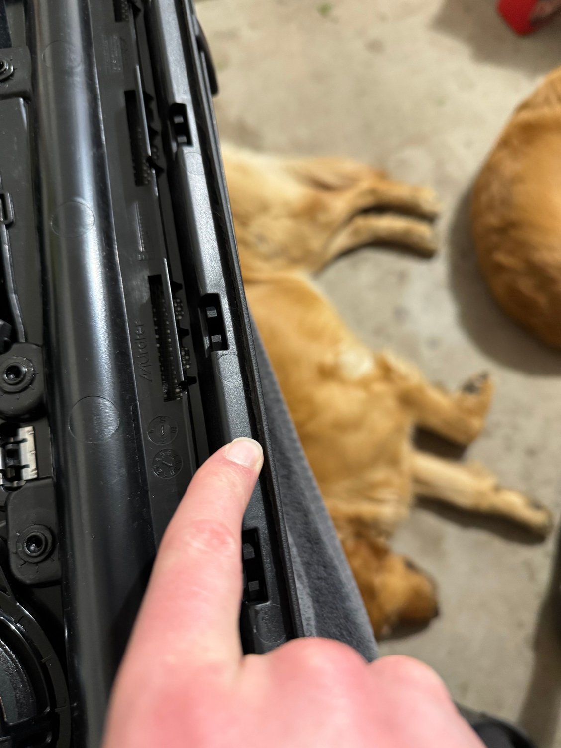

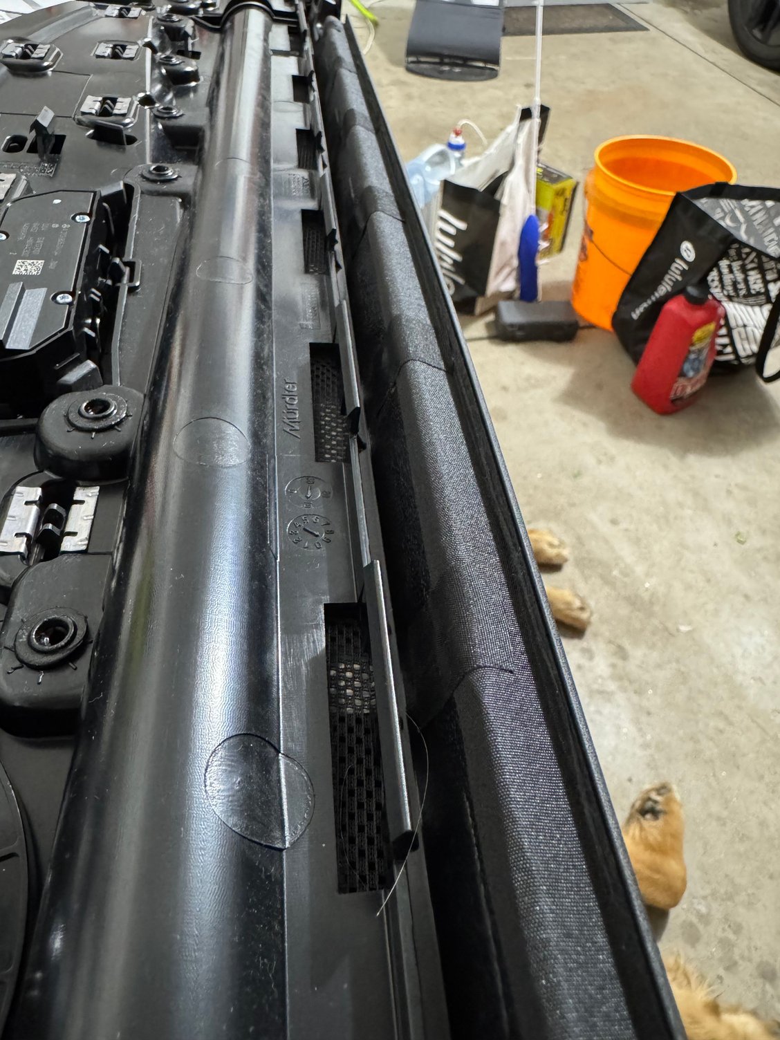

By far the biggest source of noise was this gap...
...and these clips. These are at the top of each door panel, and the rattles were especially bad from the rear. If it makes a difference, my car is equipped with peasant blockers for the rear windows.
I put window weld in each of the clips, really shoving it down in there, and layered tesa tape over the long gap. Used a pick to push the tape somewhat into the crease. Afterwards, no noise!
