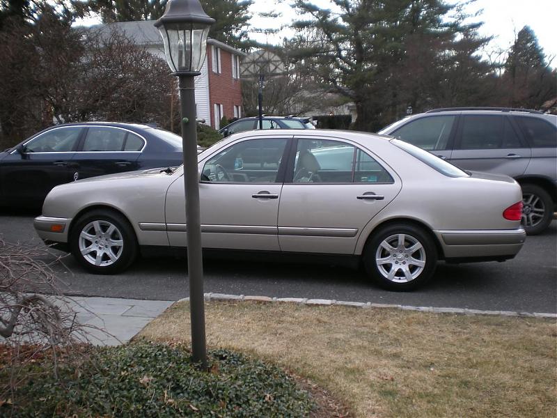

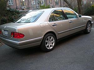

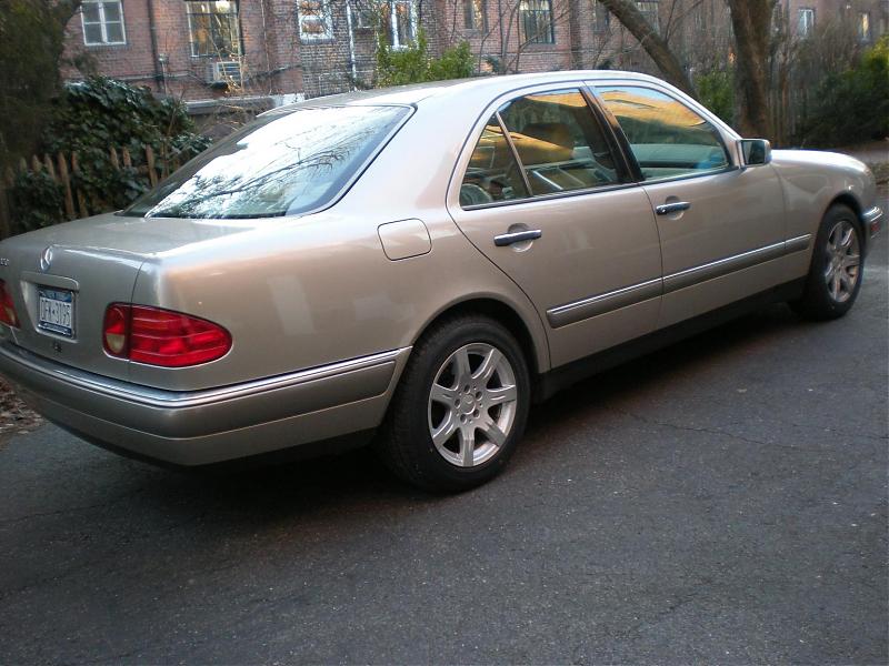

That's true...i had to go with custom bolts from RAD (R14)
I also went with 225/55...with no rubbing at all...the ride is a lot better
LUKE...thanks for the help
Attached Thumbnails What profile to use?-benz-pics-004.jpg   What profile to use?-benz-pics-017.jpg
