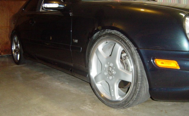

i had custom made bolts with bigger seats so it would fit better. as for the offset, its +44 front, +46 rear... i added in 8 or 10mm spacers and all is well...
ELENI, here was my baby's first pic w/ 19s right after installation (its like 1AM)
More pics to come on the W208 forum after I give it a good wash
When are you gonna get your wheels on?
As for tire sizes, I suggest either 225/40/18 & 255/35/18 .... OR .... go 235/40/18 & 265/35/18 if you want wider tires. Both WILL work... i had the later setup when I had 18s
