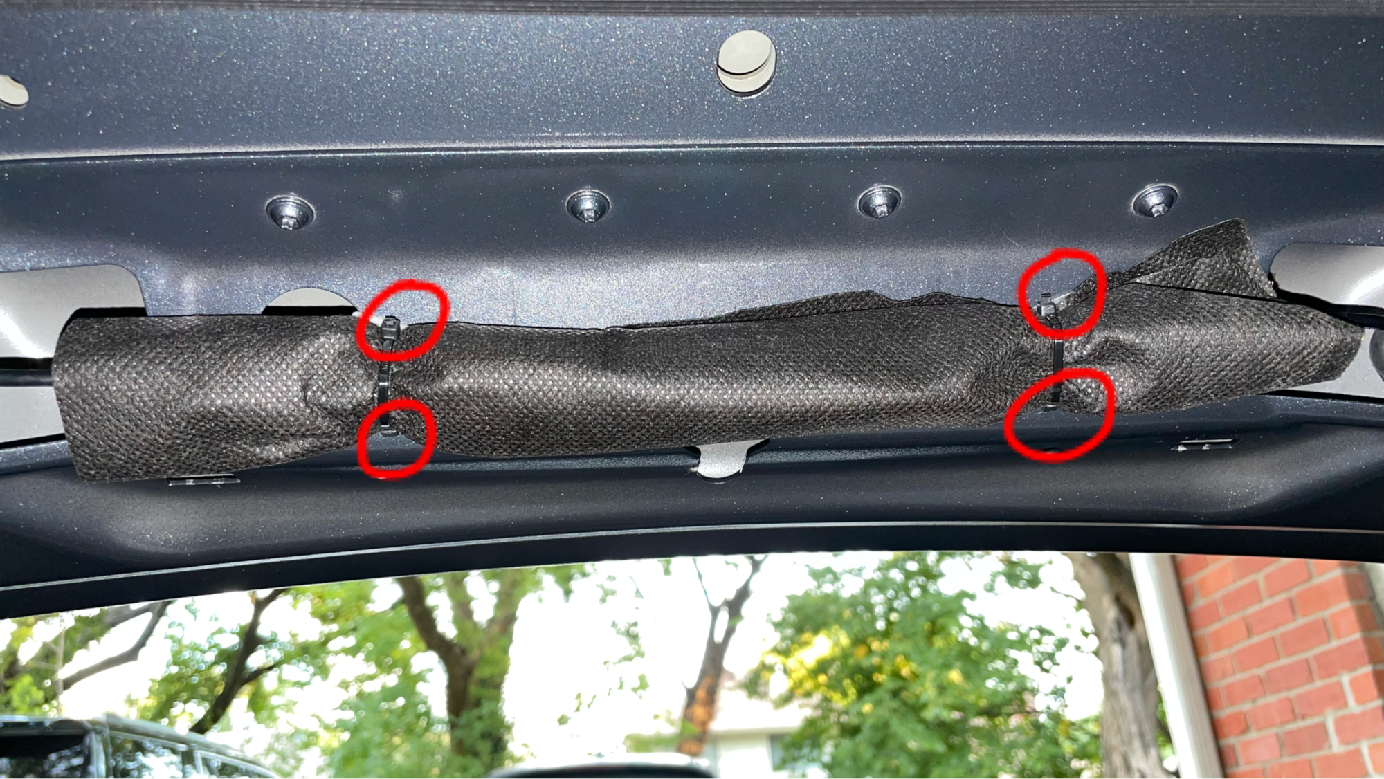

I then wrapped the wire with black cloth (landscaping cloth from garage) and then zip tied it to the tie downs making sure to leave the locking side of the zip ties towards the back of the wire bundle away from being able to touch and rattle on any metal or plastic
