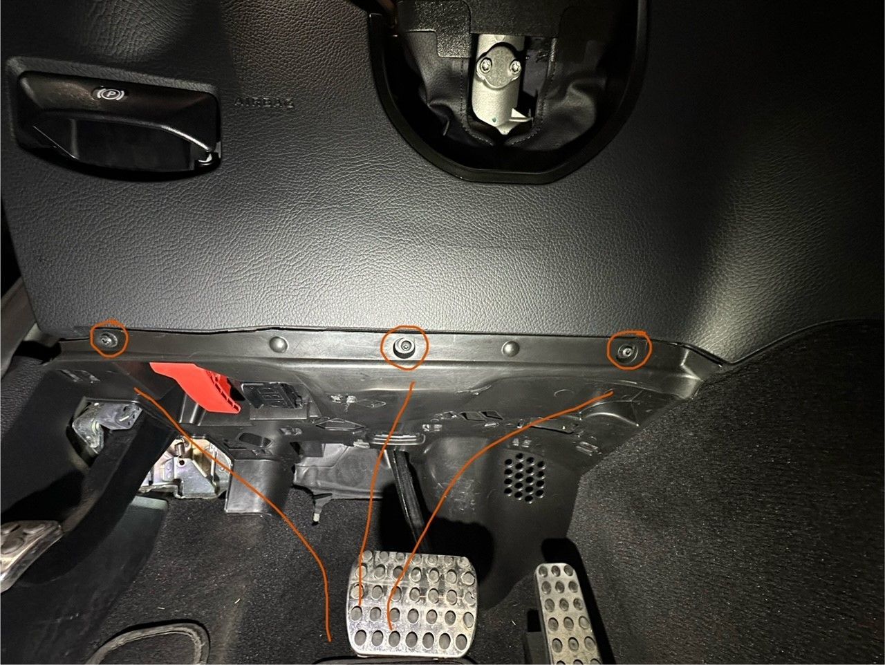

andreigbs February 8, 2024
Remove the 3 T15 to lower the plastic panel under the dash; makes is possible to reach up and under to maneuver the battery and tray.
